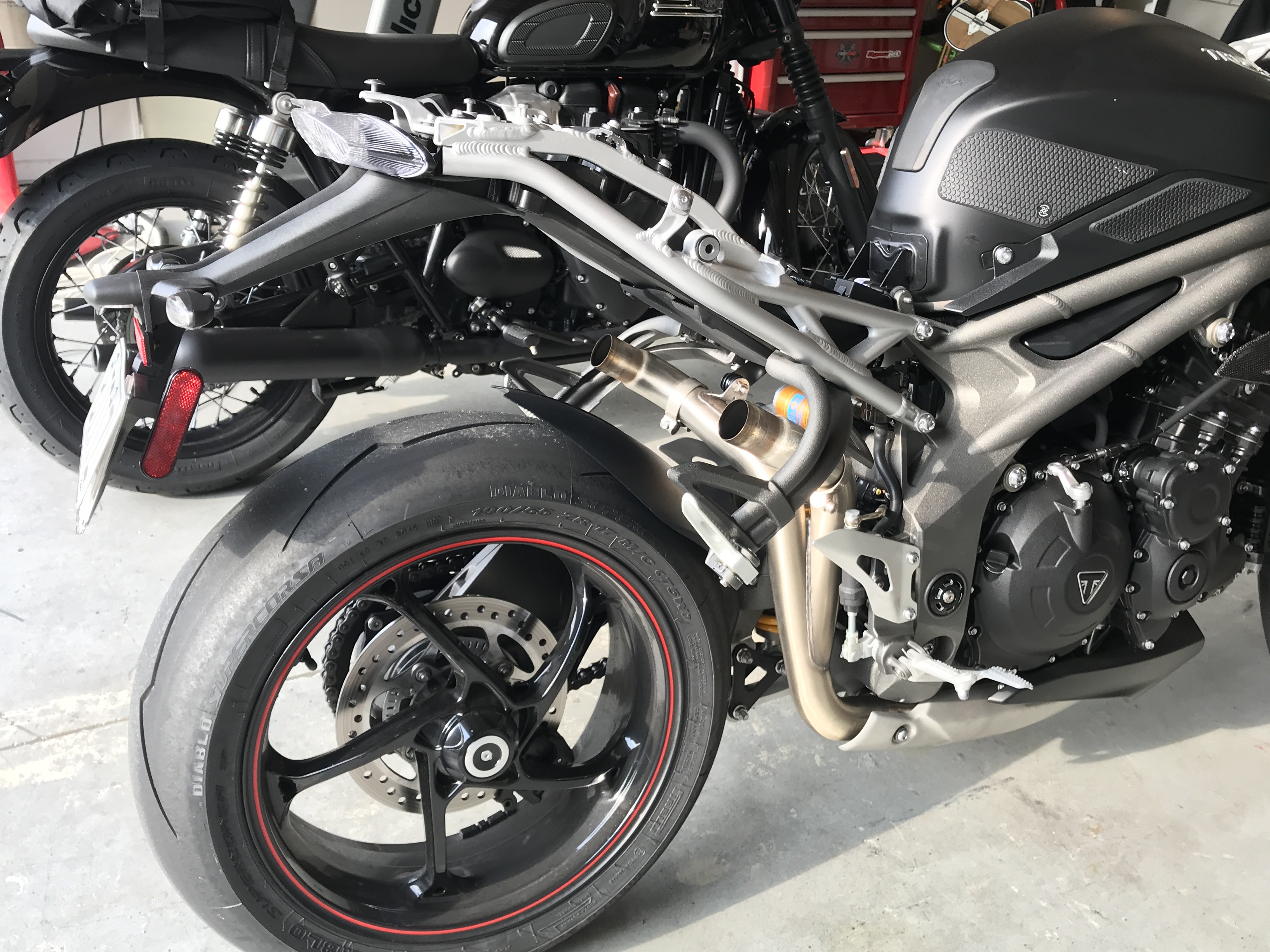

    What’s happening here then?

    I’m loving the motor, so much punch out of corners and the quick shift is really smooth too. Gearing is spot on for road use. Have set sag and softened up damping but still bouncing off the bumps, probably because I’m quite light at 71kg; will have a chat with an expert, maybe spring and/or revalve adjustment needed. That’s my only grumble really, otherwise it’s a blast! Especially on smooth roads...
