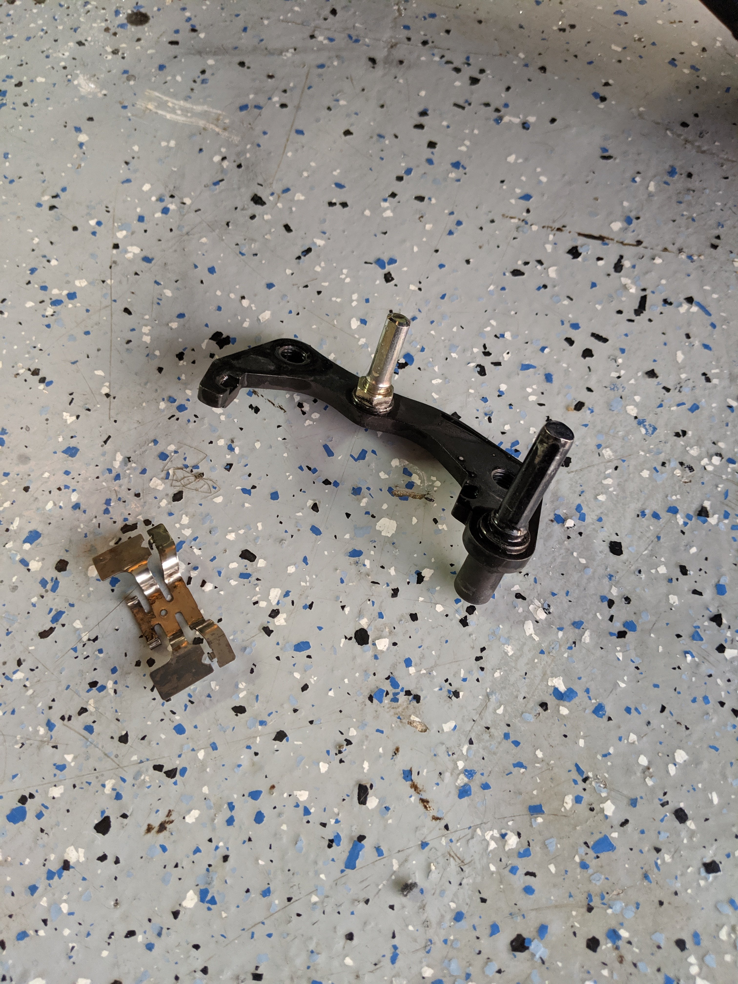

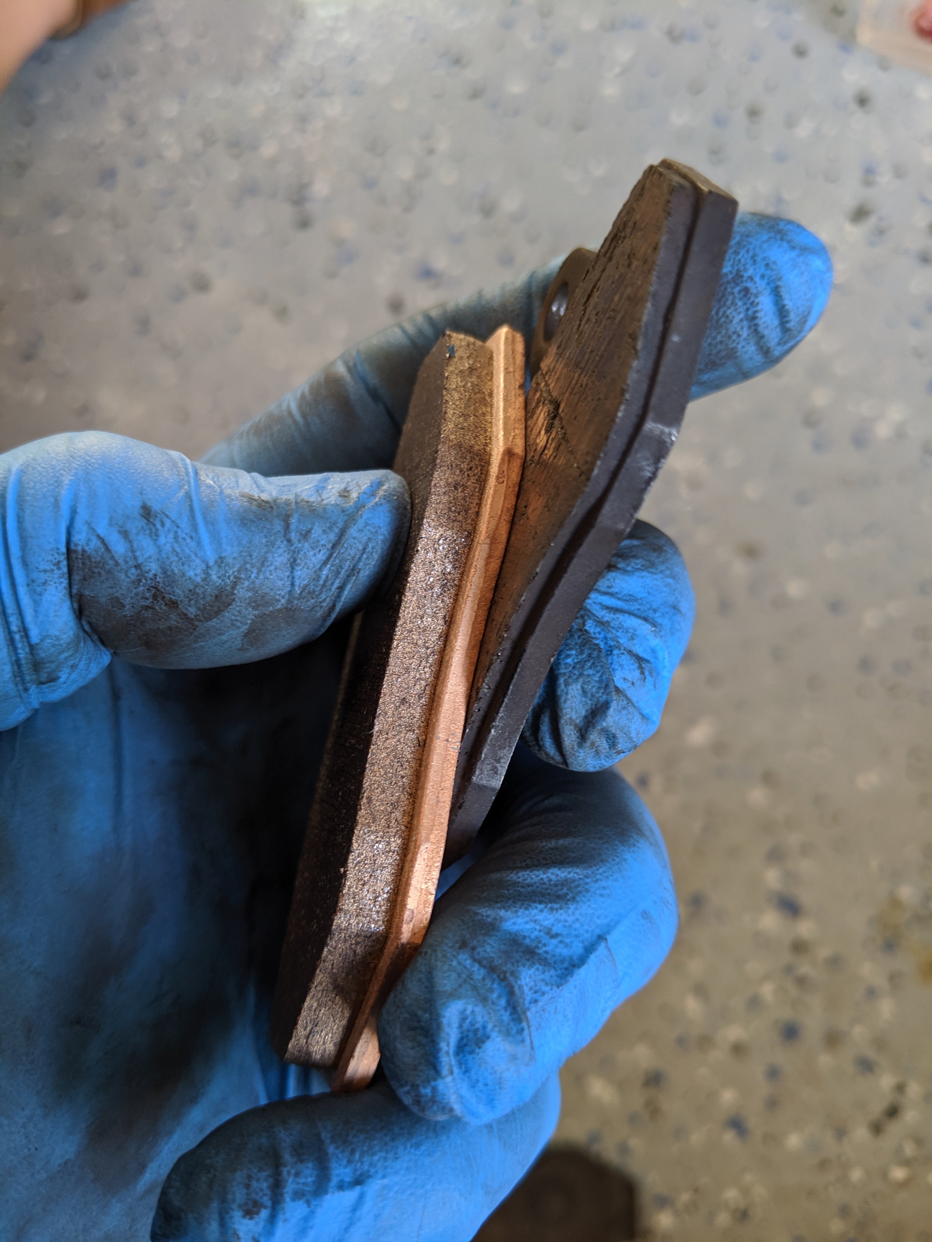

    I need help! I noticed that one of the two cylinders is not moving in and out when I step on the foot brake. Also one of them came out a bit too much. It actually came out and also some fluid behind it. It looks to me like I have a little bit of brake pad left, but I thought I needed brakes given I pressed on the foot pedal there was no stopping power. Take a look at some of these pictures. What do I do next my fellow trumpians.

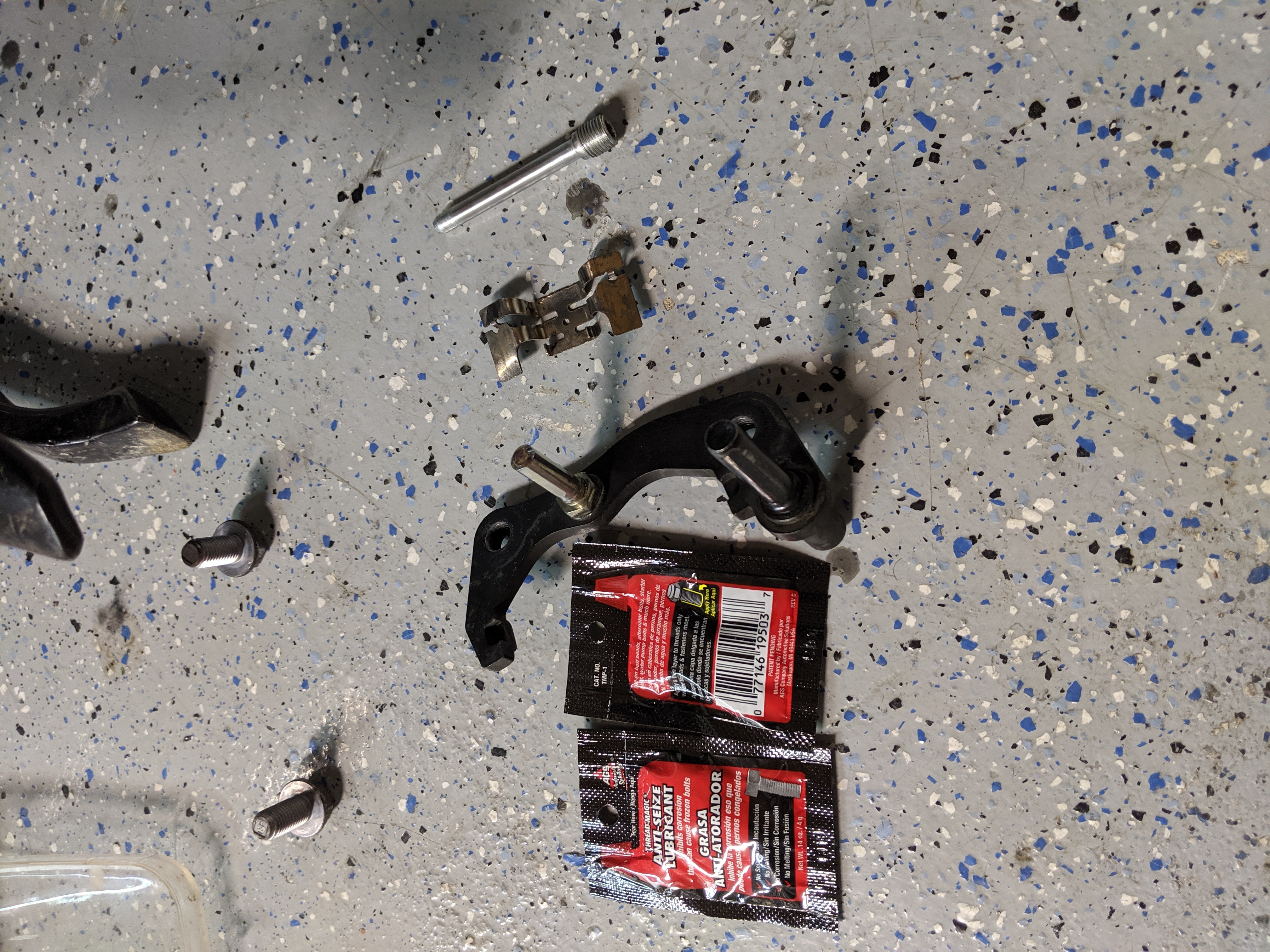

    I ended up taking the caliper apart and cleaning it as best I could. I polish the pins with sandpaper. This is the lubricant they gave me for the threads on the pins and the caliber parts that needed grease. Let me know if you guys think it's okay,and am I missing anything?

    Yes what you need to do now is there is a rubber o'ring inside the piston orifice rub that with fluid and a smear on the back of the piston just keep it even and pop it back in. It is quite hard to start and helps if you release the bleed nipple. It will pop back in then drive both back evenly. Job done careful not to damage the o'ring but I have never damaged in all the years I have been cleaning brakes and do replace those pads.

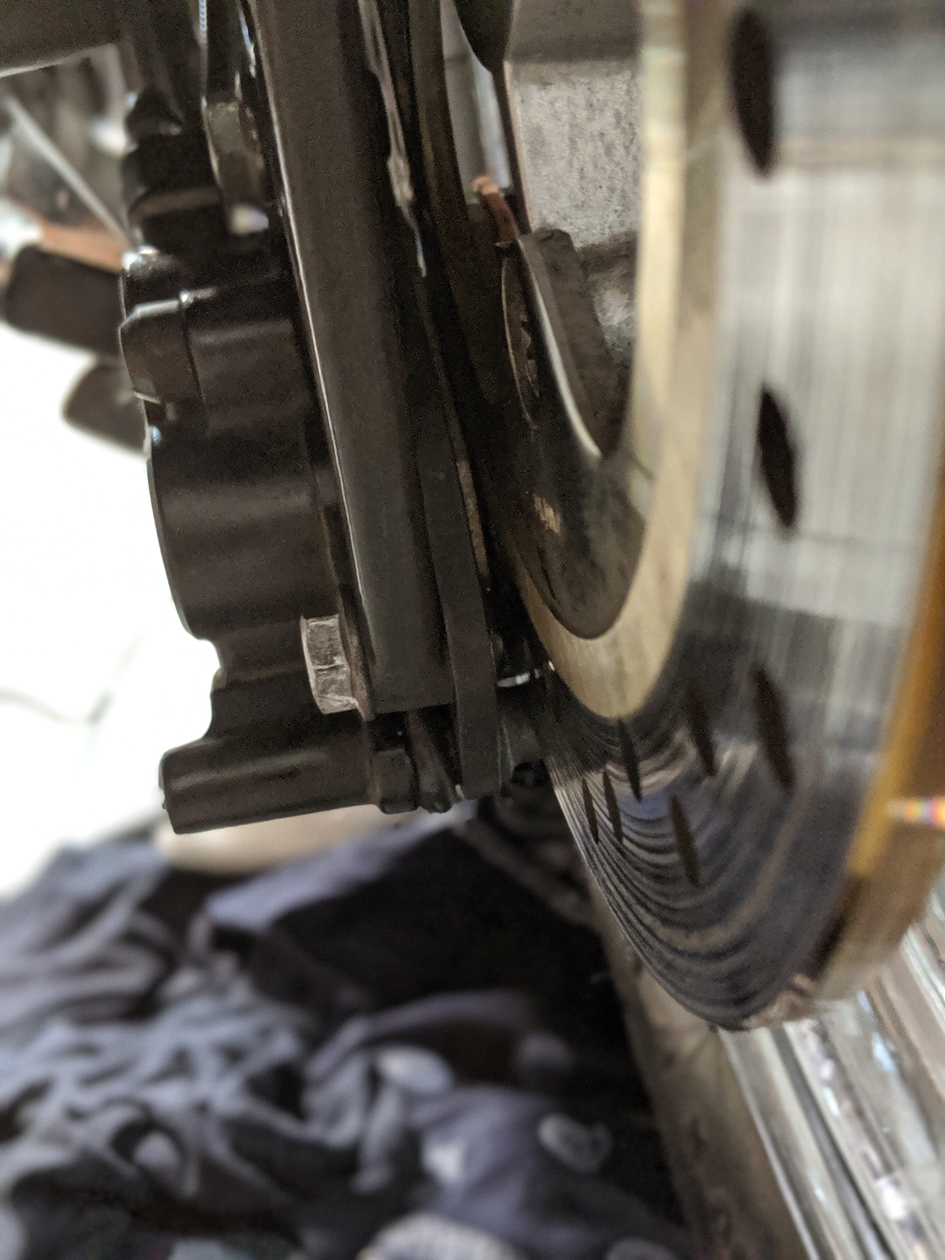

    This is what the brake pads look like installed. when I have it on neutral I can spin the tires but hear and feel a little bit of friction. The brake pads are making contact with the rotors. Is that how it supposed to be or should it be free of contact like a bicycle? If so how do I stop them from making contact?

    Don’t worry about the pads making slight contact with the disc as you rotate the wheel, that’s quite normal, what you need to avoid is if there is contact enough to cause the brake to bind as this is a a dangerous situation that can lead to the wheel locking up as things get hot and expand, jamming the brake on, but you got things all cleaned up and lubricated so it should be fine.
