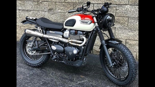

    I ave looked into it and t120 will fit straight in. Forget getting from Triumph for over 600£, thats mental. I have seen one on ebay for 350£ ish and a few damaged ones from EU for around 170£ ish that would have a minor ding and some scratches.

    This is what a Street Scrambler looks like with a tank from the new T120, I'm being told it is a straight fit/swap.
