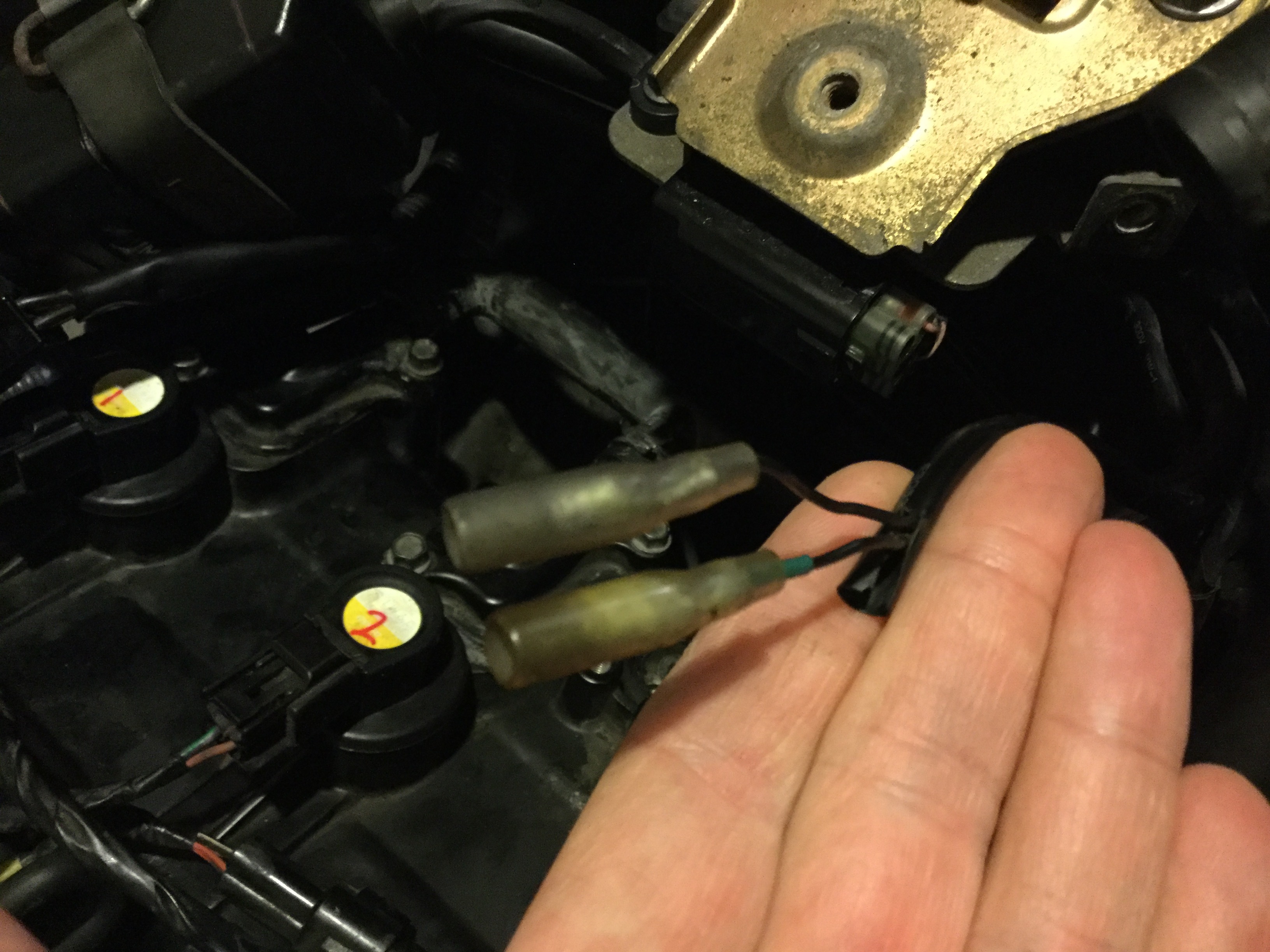

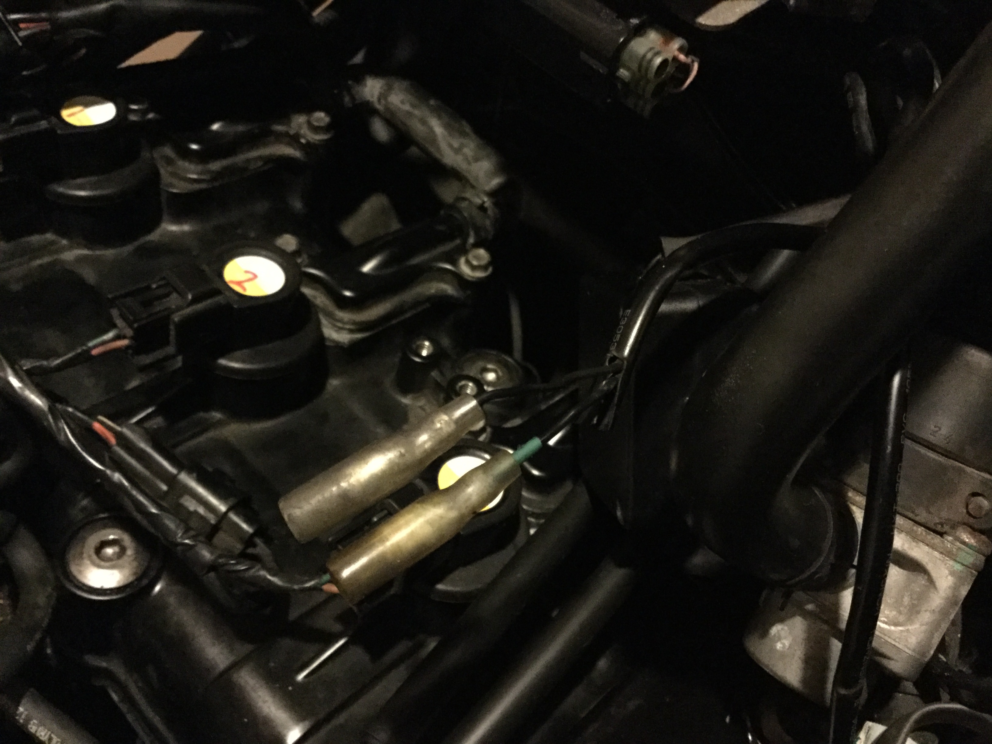

    Recently dome a big service on the GT, including cam, and tensioner and clutch. Added a few mods, including a front mounted camera. Wanted to find an ignition on live to attach to, but now just going to put it on the accessories socket with a switch. However, i came across these two wire, and wondered what they are for..... any enlightenment would be greatfully received....
    If anyone has suggestions about where to find a powersource near the front, that is only live when ignition is on, then I am all ears!

    Piggy back off the live terminal on your horn and then pick a suitable earth point for the earth wire.
