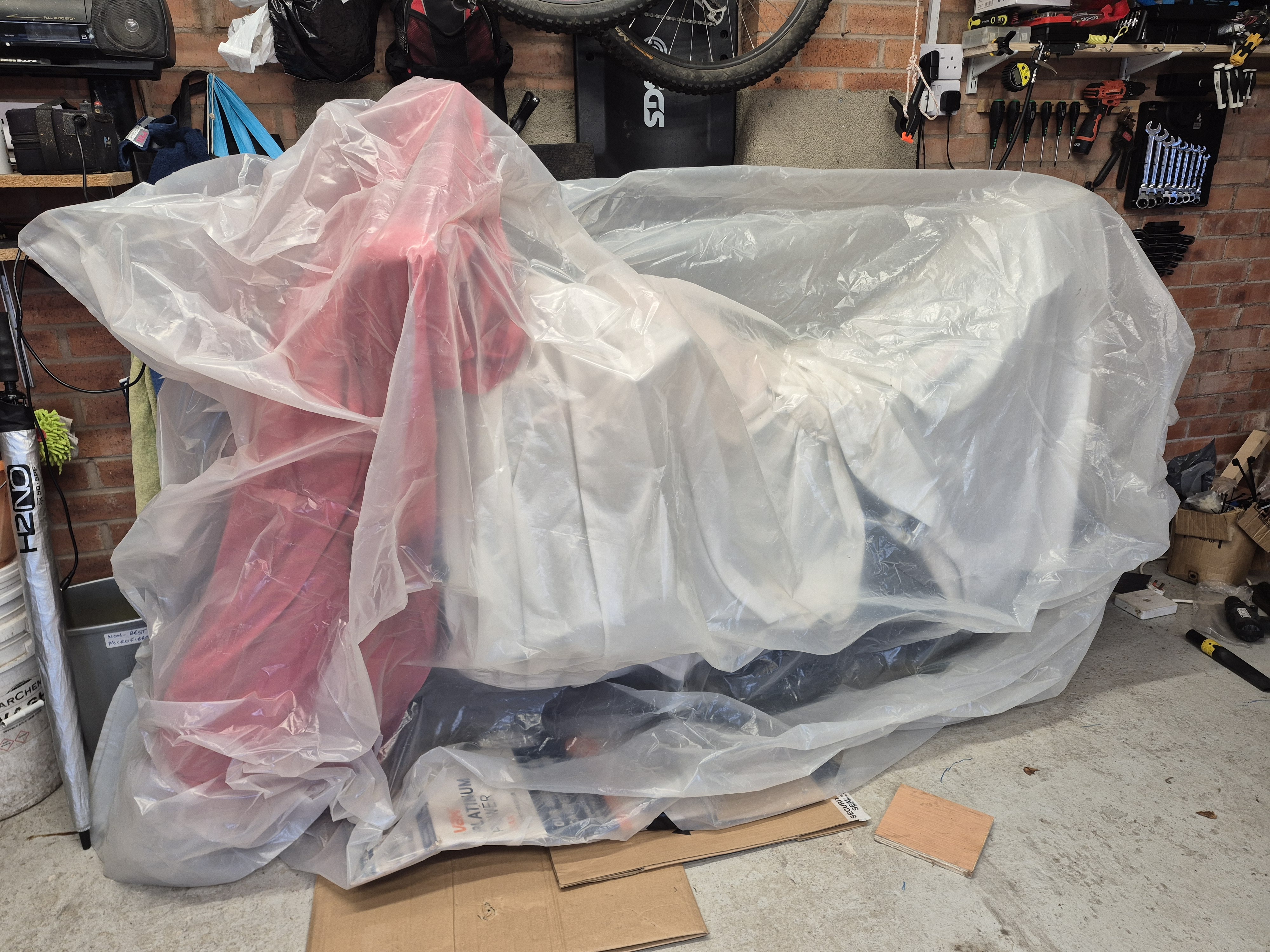

    I've just put my bike away for the winter.
    I drained the tank and put the petrol in my car, come spring I'll just get some fresh fuel and put it in. Fuel stabiliser here in the UK is not far off the cost of a tank of fuel so seems a waste of money unless you have no other option. If you are going to leave fuel in it the handbook for my bike says to fill the tank to the brim before laying up.
    As has been said previous if you're just covering the bike use cotton sheets which allows the bike to breath, rather than trap any condensation.
    I spray my bike with a rust inhibitor after making sure it's clean. Because I don't ride in winter I use a product called FS365, which is an emulsified oil. You simply spray in on using the spray bottle it comes in, the water suspension evaporates off, leaving a thin coat of oil behind to protect the bike. Others use stuff like ACF50 or XCP but I prefer FS365 as it comes off with just a normal wash in the spring.
    Here in the UK we get very varied weather through the winter almost on a daily basis ranging from below zero temperatures when there's a high pressure, through low pressure systems off the Atlantic giving us snow which normally only lasts a few days at most or relatively mild spells with rain when the air has a lot of moisture depending on the temperature. This means the bike will often get wet from condensation as the weather changes when warmer moist air comes into contact with a cold bike, so I put my bike in a sealed vac bag with a small 12v dehumidifier inside running off a timer to keep the bike dry no matter what the weather is doing.
    For the battery I use a proper motorcycle battery tender which monitors the battery and tops it up as necessary and leave it plugged in all the time. Mine's an Optimate 4 and I have a SAE fused lead connected direct to the battery that came with it. The leads for both the Optimate and dehumidifier just feed through the open end of the vac bag, which I then seal up using a budgie chord. She'll stay here until spring.

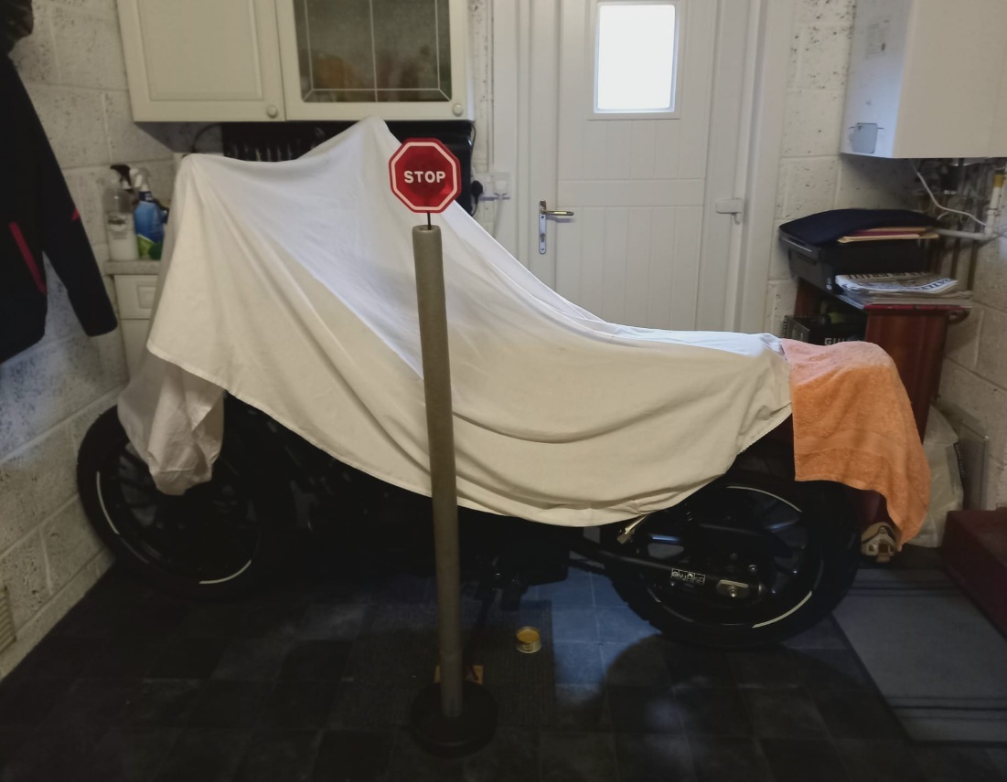

    ajc400 Senior Member
    Jun 4, 2024
    1,024
    Glasgow
    Same here, so I don't go mad with covering the bike and not totally covering it lets the air circulate. In fact, the sheet is probably more for keeping the dust off!
    This works for me - door to kitchen is on the right, and yes, the stop sign is to help park the car! It's probably the only garage in the area actually used for a car!! :grinning:
