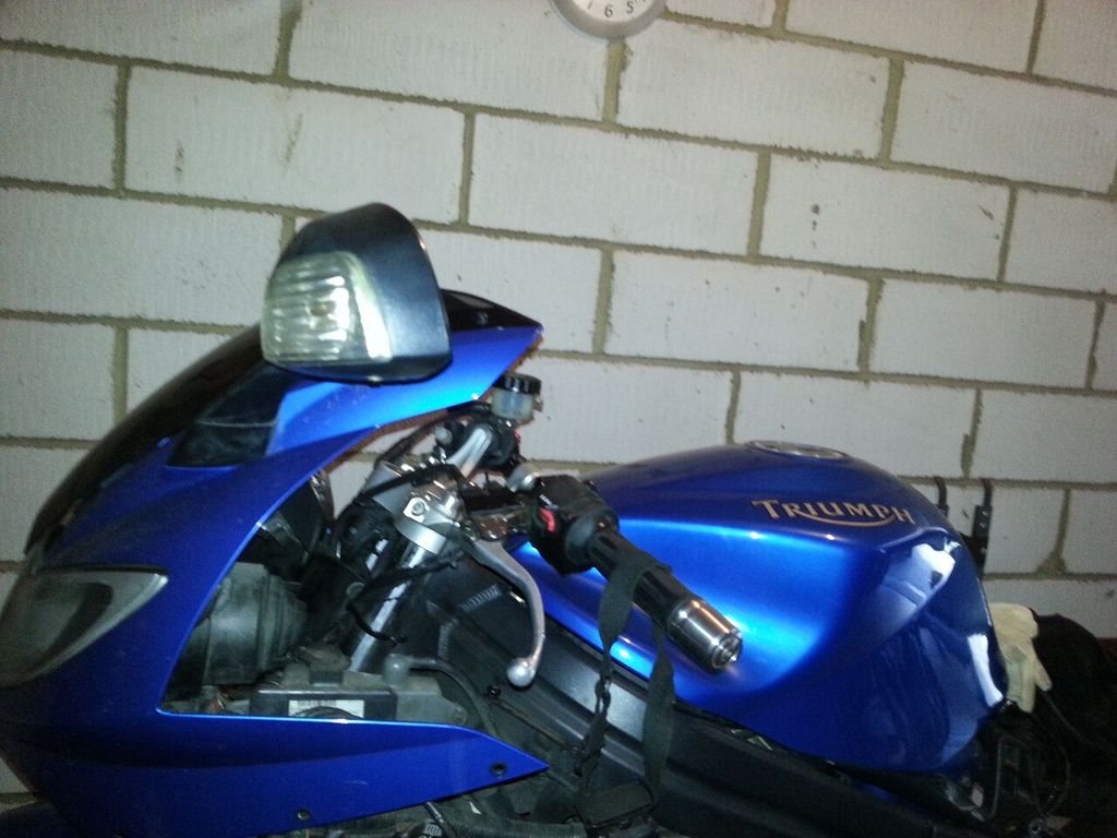

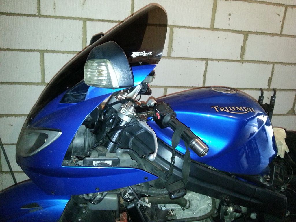

  8. trudd
    trudd Member
    Oct 13, 2014
    42
    These are 3 different screens on my 2005 1050ST.
    Standard
    Double Bubble
    Zero Gravity Sport Touring
