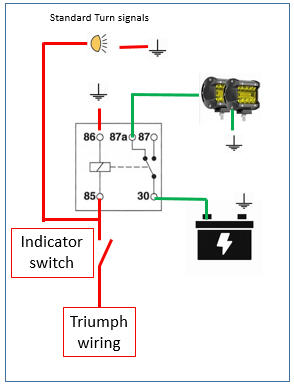

    Hi. I want to fit sone auxiliary lights that work as additional indicators. I gather on a Trimuph Tiger 1200 (2022 model) with CanBus that I can't just tap off the indicator circuit as the CanBus will get upset (technical term). But will the CanBus accept if I simply put a relay just before the original indicator bulb?

    I don't see what the canbus has to do with powering an indicator, but I suppose it's feasible that the switching circuit for the indicator monitors the current to detect faults and that additional lighting load might make it think there's a fault. Wouldn't have thought so though. (Edit: you would obviously not want to overload the switching capability of the ECU which is driving the indicators, not sure what that would be, but you've got to assume it'll cope with an extra LED auxiliary light of similar power to existing indicators).
    With regard to your proposed solution with the relay...
    That diagram looks like you're putting the relay's coil in series with the indicator bulb, that's not going to work, you want it in parallel. I.e. one end of the relay coil connected to the side of the existing indicator that gets the intermittent 12V volts to make it blink, the other side of the coil connected to ground (possibly using the ground wire to the indicator if that's convenient).
    Also, if it were me, I'd also connect a diode across the relay coil to protect to ECU against back EMF. It may have inbuilt protection, but it also may not as it's not expecting to switch an inductive load. That diode must be the correct way around, otherwise it's just act as a short circuit.

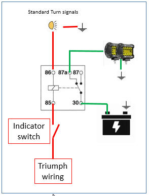

  7. Nick Daniels
    Nick Daniels New Member
    Dec 4, 2022
    Thanks. So you are suggesting I do this
    instead of this
    and where does the diode go?
    Cheers - much appreciate your advice BTW

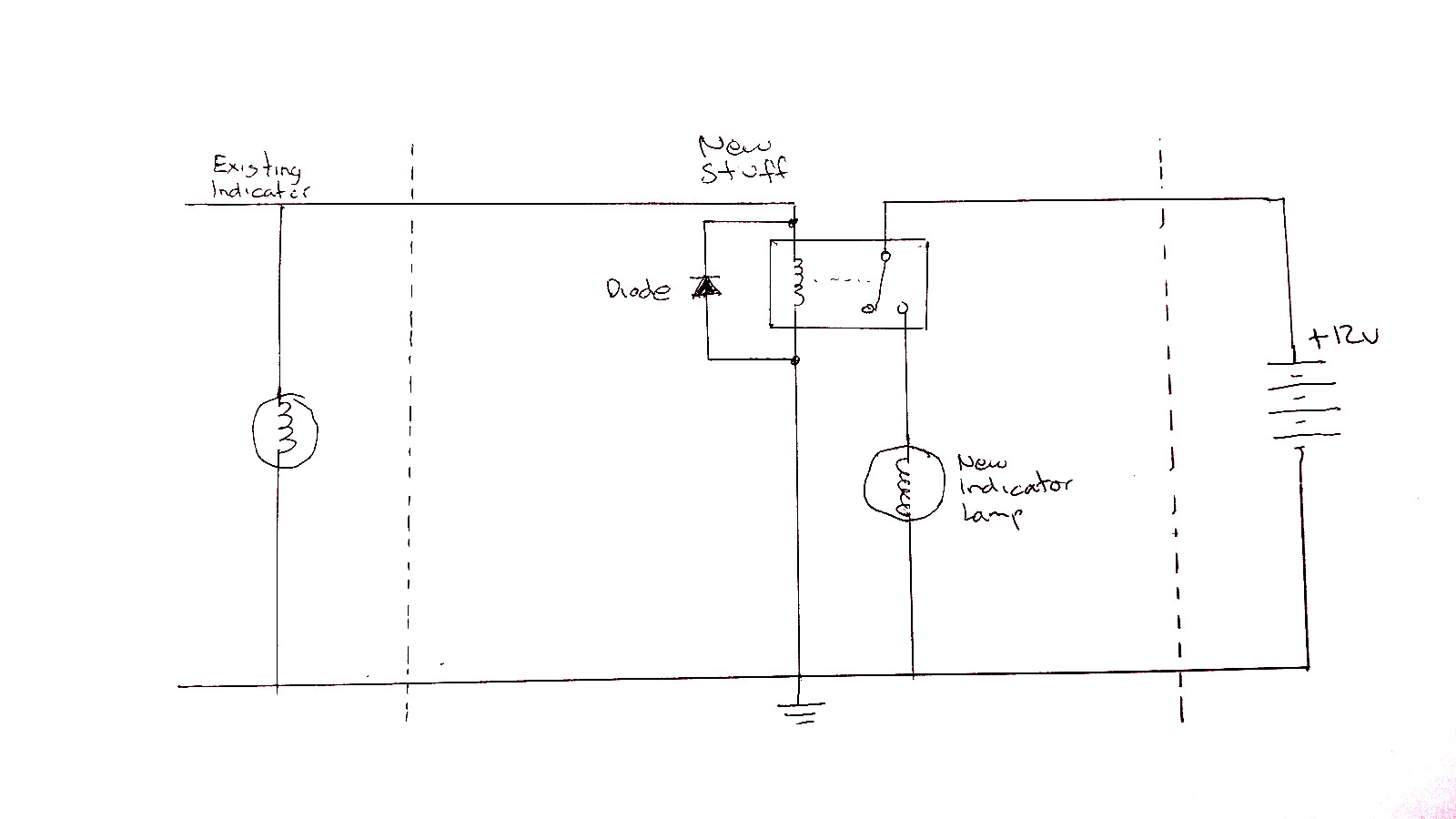

    Yes, that's it. Diode connects across the relay coil in the direction that it wouldn't normally conduct electricity, i.e. pointing away from earth. Here's my attempt at drawing it... circuit.jpg
    Note, diodes are pretty much universally marked at one end with a band to mark the end that is at the top in the picture above.

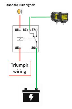

  9. Nick Daniels
    Dec 4, 2022

    Halfords do a relay with the Diode built in, it is just a couple of quid extra. The Diode is there to help protect your bikes electronics by prevent spikes being introduced when the relay is dropped out.
