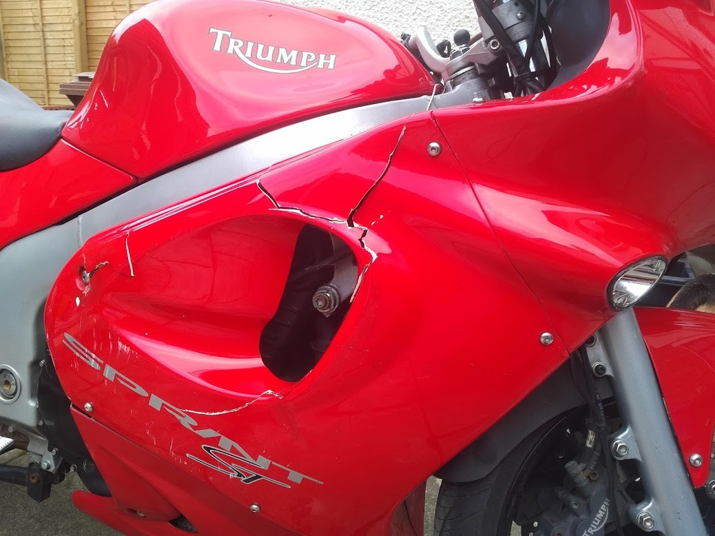

    I've had my 2000 Sprint ST 955i for a few years now and still loving the bike.
    Sadly in the recent storm, the cover decided to act like a sail and pulled the bike over while I was out o_O
    The side fairing is badly cracked, and also the soft Aluminium bar on the right (brake side) is bent at the yoke end - looking at replacements and wondering if there are other bars such as the 1050 ones that might give a little more height, and fit without much adaption?
    My bike has risers fitted which I'm not totally happy with, as the bars don't have a solid mount onto the yokes. But I'm a short ass who needs the risers..... :joy:
