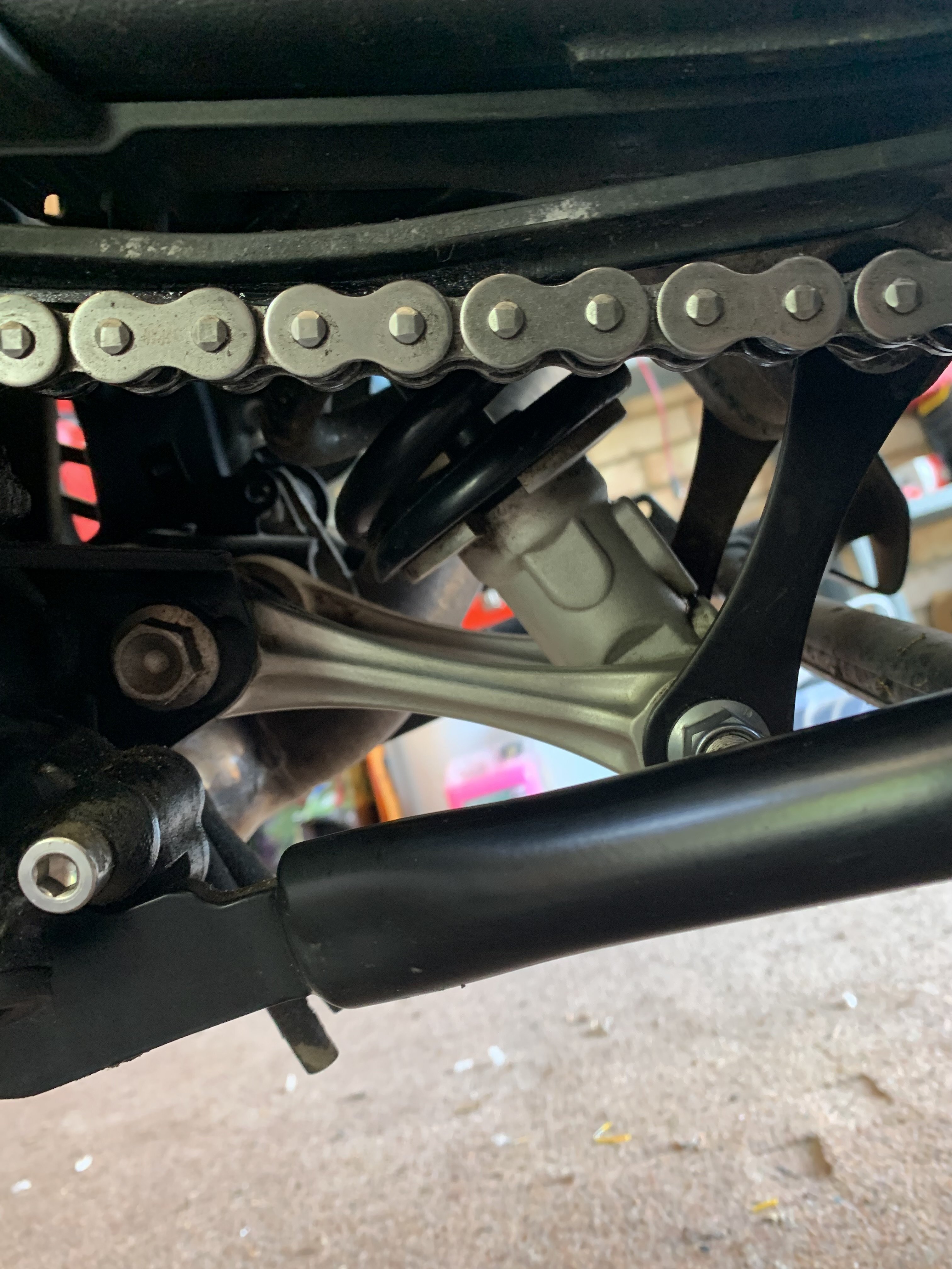

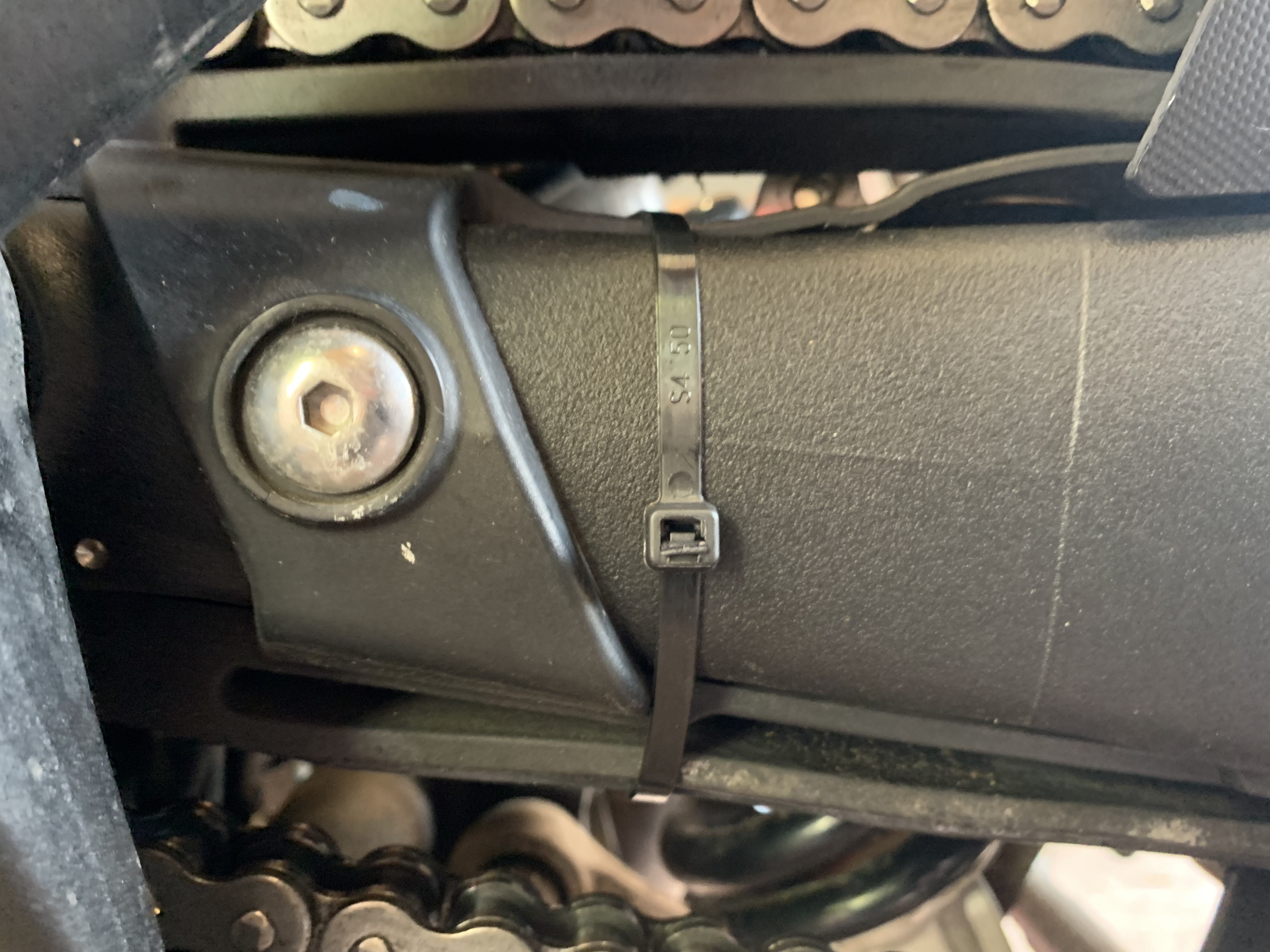

    Well.. it doesn’t look broken but it does have a strange kink in it. I noticed that when checking the chain tension, the chain was hitting this lower skid part.
    So, cable tied it up to the swing arm and took the bike out for an afternoon test ride (;<)), and it was a lot quieter than I have ever heard it! Not as quiet as I would like, but close. However, the opposing skid on top of the swing arm is pushing up by design, forcing the chain to permanently run over it. If the whole thing has worn out, maybe replacing it is the answer, but I am unsure, and even though the part is only £41.48 (less than I had imagined!) I don’t know if that will cure the noise. I may remove the part completely, and secure some thick plastic strip top and bottom of the swing arm, just as an inexpensive way of testing the theory.

    It seems to me that the rubbing strip on your bike is designed to make contact with the chain so this is bound to create some noise. Is it quieter after lubing the chain? The rubbing strip looks ok and should not need replacing at that mileage.

    The photos show that's how the strip is designed and zip tying up to the swingarm is just deforming it. The bottom run of the chain will have very light or even no contact with the strip under power so if the whine doesn't change between on/off power it's unlikely to be the cause IMO.
