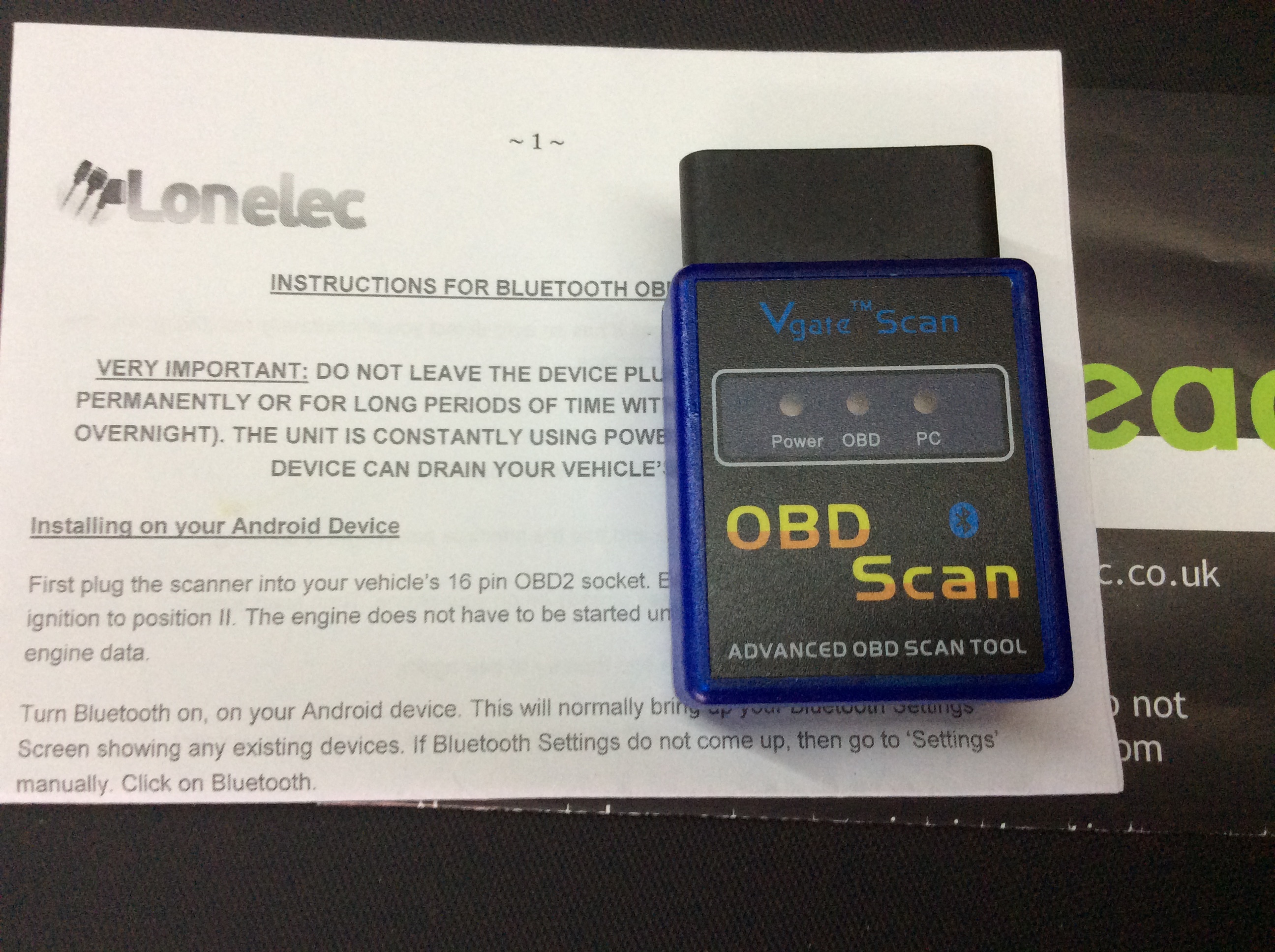

  3. Yorkshireman
    3,404
    This is the dongle I use, it’s from www.lonelec.co.uk
    If you go the laptop route their cables are supposed to be the best as well.
