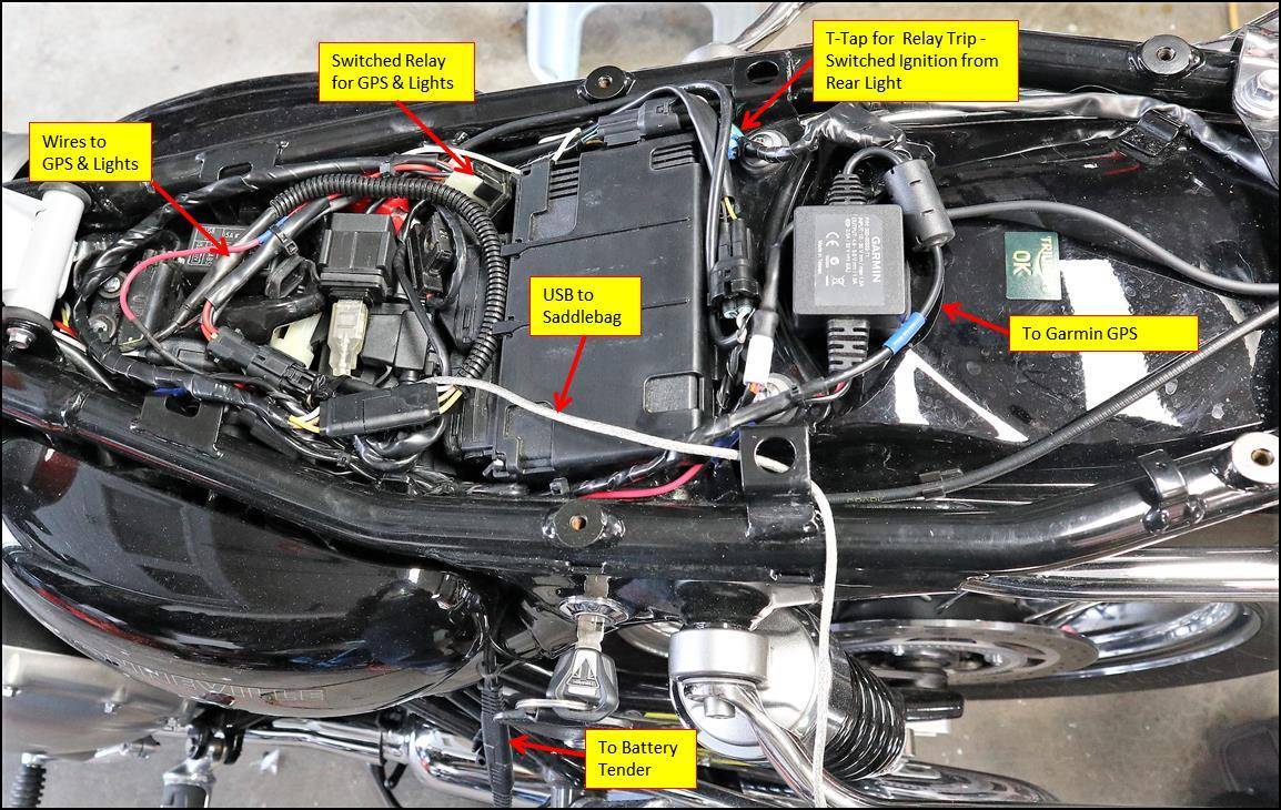

    T120 - Here's my rats nest - I should/could have cut short a few more wires etc.! There's not a lot of space at the front of the bike so squeezed everything under the seat. The Garmin and Denali's have lots of wires that take up space.
    I wired a switched live from the rear light to a relay so the (recycled) Denali Lights and Garmin GPS could be powered on with the ignition. On other bikes I've done similar but used a "FuzeBox" - but, as we know - not a lot of space!
    USB cable is a braided type - abrasion resistant? - has multiple "ends" for charging phones, tablet, guitar amp, etc.... For simple GPS power I suppose the USB Socket could be used?

    Hi Steve, sure is a rats nest with very little room under the seat. At the moment I only have the Garmin 660 connected to the rear light.

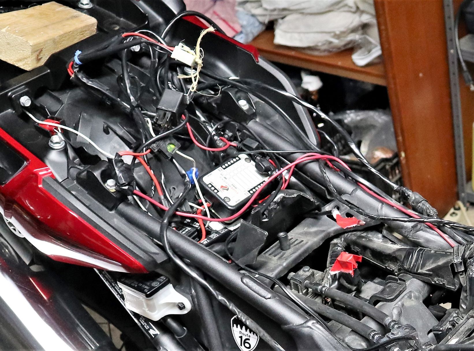

    Here's a pic of the "Fuzebox" I used on my Africa Twin which had lots of farkles wired up. This time I did tidy up the wires - see the "rats nest" tied up with string - I got rid of most of it but can't find a pic of the "Tidy Wires". Again, the objective was to pull most wires to the back of the bike and then sort it out!
    The "Fuzebox" is powered directly and can have switched or non-switched power for each circuit .
    Question: The Garmin comes with a voltage regulator to provide 5V DC (IIRC?) - Would you connect the Garmin directly to 12-13V DC ???
