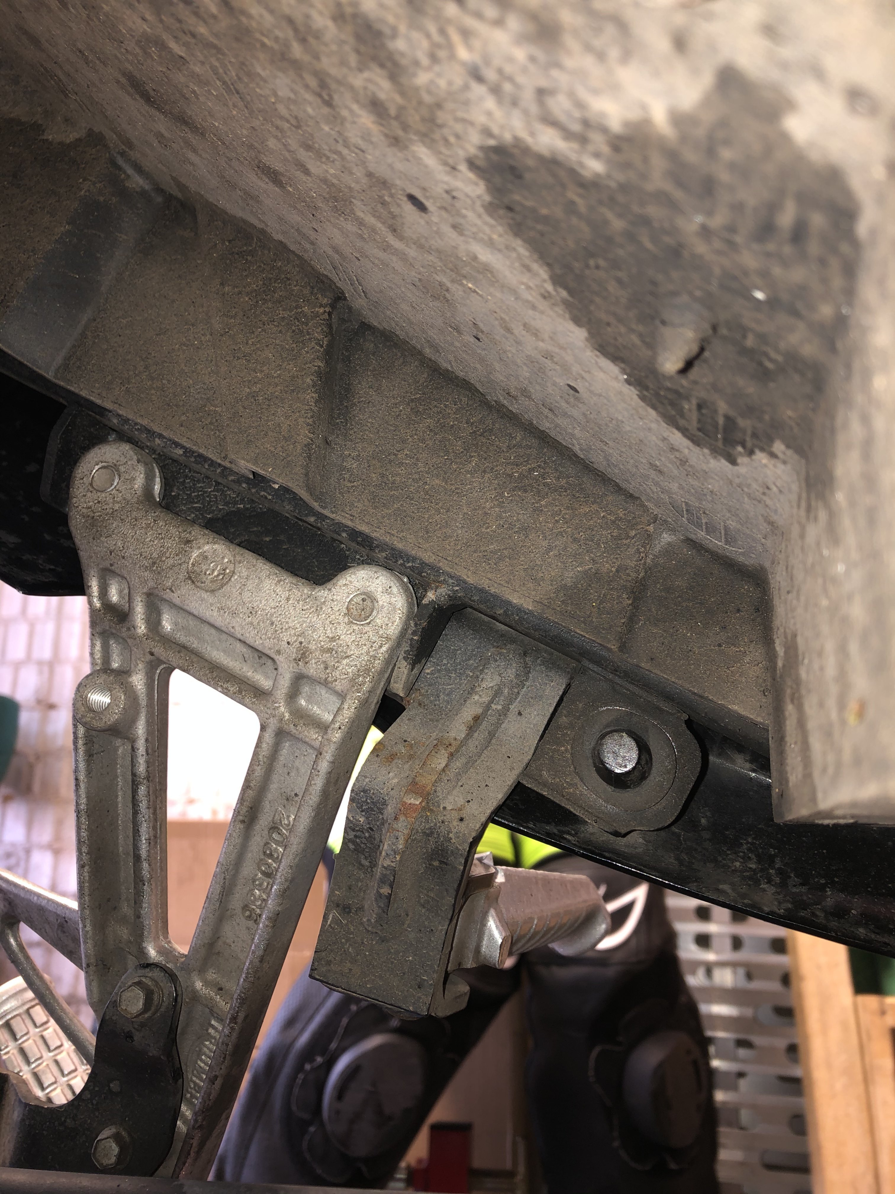

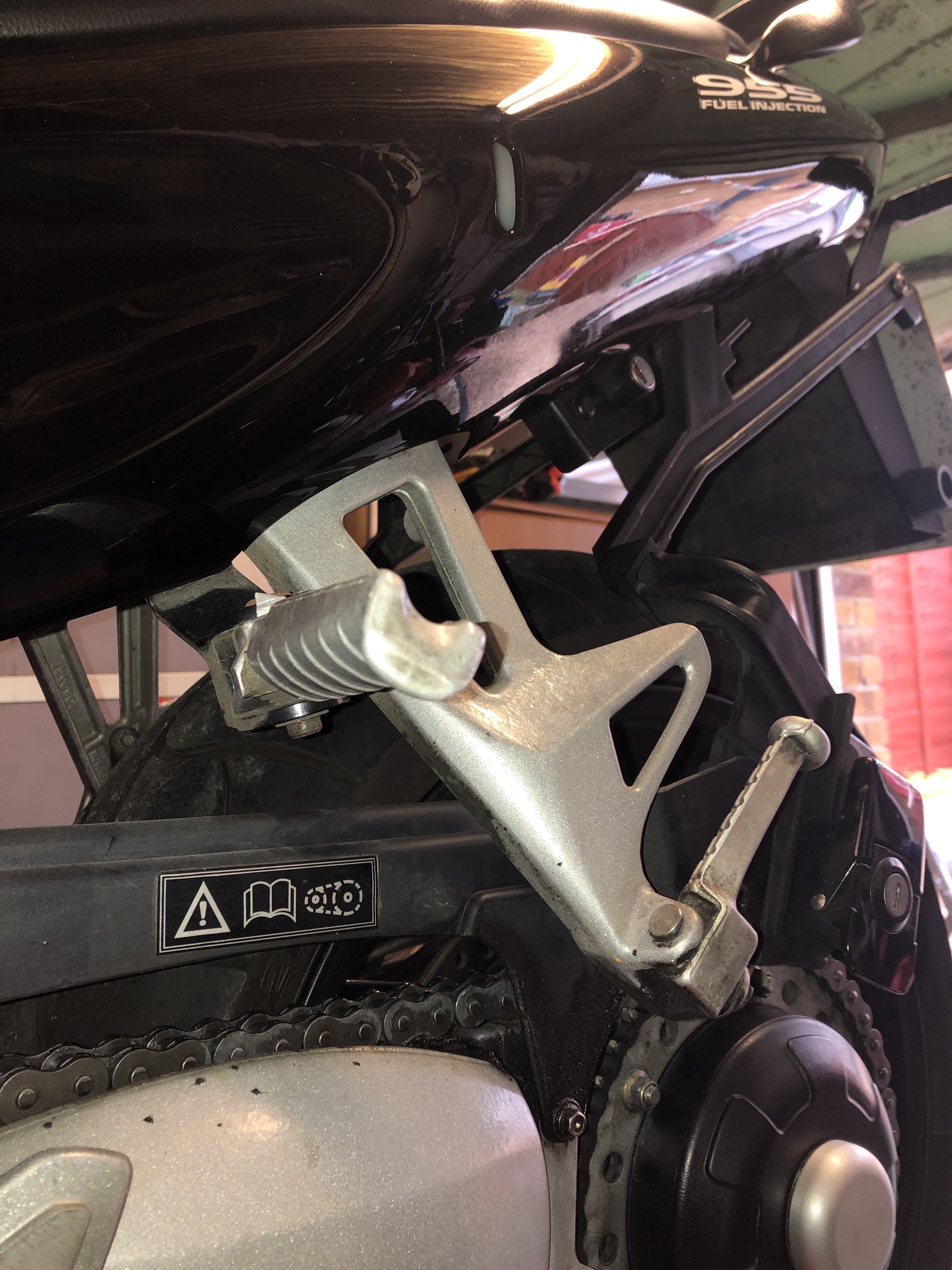

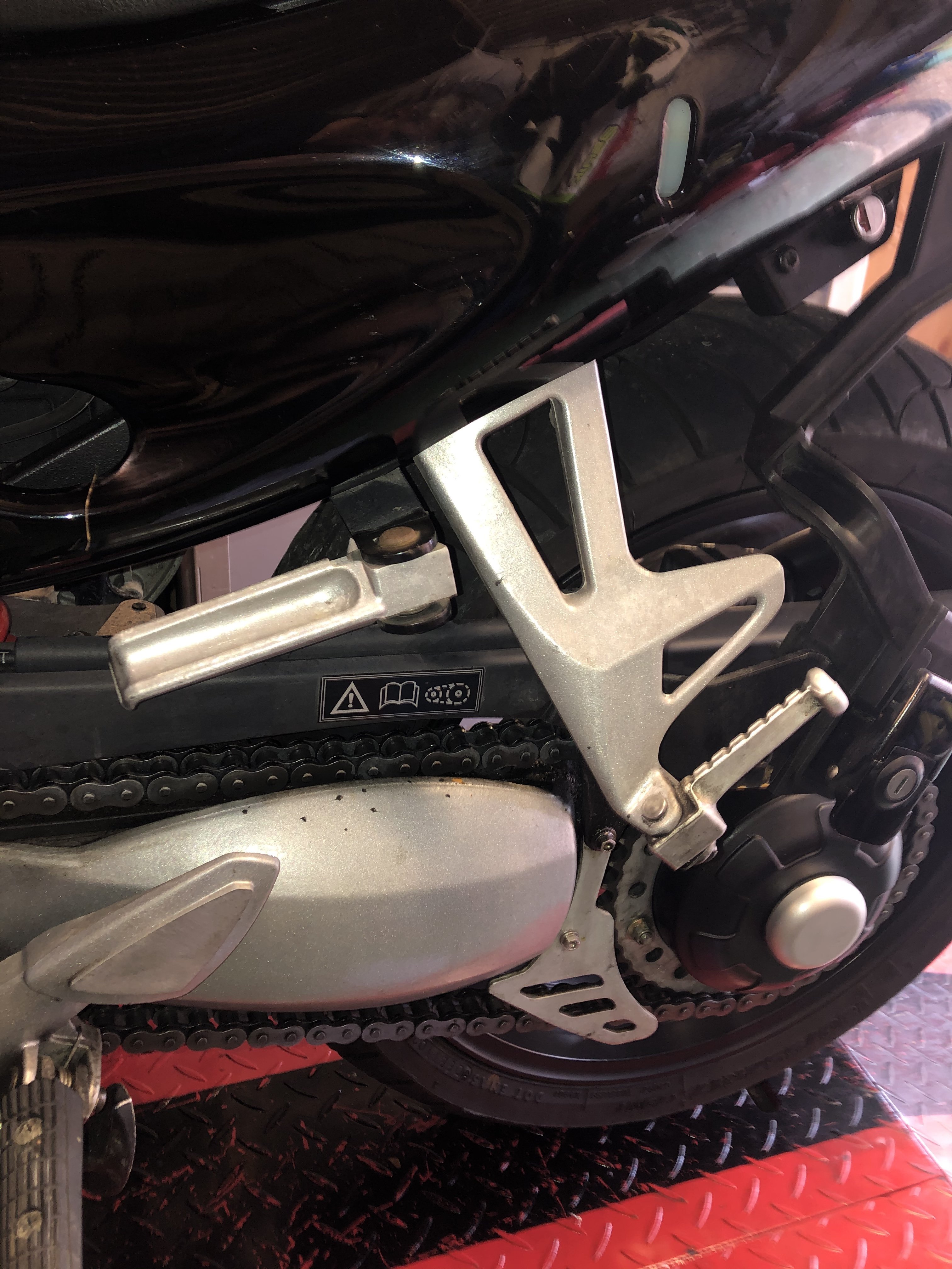

    Will take some pictures of the set up on my ST when I go in the garage later, but mine has what looks like an upside down footrest bolted on left side that acts as a lift handle.
  4. Bad Billy
    6,800

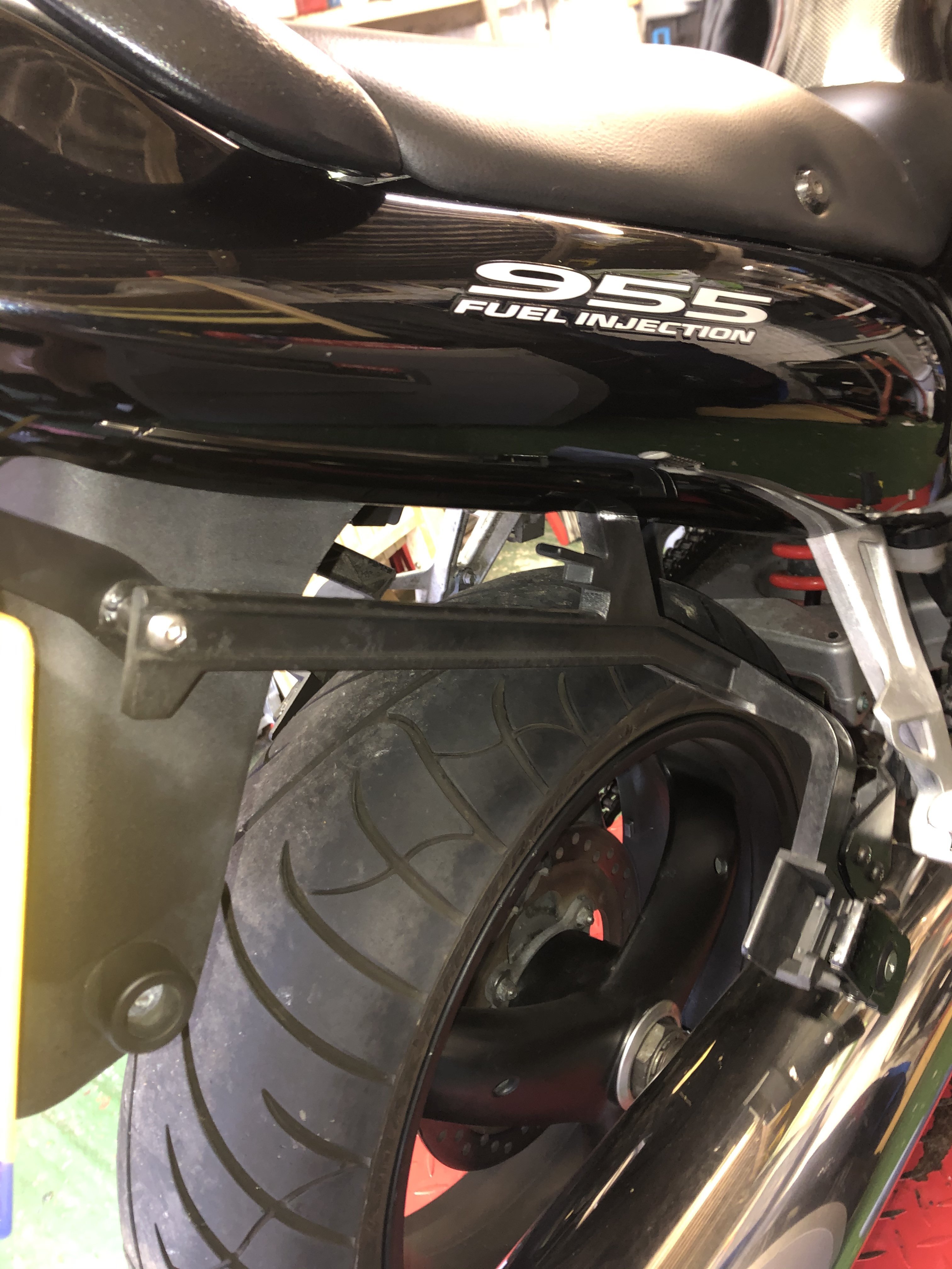

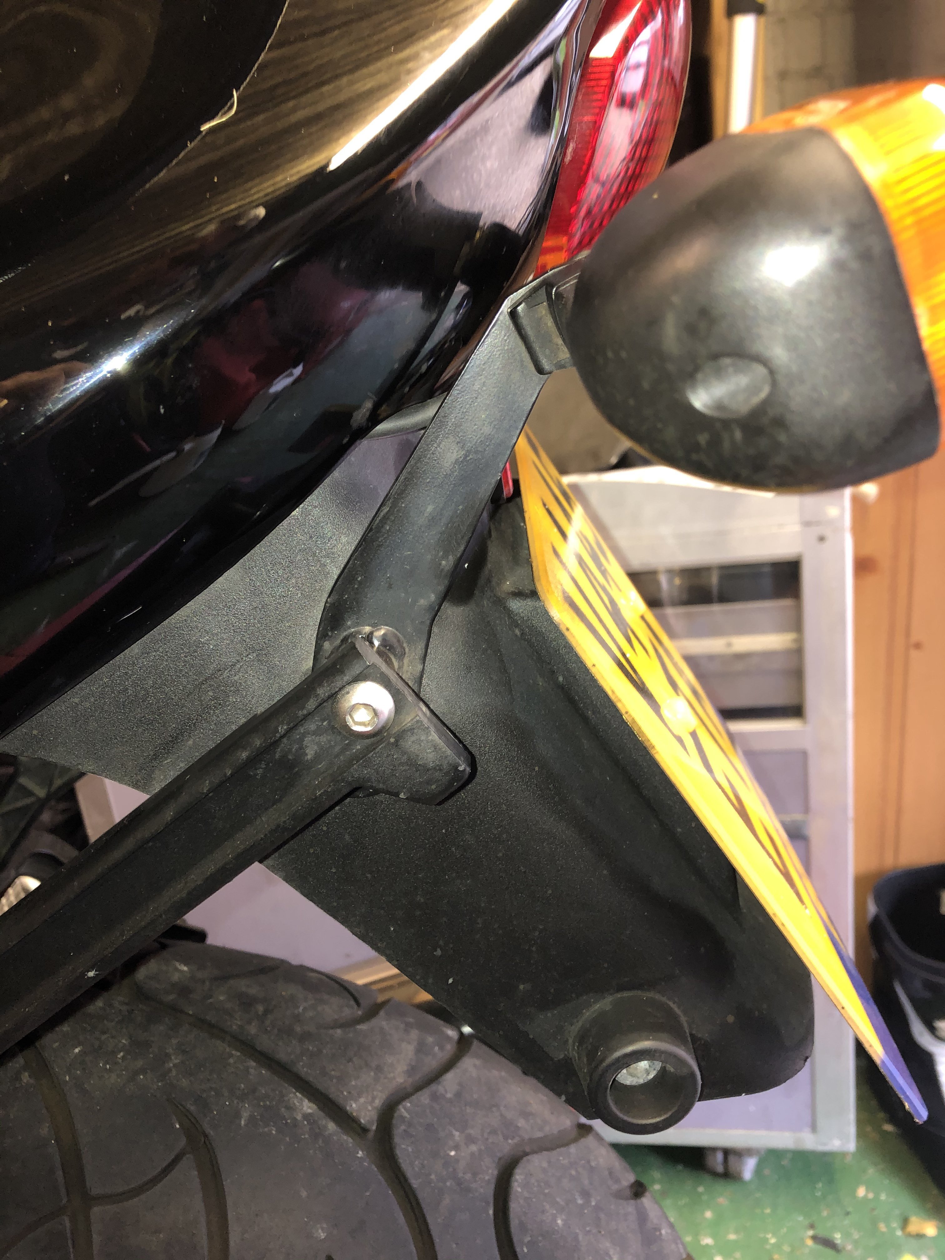

    Here you go, a few pictures of how the lifting handle & luggage rails are in mine, hope it helps.
    9B581F72-CF54-469D-8F71-2C4629E143B6.jpeg C222E0F7-6D02-41A3-9B0E-EAC7000CD2EF.jpeg 2418961D-DE43-4008-A825-4A4D03AC909A.jpeg 0CC3CAC6-C402-4AF9-9B6F-AA5A0DA62AC5.jpeg 308B91F5-278E-433B-8412-DBB82E4F86E2.jpeg 5FA9CC3E-C6EF-40E7-A3DC-6B1BCA55E1B0.jpeg

    It is still not clear to me if it is a required part of the structure though the pictures suggest it is not.
    Also can see the bumper strut on the mudguard.

    Thanks, glad photos were useful, from memory I think @Adie P said the handle had been added by previous owned to assist getting it on centre stand when panniers fully loaded.
