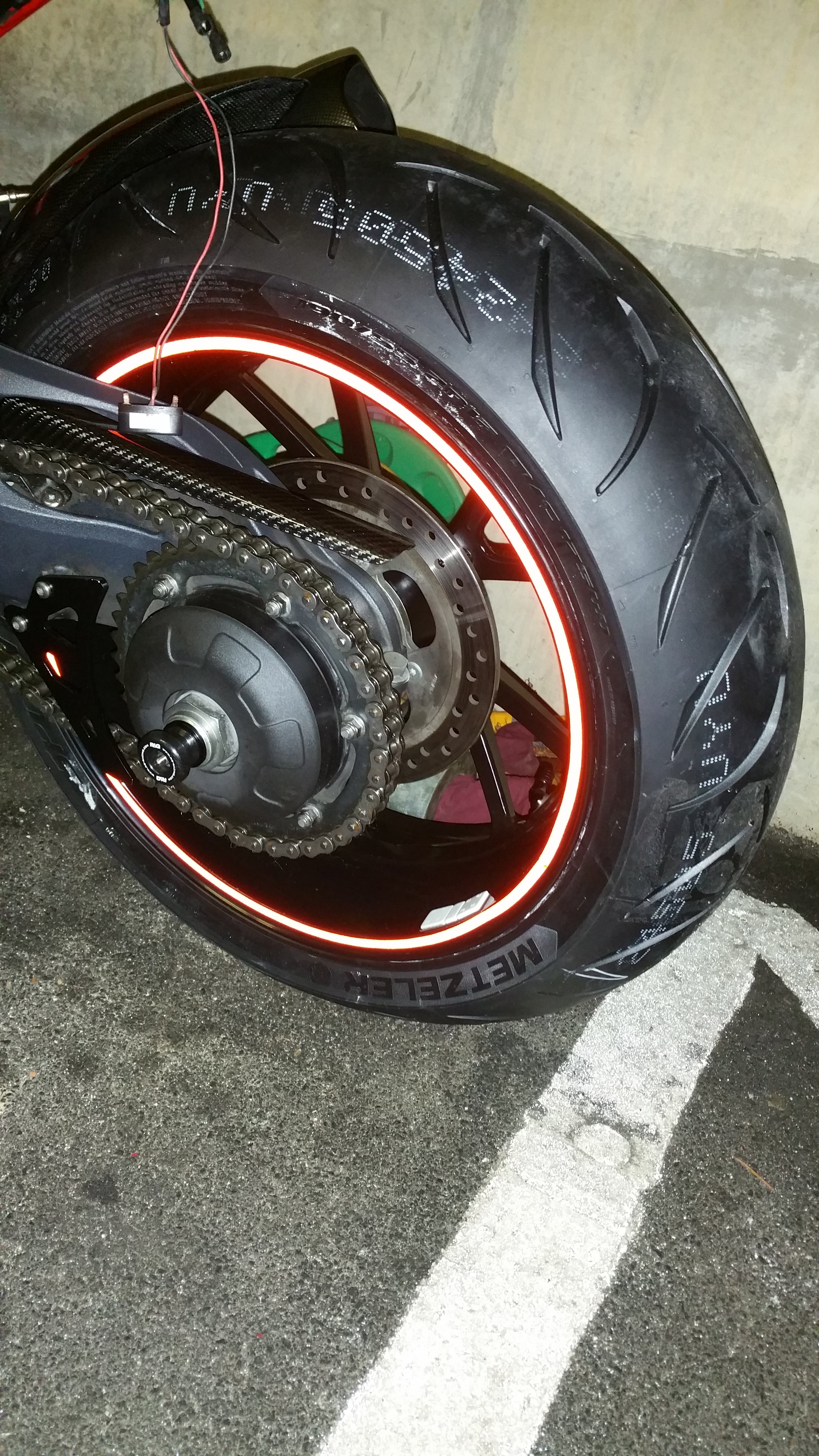

  19. R_1000
    R_1000 Elite Member
    Sep 2, 2016
    1,475
    700
    UK, London
    Here we go Mr Darkman. ... the new metzeler m7rr 190/55 ;-)
