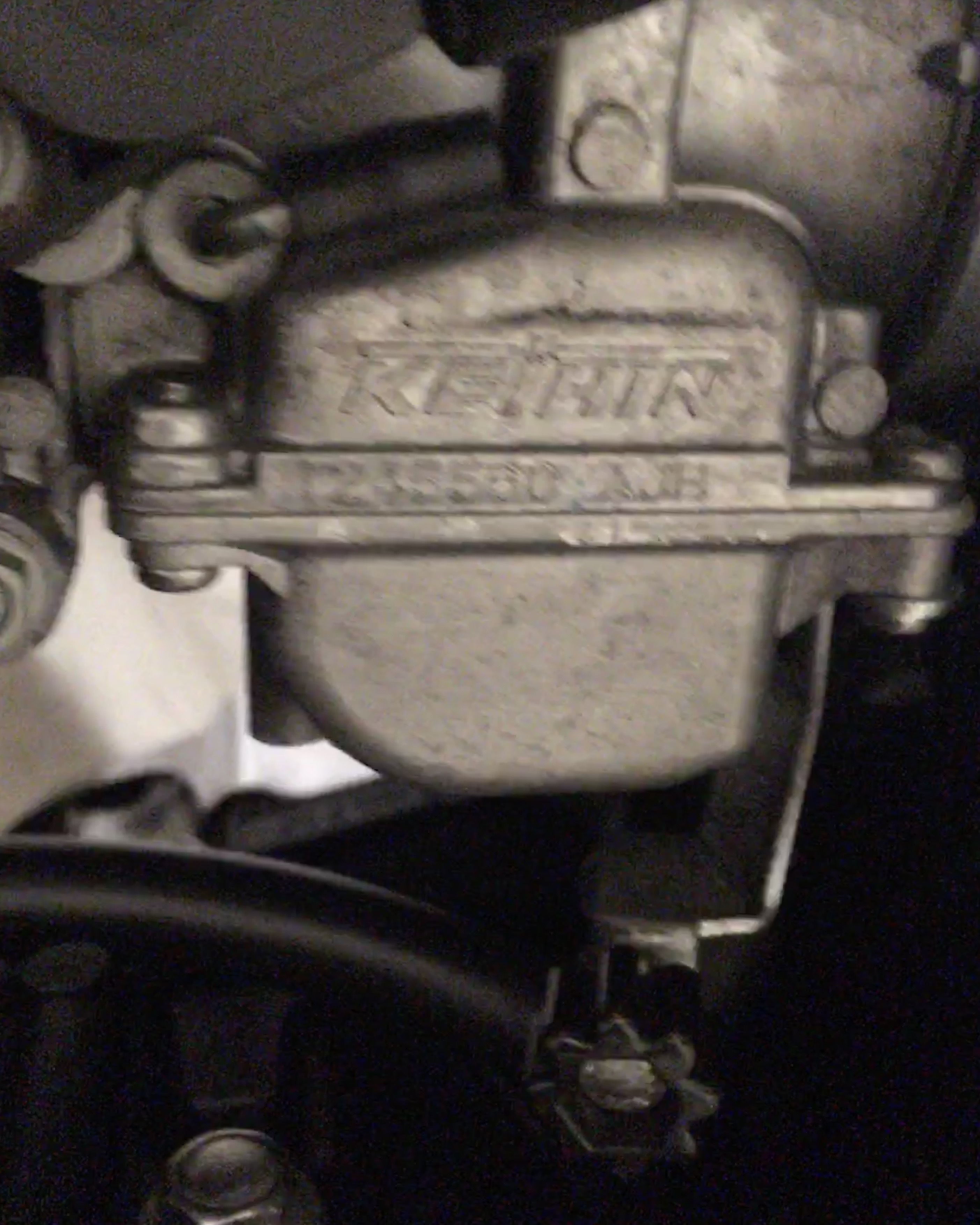

    This my 2011 T100, at the bottom of the picture is a what looks like a hand adjustment screw.
    there's nothing in my hand book regarding this, What can it be.??? sorry I'm pretty useless with a camera, but hope you can see what I mean

    This will be the idle adjustment knob Malcolm

    OK Well thanks for that, but being new to this bike I thought the so so called choke pull out dealt with that.

    I find it usefull to manually adjust the idle if its slightly low ive set mine to 1000rpm now as when purchased it was 900 i felt it was idling low

    Always had my America tickover slightly higher, stopped the stalling problems. Not
    sure if affects the standard Bonnie's as much as the America/Speedmasters.

    I reckon the 360 degree motor is happiest at 1050-1100 rpm for clean pull away and minimum effective alternator speed.
