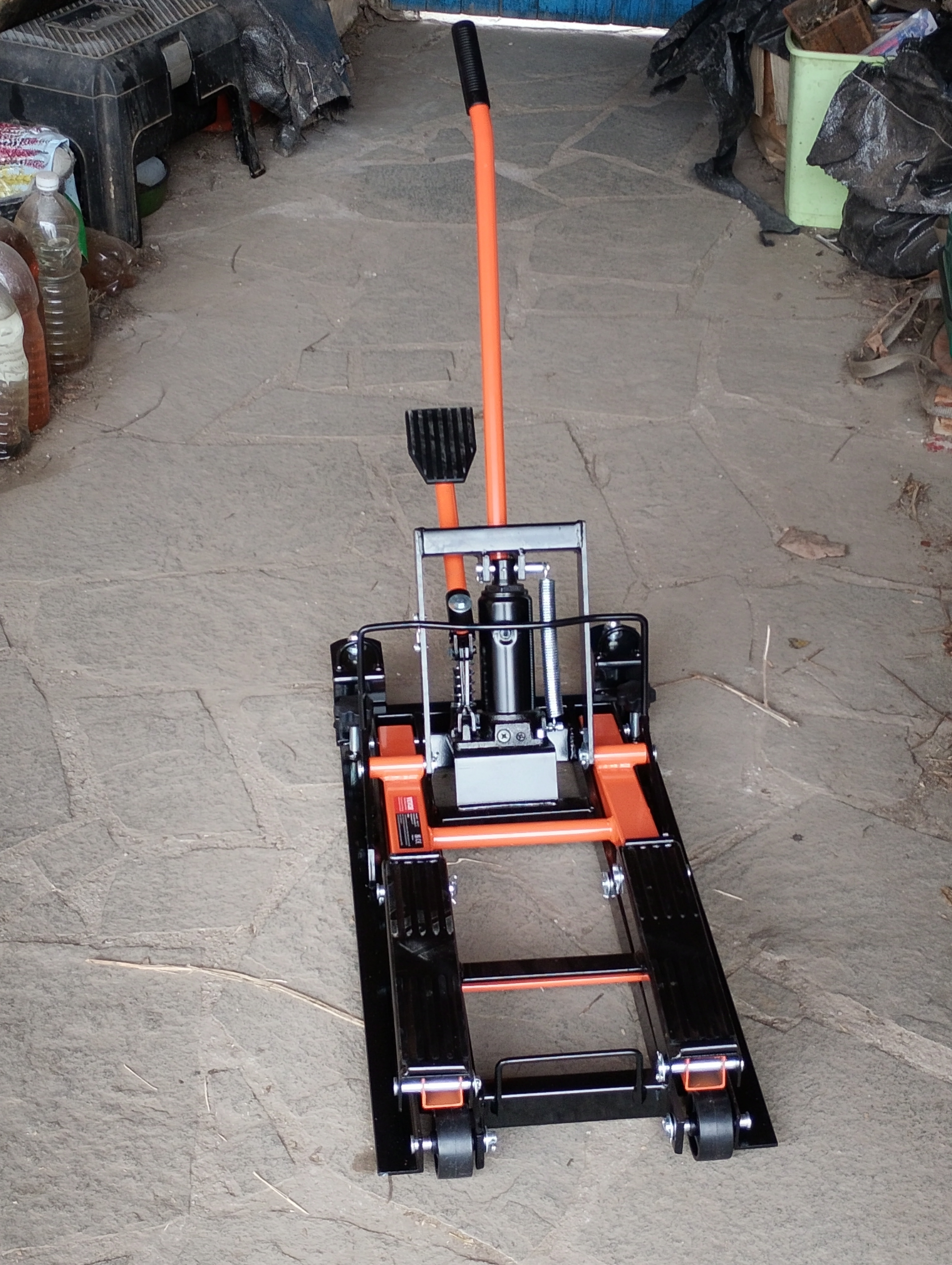

    Bought a couple of bike jacks and have found that due to the coolant hoses and oil filter position that they are very difficult to use on this Honda Shadow which is very disappointing to say the least as I need to remove the forks to get the seals replaced. Will have to see I can figure out a safe way to lift it so the forks can be removed.

    Show us a pic or 2 of your Jacks and maybe we can offer some ideas?

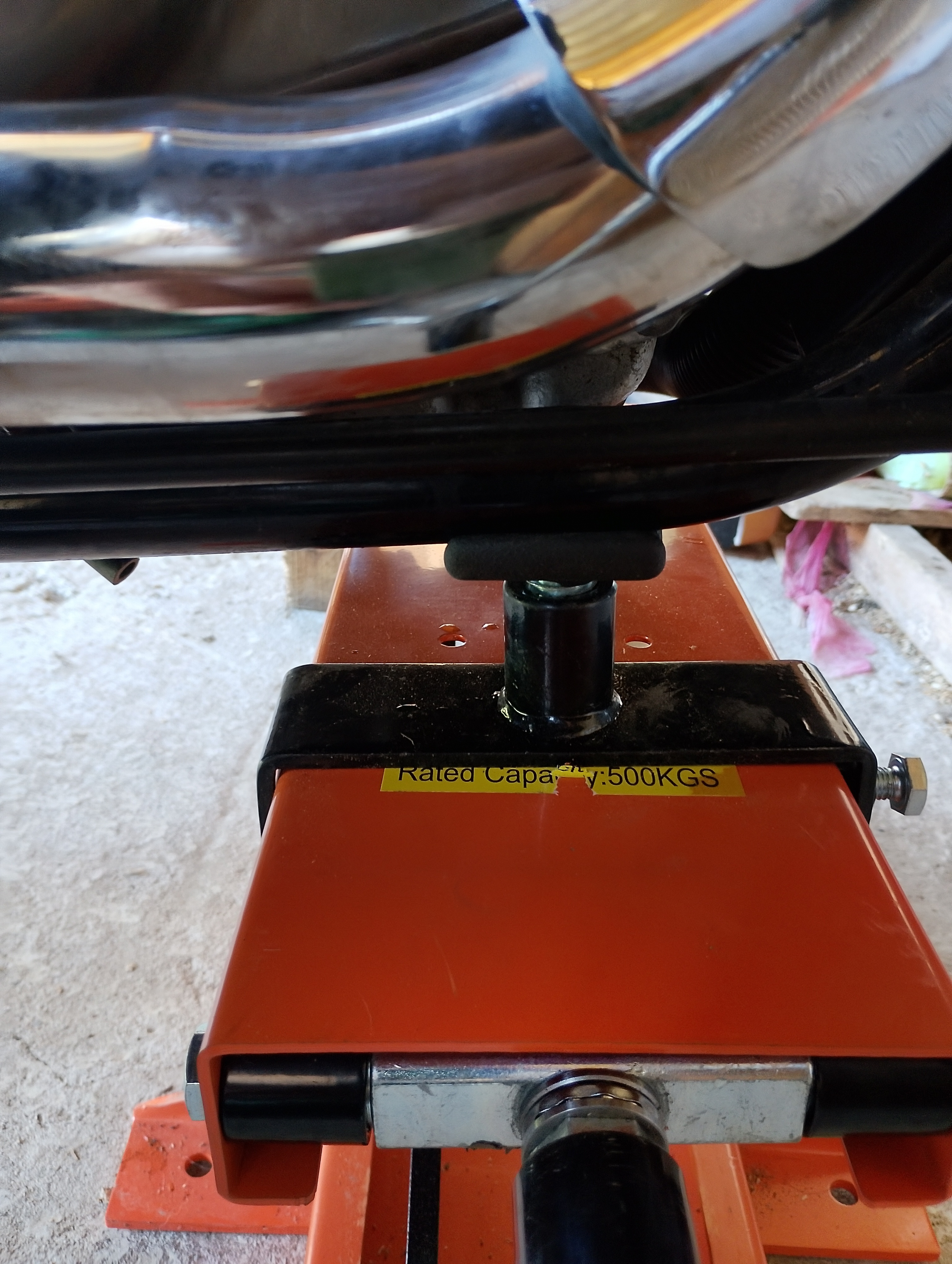

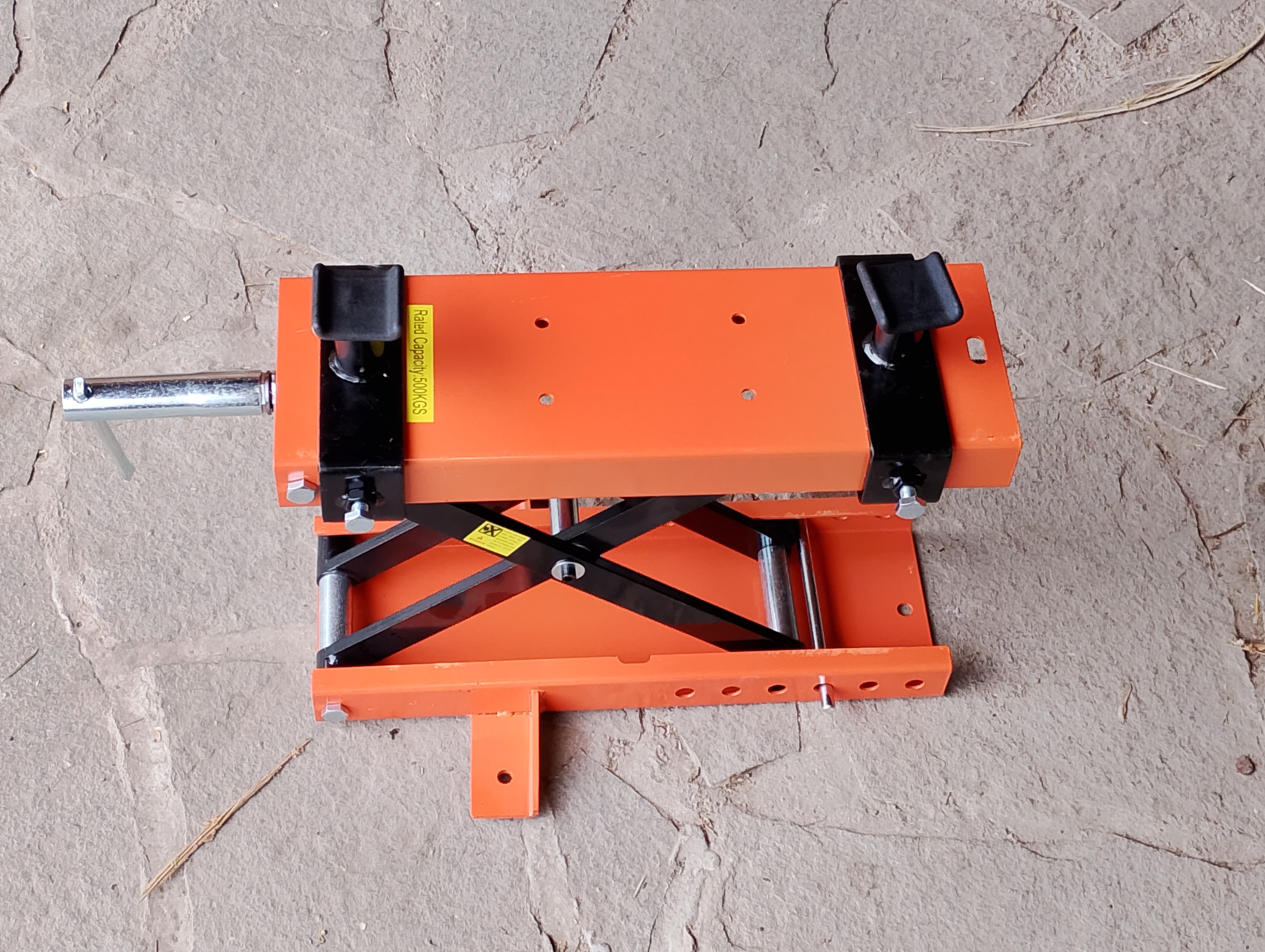

    Posted them the other day post #1236 on the previous page but here they are again;
    The smaller one with the curved pegs will raise it ut it is tilted to the left the larger hydraulic one puts pressure on the oil filter and the coolant hoses beneath the bike am wondering about cutting some wood to miss those things.

    Right so, the first pic here I have one of those also.
    Yep, why don't you get a piece of say 4" X 2" wood (100 X 50mm) or whatever you have hanging about, it needs to be longer than the bikes width. Shape the top face to fit your sump profile, err towards the front of the engine if doing the forks, depending on the point of balance.
    I take the black curved bits off and work with a flat face as I find it easier.
    I have some plastic packers that are about 50mm X 25mm and use multiples of these to fit under the sump I.e. between the exhausts, filters etc.
    Very stable and if in doubt ratchet strap the jack to the bike ;)

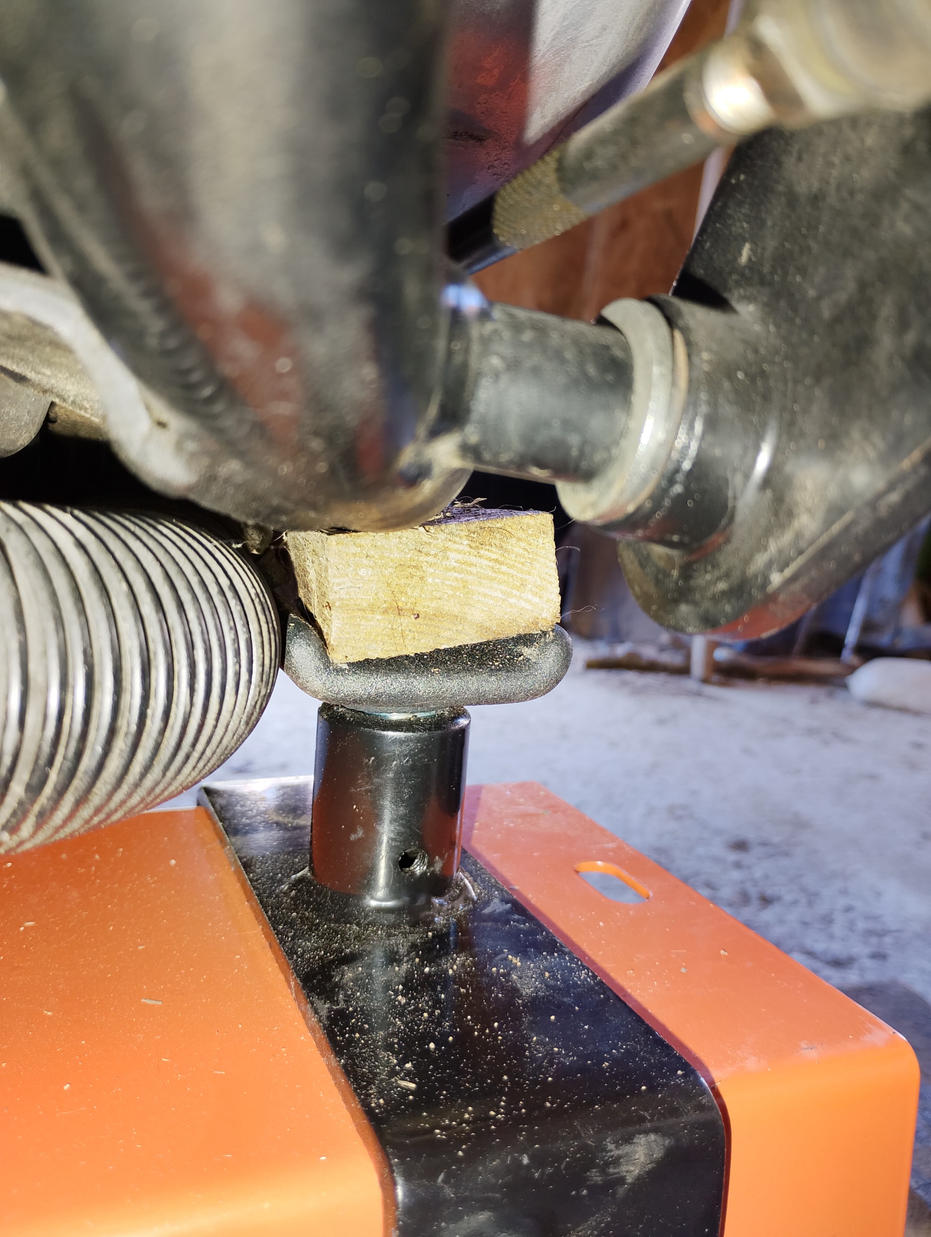

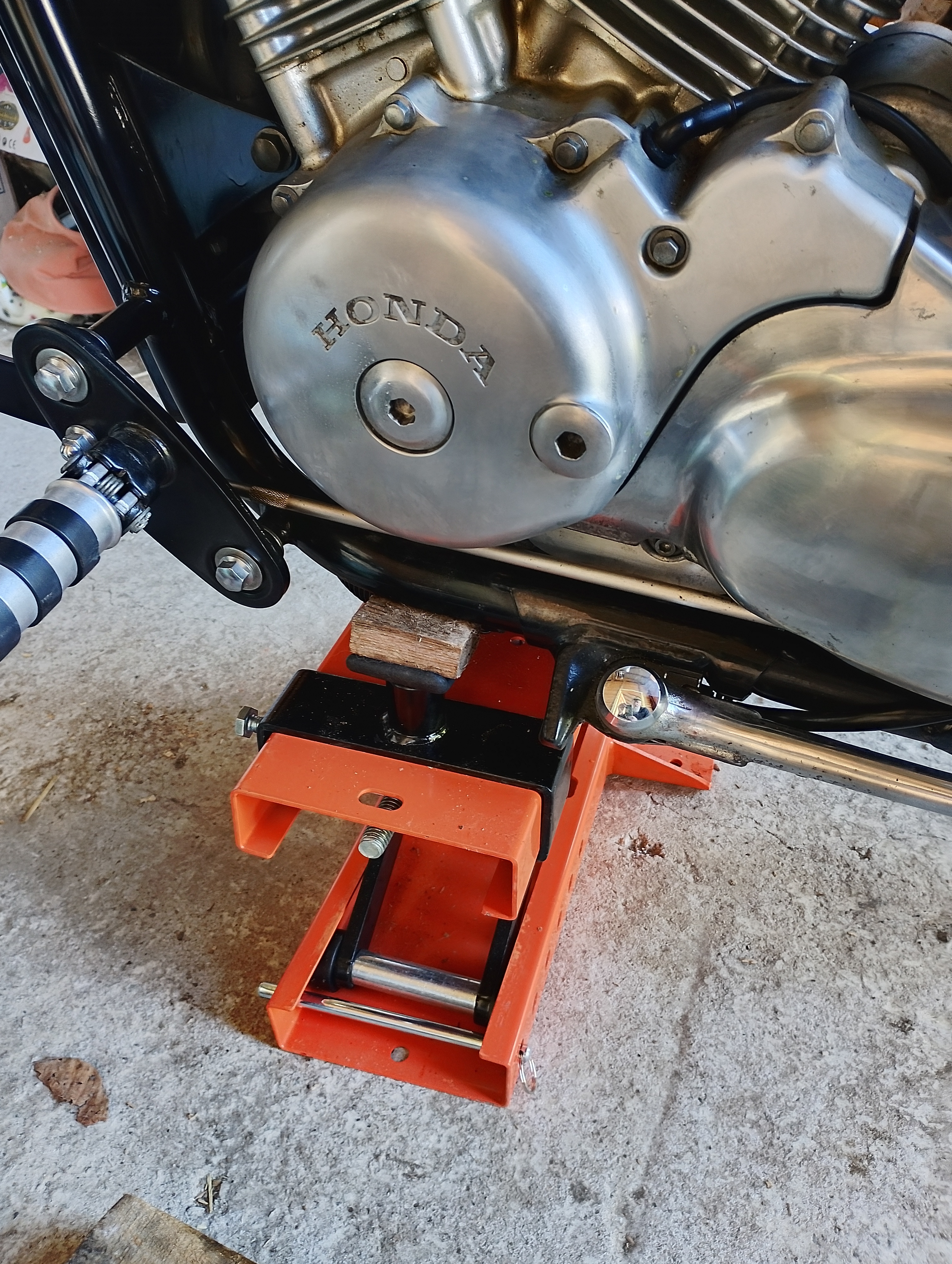

    Have sussed out why these jacks are tipping the bike to the left. In their wisdom it seems that Honda built the Shadow's frame with the right bottom rail lower than the left one:-
    By using a small piece of wood have managed to mostly level it up
    Here you can see the lower coolant hose that stops the other jack from being used easily.
    The bike should now be high enough to remove the fork legs ut if not there is plenty of height left in the jack the safety bar is only in th first hole.

    Chock the rear wheel otherwise a slight roll back will end in disaster.
    Alternatively with a bit of paracord/string, tie the jack in a v formation to the rear wheel rim to retain the distance.
