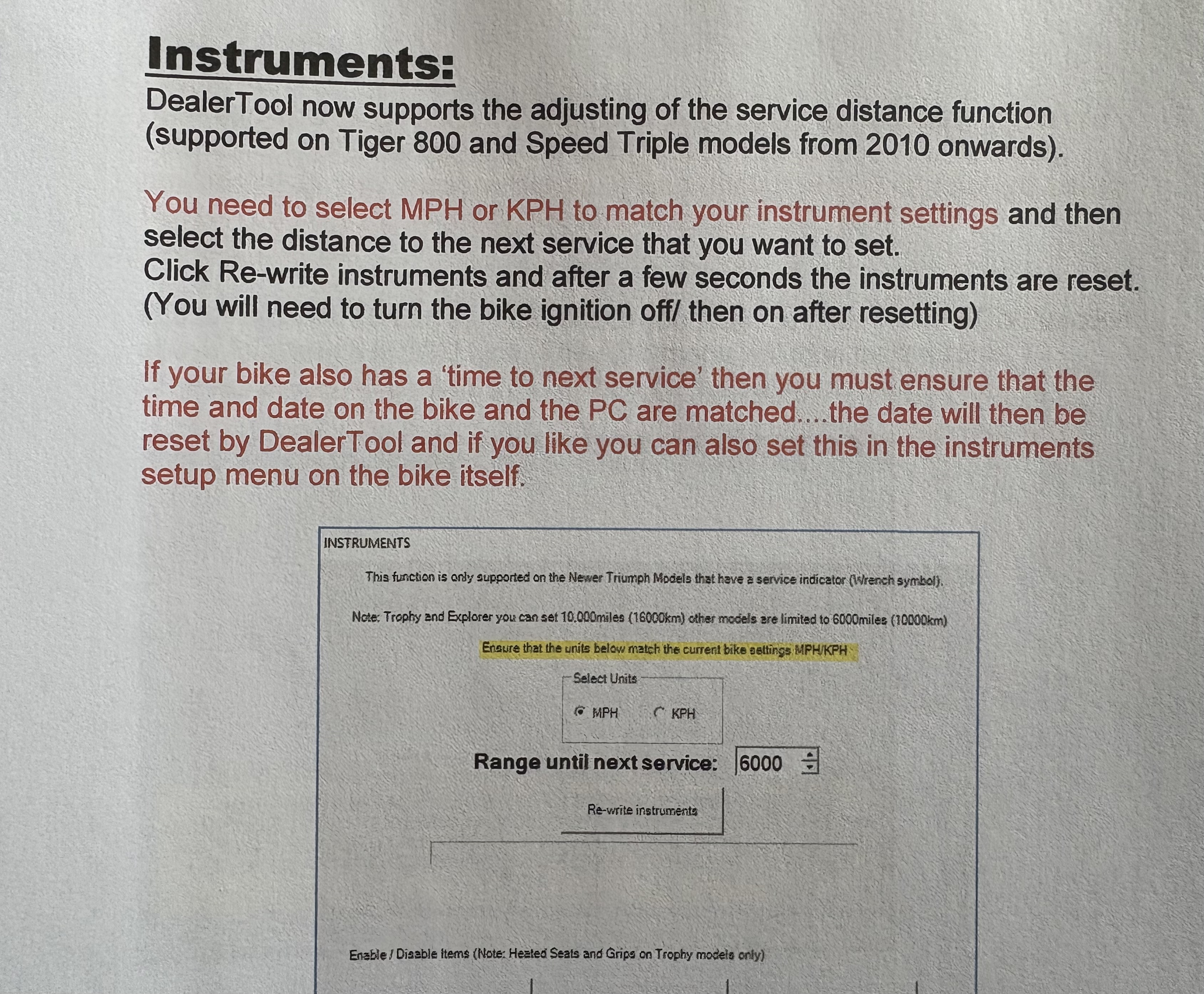

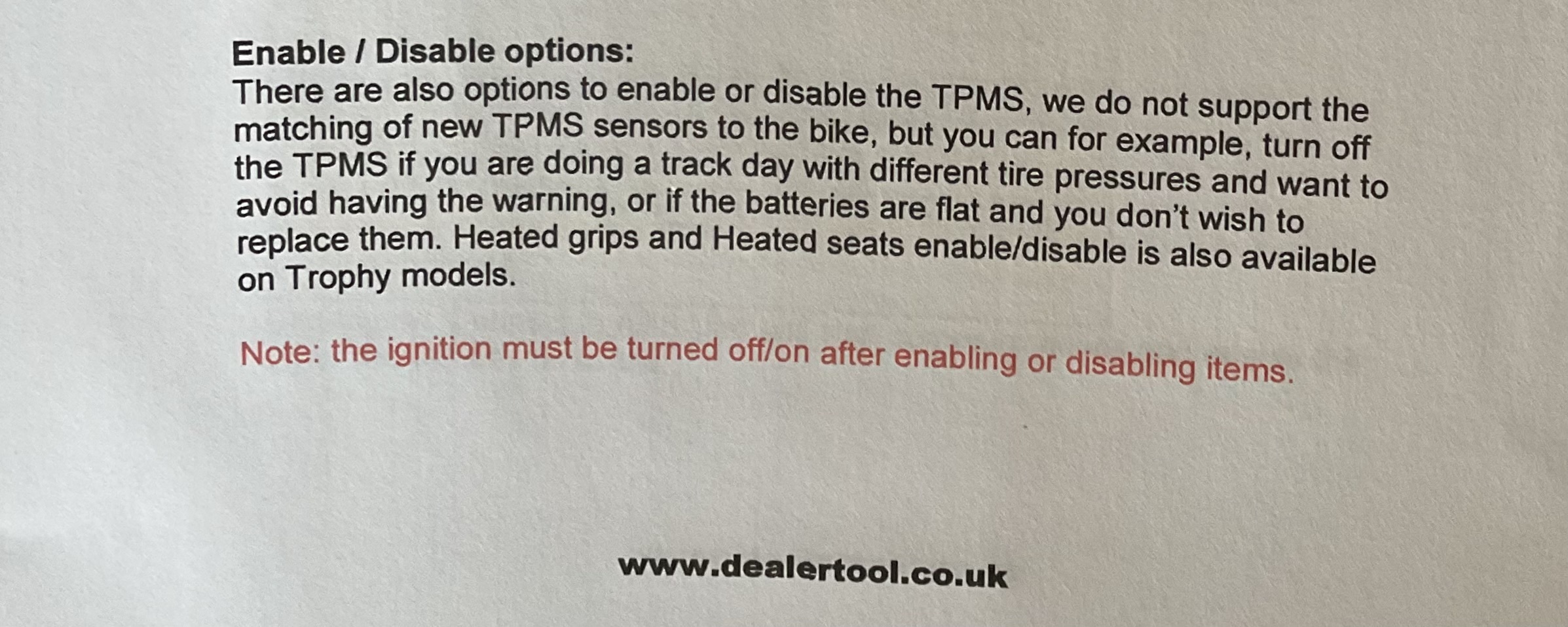

    Hi and welcome to the forum :cool: - I have the DealerTool for my 2013 plate Tiger 1050 SE. It doesn’t have any TPMS but in the blurb from dealertool if says……
    So should allow you to turn the TPMS off
    EDIT - The DealerTool also allows you to adjust the service interval time and turn off the service light….

    Go to https://dealertool.co.uk/ from memory mine was £65 - you get the adaptor lead and licence. Download the software on to your laptop - all very straight forward (I’m not an IT whizz by any stretch of the imagination).
    You can then plug your laptop via their lead in to the OBD port on the bike (looks a bit like the old SCART connection on your TV / video) and do whatever you need to.
    I bought it so I could do a proper fluid bleed of the ABS system and it worked great (link to post below). I adjusted the service interval to the max so I wont get any annoying lights come up and I used it to check the throttle balance. As mentioned I don't have a TPMS so can’t advise on that but it works for everything else so expect it will do what it says for that.
