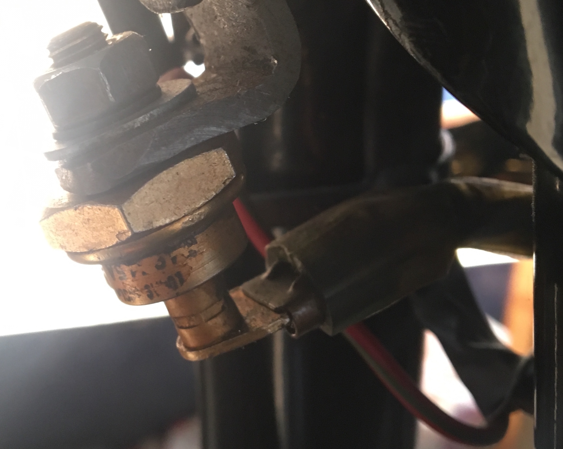

    Hi
    Could anyone identify what this is please. It’s on a triumph T110 and evidently is part of the 12v electrics. Someone asked me and I have to confess not sure what it does.
    Thanks.
  2. Tricky-Dicky
    Dec 12, 2016
    2,441
    Norfolk UK
    Its a zener diode, used for dumping extra current from the charging system...they normally have a heat sink attached.
  3. Triton1960
    Triton1960 Well-Known Member
    Oct 6, 2017
    32
    Thanks for quick reply. Had a look on web. Seen the heat sink, but this does not have one. Is that an issue or should he get one fitted. Says been like that a long time.
  4. Tricky-Dicky
    Dec 12, 2016
    2,441
    Norfolk UK
    Its attached/earthed to a hefty piece of metal so probably adequate if its been functioning for some time.
  5. BATEBY45
    BATEBY45 Well-Known Member
    Apr 29, 2014
    633
    A heat sink is recommended as it dumps excess current to stop boiling the battery, there used to be an finned cast aluminium one fitted to alternator twins.
  6. Tricky-Dicky
    Dec 12, 2016
    2,441
    Norfolk UK
    I have used zeners bolted to the frame or a battery box...as long as its got enough mass to dissipate the heat its fine...but if you want the stock look you need one of these.
  7. Jeffrey Conlon
    Apr 4, 2018
    59
    Wakefield
    The wind cools the heat sink for better efficiency, less chance of electrical breakdown
  8. Tricky-Dicky
    Dec 12, 2016
    2,441
    Norfolk UK
    I know how they work ...was just saying that if the item they are bolted to has enough mass/area then heat dissipation is no problem and often better than the std item and they will work perfectly efficiently never had one fail from needing better cooling....personally i prefer a solid state all in one reg/rec.

  10. Jeffrey Conlon
    Apr 4, 2018
    59
    Wakefield
    Being an ex electronics engineer, the zener diode SHOULD have the ALUMINIUM heat sink attached to the body of the diode, the surfaces that touch should be very clean and dry with a smearing of heat sink compound, this transfers the excess heat more efficiently to the aluminium which has got a greater thermal coefficient for dissipation AND has a massive surface area for heat loss AT the exact point required ie at the diode junction internally. Also if the bike is a keeper the originality looks better if required
    Regards Jeff
  11. Jeffrey Conlon
    Apr 4, 2018
    59
    Wakefield
    Being an ex electronics engineer, the zener diode SHOULD have the ALUMINIUM heat sink attached to the body of the diode, the surfaces that touch should be very clean and dry with a smearing of heat sink compound, this transfers the excess heat more efficiently to the aluminium which has got a greater thermal coefficient for dissipation AND has a massive surface area for heat loss AT the exact point required ie at the diode junction internally. As long as the rest of the charging circuit is working within its normal parameters it should be fit and forget hopefully. Could check voltage across when constant revs, say 1500.(DO NOT short out)
    Regards Jeff
