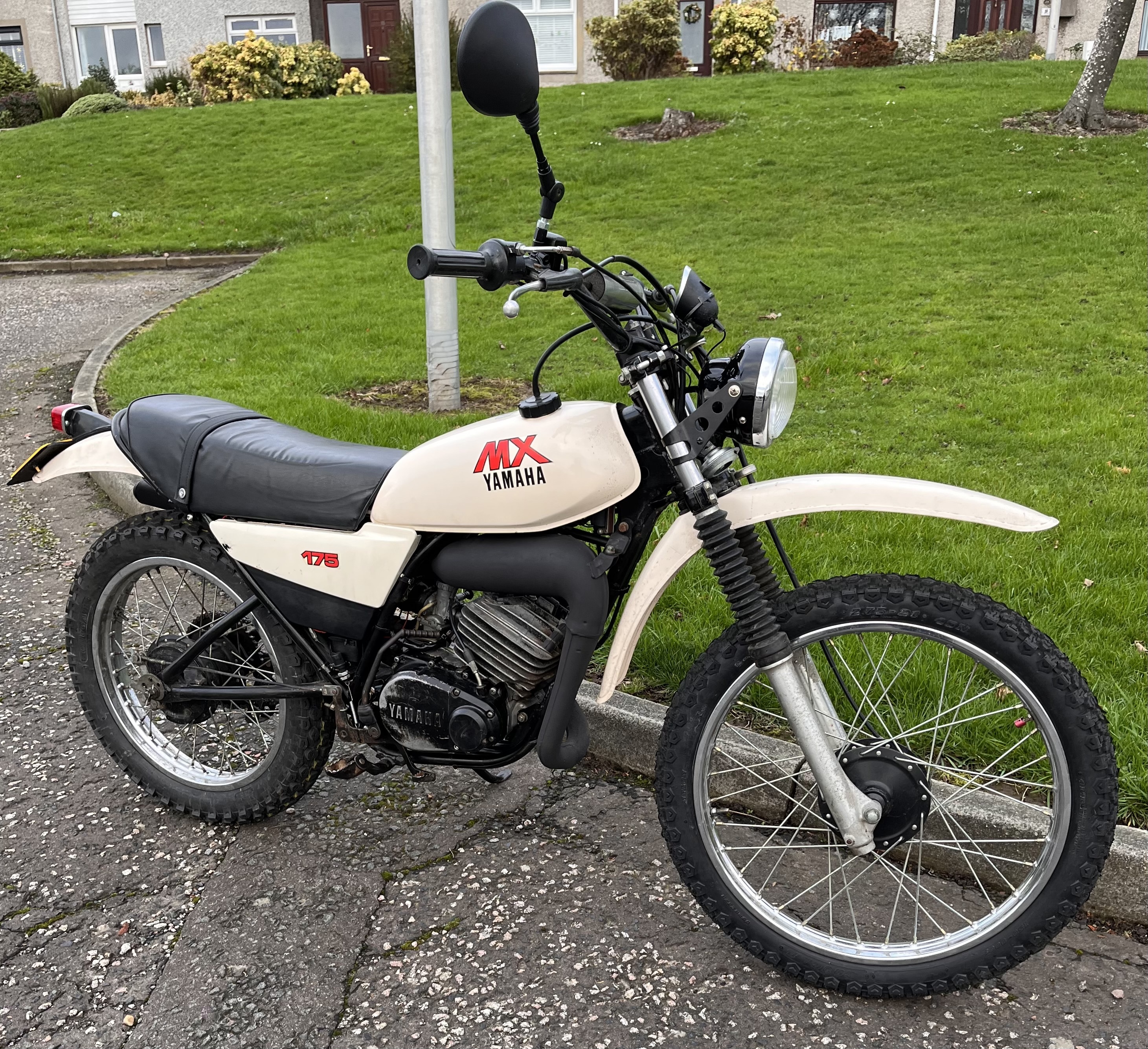

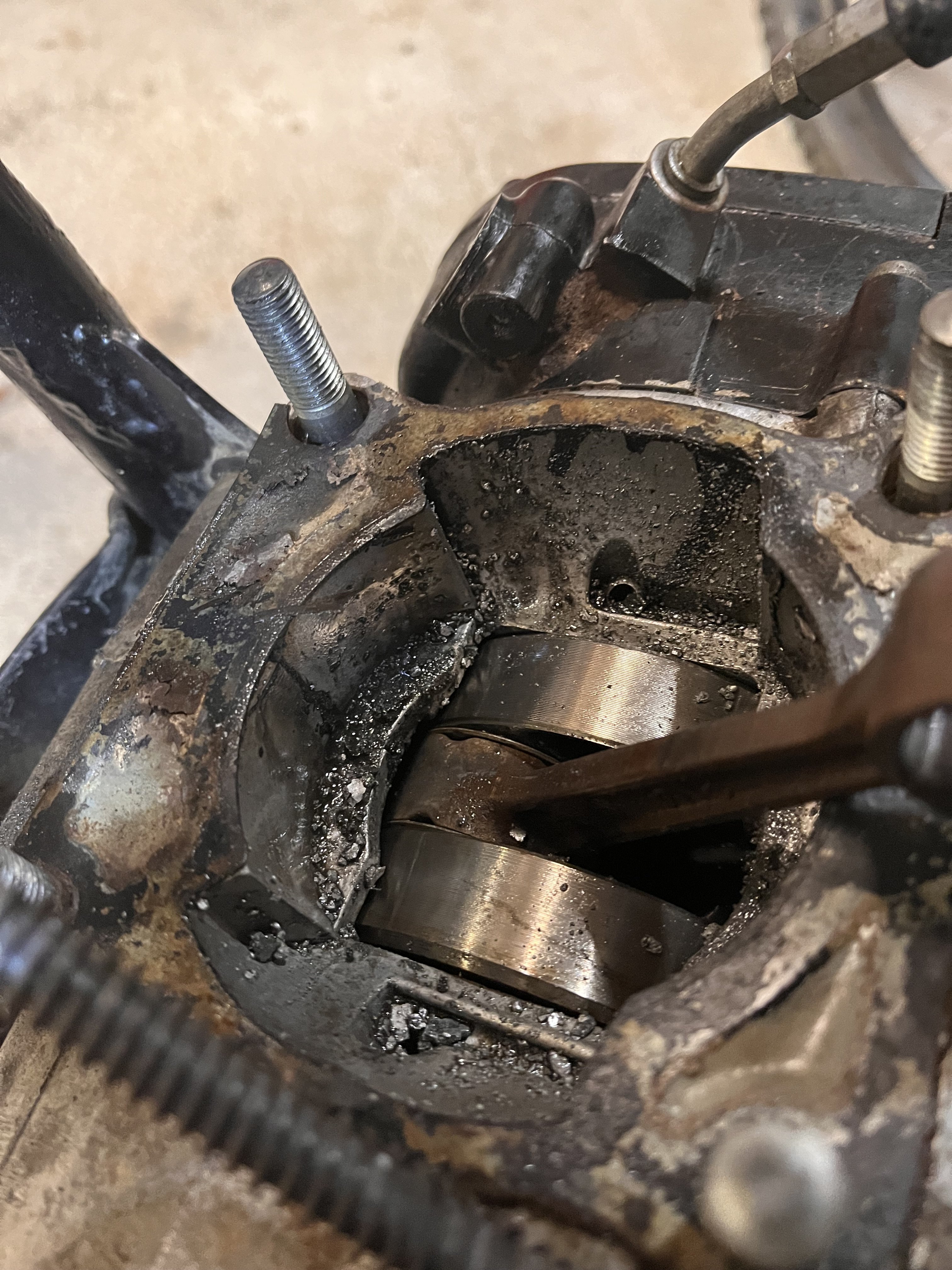

  4. Dod
    Dod Member
    Dec 30, 2023
    52
    Scotland
    Engine rebuilt on theYamaha after a hole in the piston.

  7. Eldon
    Eldon Crème de la Crème
    9,124
    What was the cause of the hole in the piston, lean mixture?
    Without resolving that then you are just going around in circles. I once had a Honda H100 as a skint 17 year old apprentice and I couldn't afford a new head gasket....... yep, a hole in the piston was the end result :confused:
  8. Dod
    Dod Member
    Dec 30, 2023
    52
    Scotland
    yes, running lean. I’ve went up a good bit higher on the main jet size to begin with and will come down one size at a time to try and get it right - well that’s the plan. What do you think

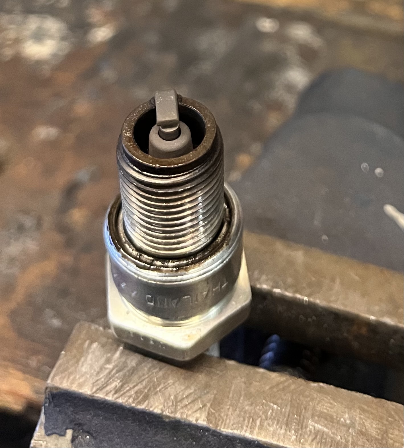

  10. Dod
    Dod Member
    Dec 30, 2023
    52
    Scotland
    That’s great advice, thanks for that. It is an air screw it’s at 1 1/4 turns but I’ll set it as you describe. I’ve only run the engine for an hour and have been taking it easy, this is what the plug looks like with this initial running. I’ll do a plug check flat out next time I am out. What do you think of how it looks while running in?

  12. Eldon
    9,124
    That looks something like colour wise, but it doesn't indicate main jetting unless run flat out then ignition chopped.
    1 1/4 turns out sounds ok but try adjusting for the highest tickover once warmed up. Doing it in 1/8 turn increments and allowing time to judge the effect, should show a sweet spot. You want to aim to be just slightly on the rich side of that sweet spot.

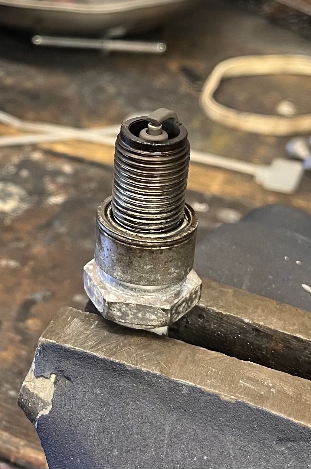

  15. Dod
    Dod Member
    Dec 30, 2023
    52
    Scotland
    I am still a bit scared to hold it flat out so gave it a quick rev through the gears for a bit then cut the engine flat out in fourth. I’m thinking still a bit lean?
    what do you think
  16. Eldon
    9,124
    Yes looks slightly lean so I might be tempted to go up x2 sizes on the main jet and then note the result.
    Another option is to give it choke when warm and flat out, you'll soon know (safely) if you are pushing the too rich boundary.
    The above was an old trick for trials bikes used on fast road sections, don't forget petrol also acts as a coolant on the piston crown.
