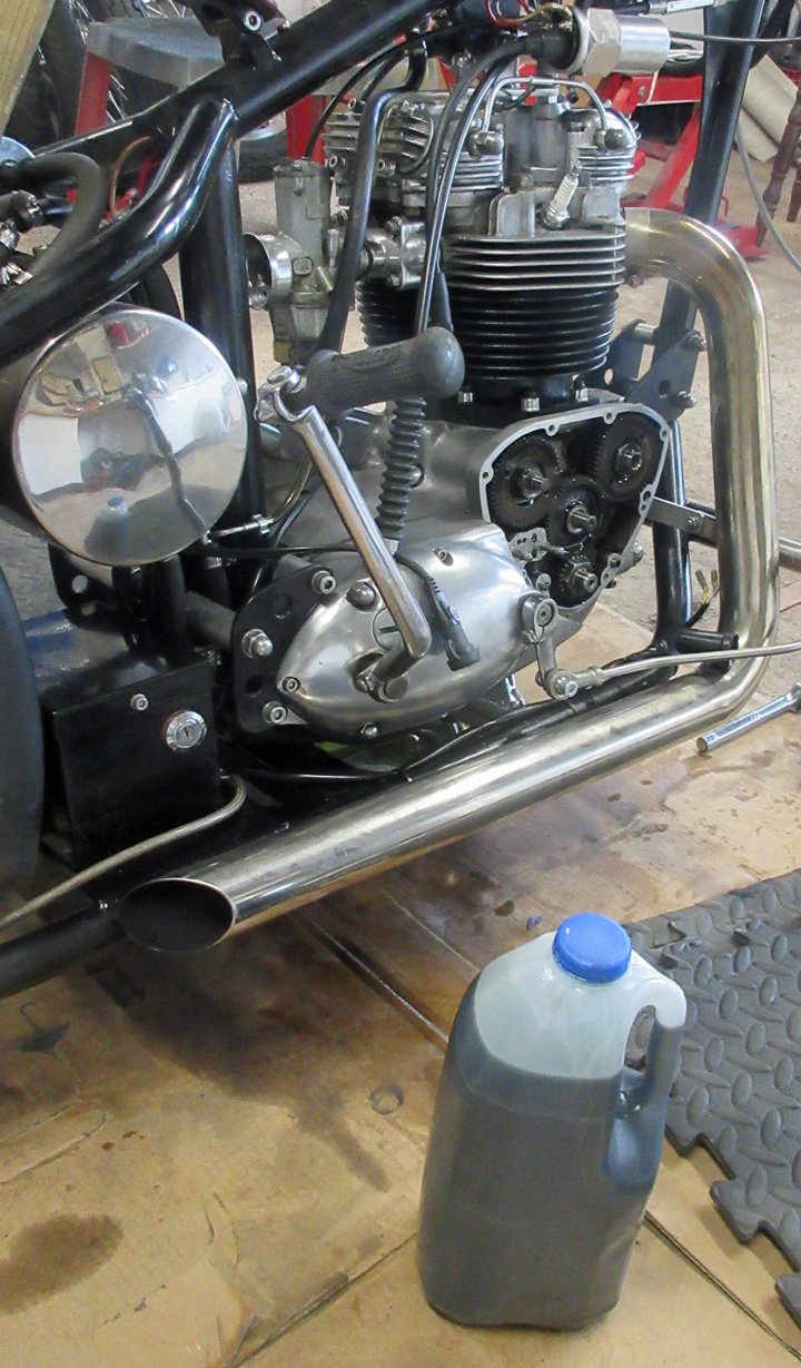

    You wake up one morning, decide to go for a poodle around, and a gallon of oil is on the floor, coming out of the zorsts or out of the breather. Bugger.
    You wrestle out the sump plug and, hey ho, the whole oil tank is in the sump. Here's a whole 4 pint plastic bottle full supplied directly from the sump - less the oil on the floor.
    So, I thought I'd do a check list for starters, for those Chaps and Chapesses with the same issues. And for the in house experienced among us to add to and therefore get a pretty extensive list for a DIY approach to fixing and/or finding the problem/s.

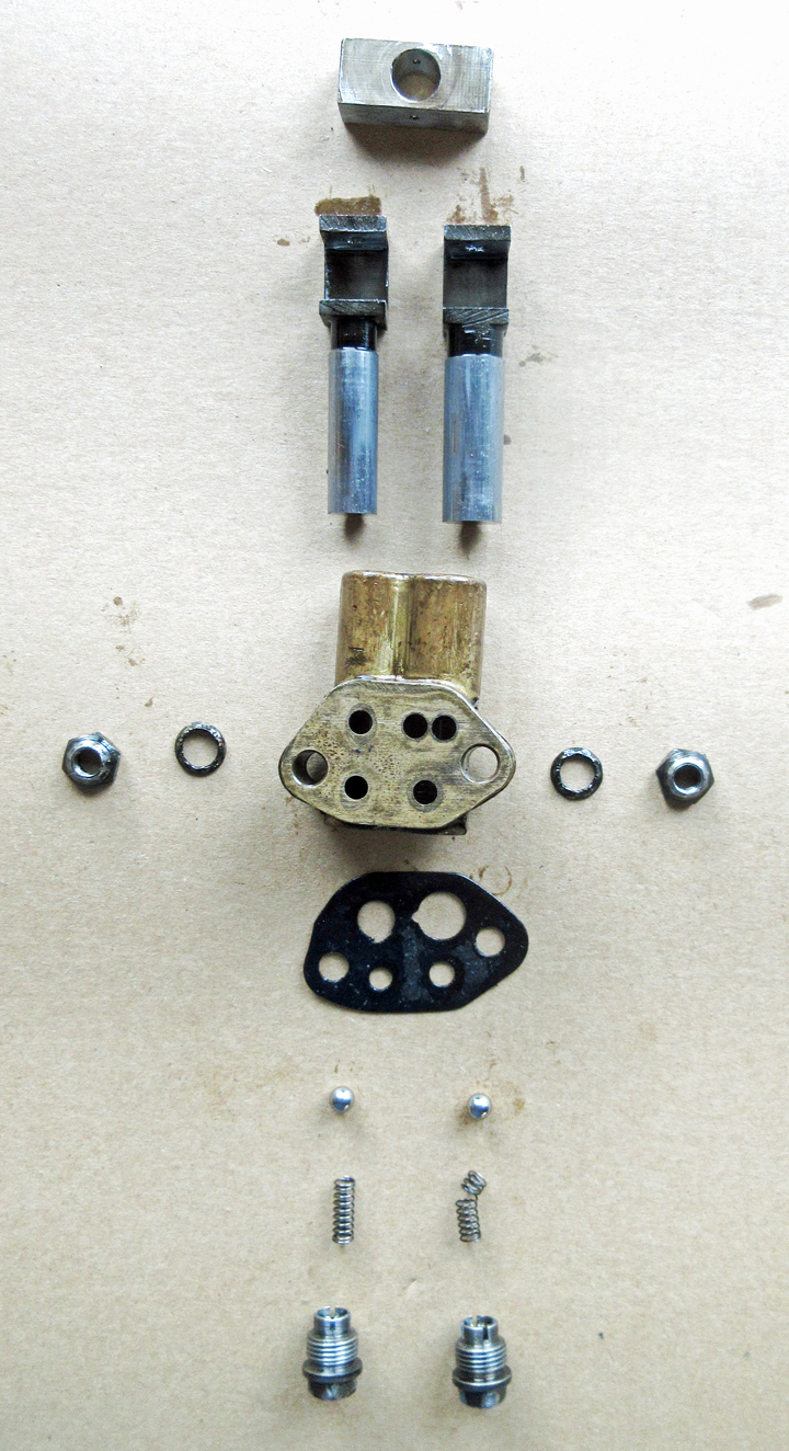

    This is the cause for the mess above (just in case you were wondering) - it's the dismantled oil pump - can you spot the problem?
  3. Hubaxe
    Mar 25, 2020
    1,718
    Aix Les bains - French Alps
    Not competent but would say the broken spring
  4. Iron
    Iron Guest
    Correct! Rounds of applause, and also that relief inside that you've found the problem, here's some more:

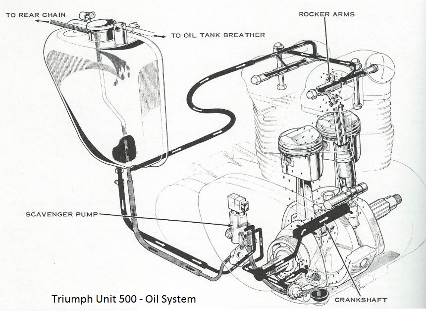

    Start at either end of the oil system and work your way through to make sure all oilways are clear and clean:
    This is a 500cc machine but the oil system is just about the same on all Triumph twins, work your way through the whole system

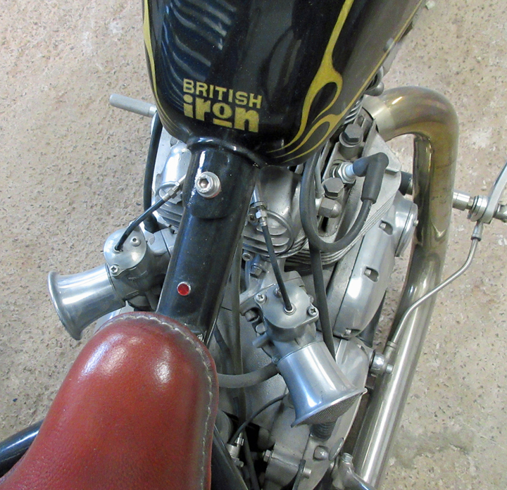

    Also an oil light/gauge is the best investment for an old Triumph - I ALWAYS include one or the other on all my re-builds or customs builds. (I learned this the hard way when I detonated an A75 - the real rocket three - engine in one of my first chops).
    See the little red light built into the frame? The only idiot light you need on a Trumpet.
