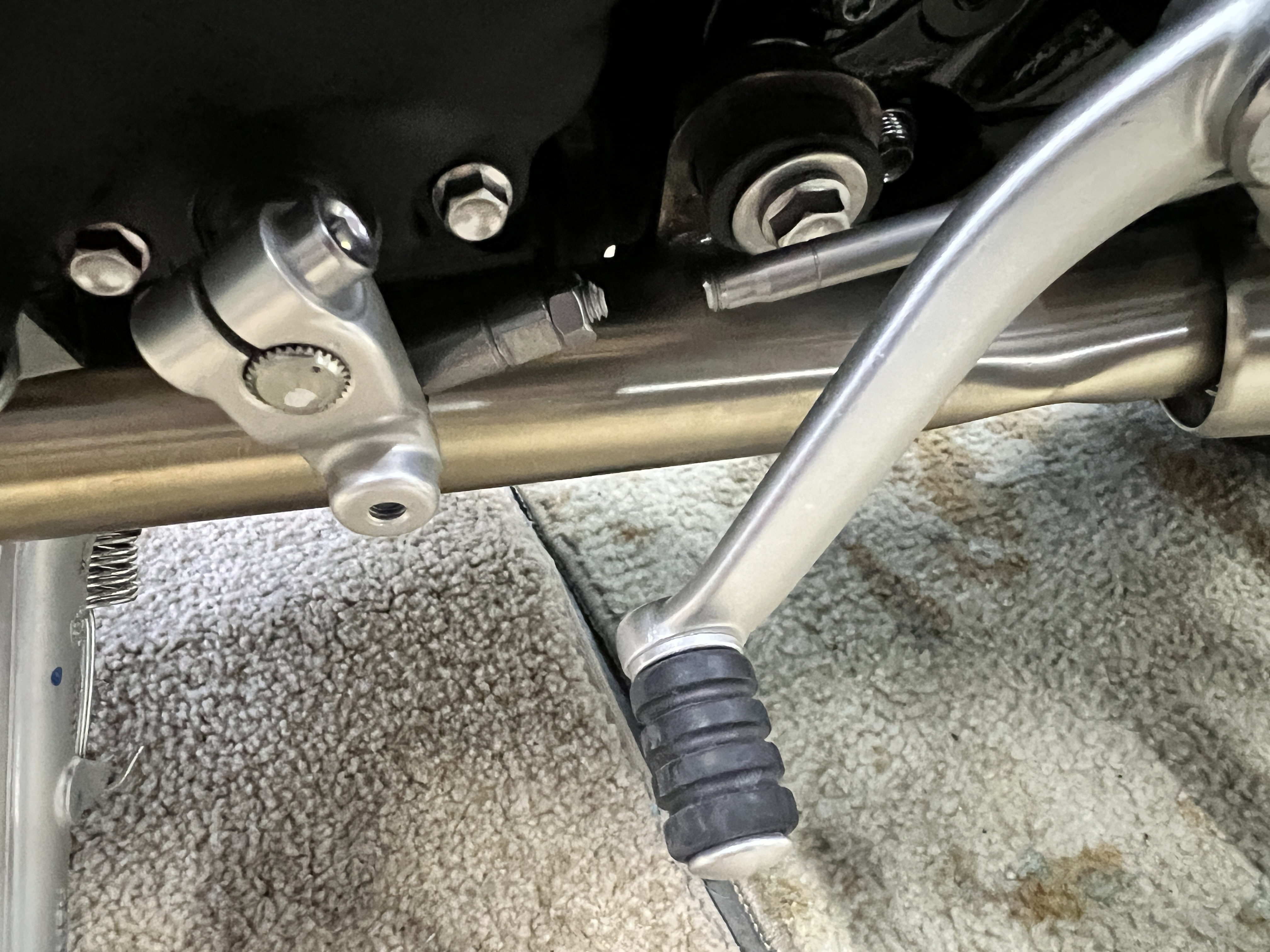

  14. FlyingAce71
    FlyingAce71 Well-Known Member
    Oct 8, 2023
    70
    Northwest Arkansas
    I just had a slow tip over in the garage, landing on carpet of my 2025 Thruxton Final Edition and was surprised that the gear shift linkage broke so easily. Thankfully it was a cheap part ($26) and I even got my dealer to get it claimed under warranty. The parts guy said that his rep said they know about it… but no recalls for it yet, or ever. I got an extra one just in case!
