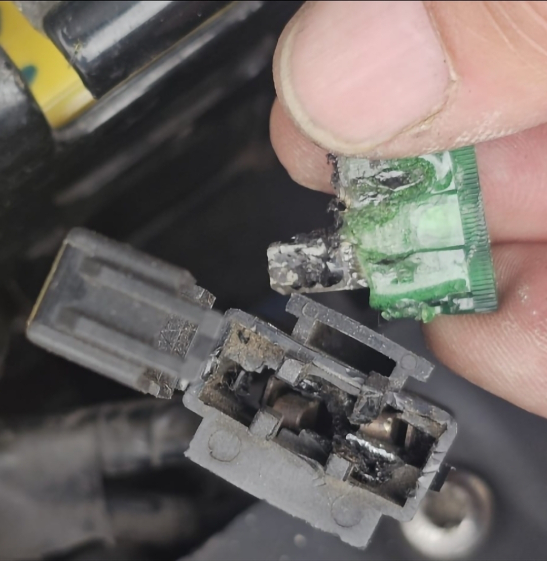

    Had a little play with the 94r today . Found the main 30amp fuse and holder all melted and stuck together ! Still not sure what's caused it but I can't find anything else wrong with it. Clamped a new fuse across the terminals and all seems fine. Starts OK. No voltage drop and runs OK ??
    Need to get hold of another triumph 30amp fuse holder from somewhere.

    Strewth mate, that's a codder. You could probably get a fuse holder from Halfrauds or similar and splice it in for at least a temporary fix and see if it behaves. Just bung in place with a couple of zip ties or a blob of Araldite....

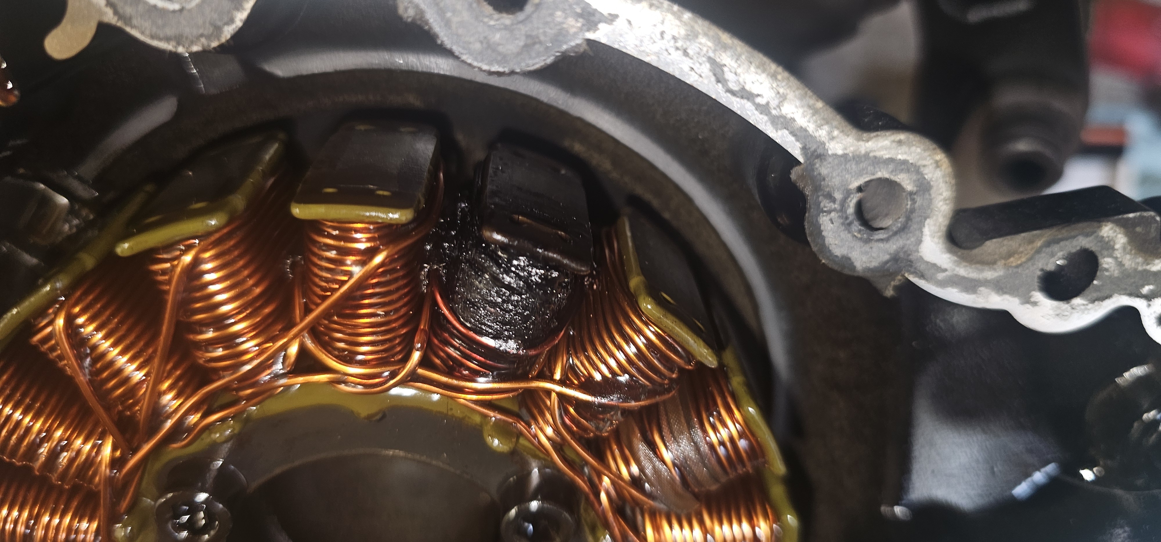

    Also I've just checked and I'm getting a 12.5v recharge rate when it's running . Guessing that should be nearer 13.5v , so may need a bit more investigation

    Corrosion can cause that to happen as it increases the resistance.

    Still having trouble with the charging rate and flat batteries , i'd already changed the voltage regulator/rectifier so pulled the stator out and one of the copper wound coils looks cooked. I couldnt find any loose or bared wires so petty sure this is the problem .
    Anyone got a link for a descent reliable brand so I can buy a new one ?

    Cheers I just rang west country windings and they had one. I'll let you know how it goes :)

    Next day delivery from West coast windings. Well happy
