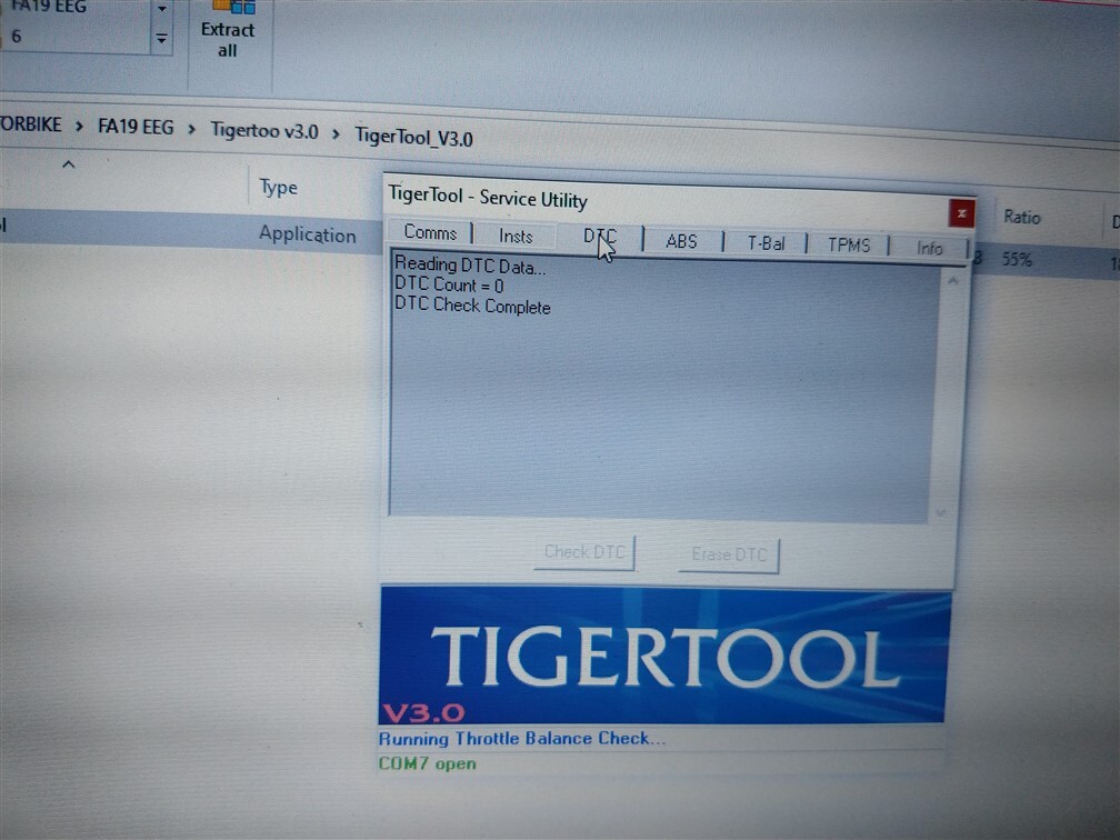

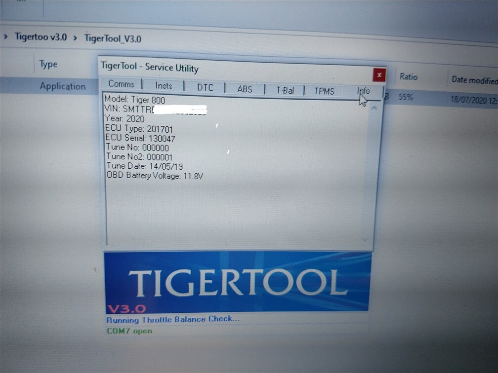

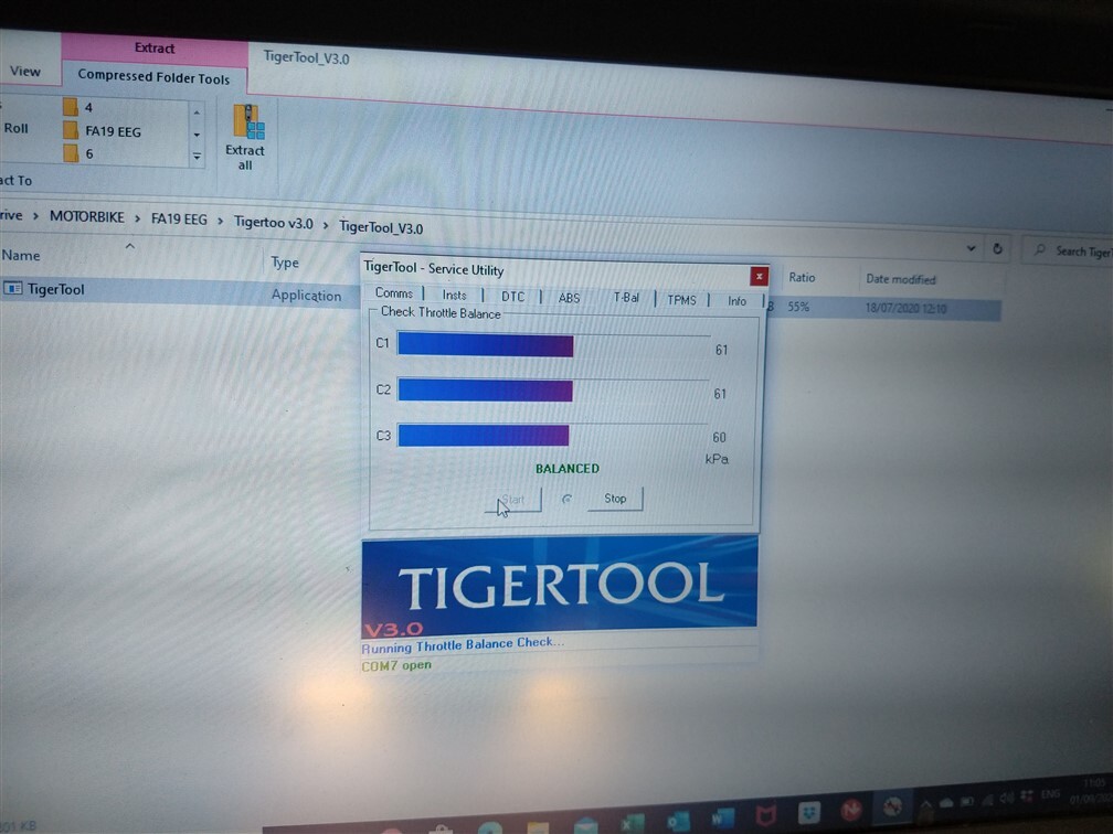

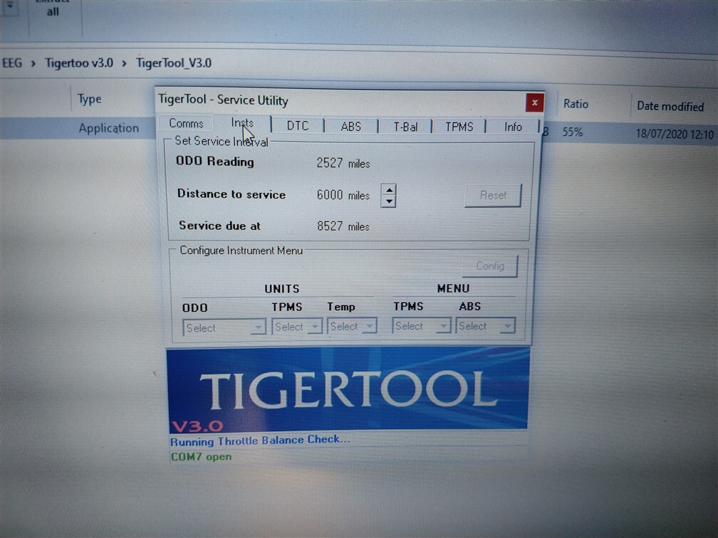

    Used Tigertool V3.0 to check service data. Used a Lenovo X230 and USB bbfly OBD11 diagnostic interface. This allows me to check for error codes, reset service interval and check throttle balance on a running engine. All of this will be printed off and used to help verify (if ever needed) that services were carried out at regular intervals. Same data published on Tiger 800 forum - especially as T800XC who is a member of that forum wrote the SW. Thanks to him I say. Also allows you to check TPMS and ABS.
