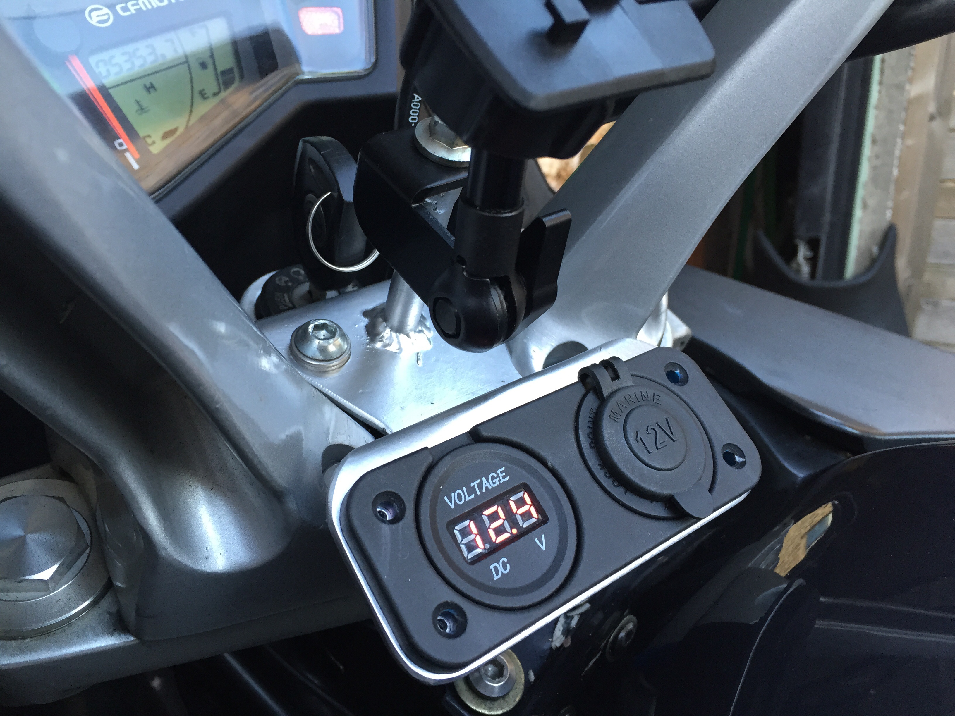

  17. Tigcraft
    2,641
    Hi Creaky just be a little careful with the USB adapters as I've just killed two in a week riding the Alps with a friend.
    I made this contraption to add to my control station
    image.jpg A sat nav/ iPhone mount, a 12v socket and also I combined it with a voltage reg as I loaded the bike with more power hungry items.
    The first usb died as I was running a high consumption iphone sat nav off it on a daily basis although still showed red light then the second one filled with condensation overnight and got erratic then died too. I'm going to pack the third one when I buy one to vaseline and try again.
  18. Creaky
    Creaky Well-Known Member
    Feb 25, 2015
    122
    Nottinghamshire
    Hi Tigcraft
    Thanks for the advice. Will only be using mine as a back up for the occasional charge rather than running accessories from it, though.
