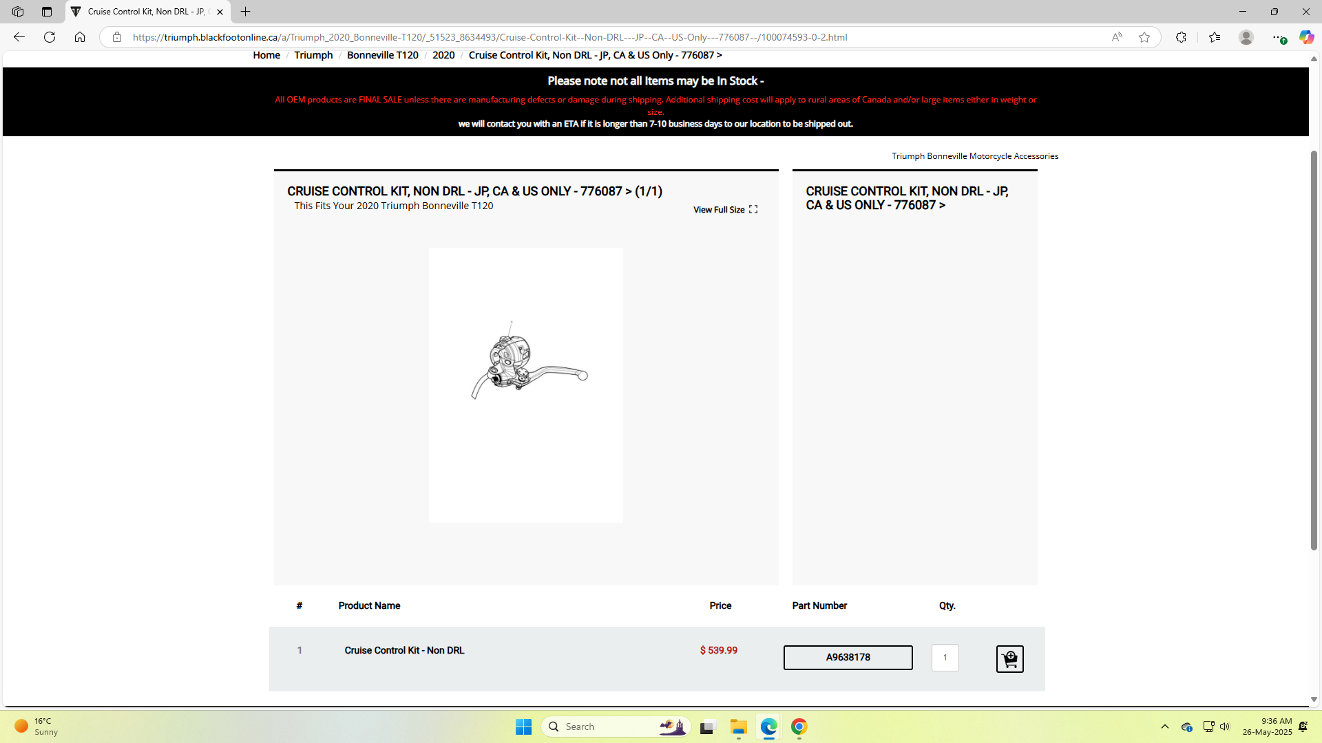

  3. 243jimb
    243jimb Member
    Nov 27, 2018
    12
    Canada
    Canadian pricing.

    Hi @StephenZ
    This comes with the caveat that I'm in the UK, but on the Triumph Instructions website you only get an English option.
    Based on what you’ve told me, you have two choices depending on whether you have DRL on your bike or not. Heated grips aren't going to make a difference as far as I can tell and I'd be surprised if they did.
    The Triumph accessory part numbers are
    A9638178 for a T120 without DRL. And
    A9638179 for a T120 with DRL.
    In both kits you'll get a complete left hand clutch and switch gear assembly and the front half of the right hand controls (i.e. master cylinder and brake lever). The difference in part numbers probably reflects the different connectors needed.
    You can verify this by going to the Triumph Instructions website yourself, its Triumph Instructions.com and entering either of the above part numbers.
    Next step after identifying which kit you need, double check with the parts department of your local Triumph dealer.
    Enjoy your ride:cool:
