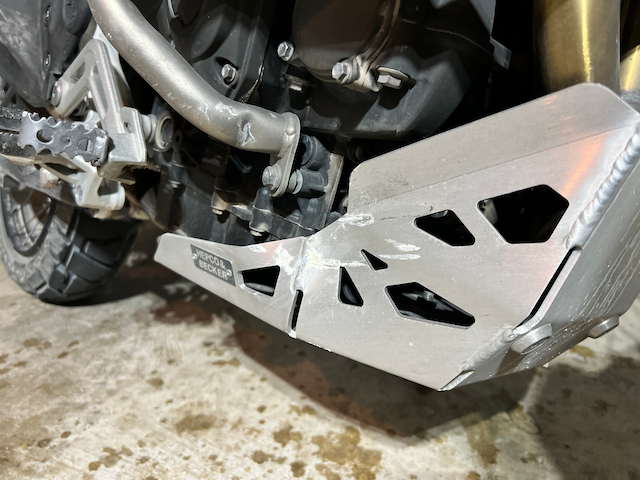

    After finally getting my new Tiger 900 back from the dealership, and having put 1500 or so blacktop miles on it, decided to take it out to the nearby off-road park to put a few proper "I don't just drive to Starbucks" scars on it. After having a blast on it for hours (and putting on a few of those cosmetic scars that I wanted, I got knocked off line at the very top of a steep hill climb on a very rocky trail, and came down fairly hard on the right side of the bike. Upon initial inspection, it looked like the skid plate and the engine guards had done their job; they were both dented but not broken. It looked like I'd bent one of the mounting bolts for the engine guard, so I took a mental note to pull that bolt and replace it when I was home again.

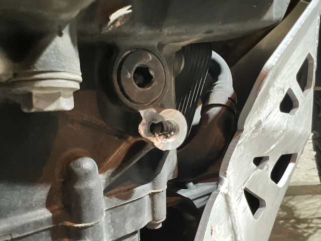

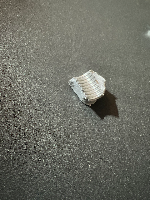

    In my garage the next day, I started to pull the bolt, and began to get an inkling that all was not well when I realized that the bolt was loose enough that I could hand-turn it. Once I'd carefully pulled it all the way out, something fell off of the bike, and got caught in between the skid plate and the engine. Once I fished it out, I found this:
    That's seriously no bueno, I thought. That's aluminum, and it has threads, which means it came off of the engine case. I dismounted the entire set of crash guards, and discovered that what had actually happened was that I'd shattered the lower engine guard mount point on the engine case.
    When I took the bike back to the Triumph dealership, the consensus was that I was looking at an engine case replacement, and a several month wait, and a *lot* of money (insurance would cover it, but still...). Or, the sales director at the dealership said that he knew a really good welder that could probably fix the mount point, but that would probably void a large portion of my warranty. Personally, I consider that mount point breaking to be a design flaw in the bike on Triumph's part. The walls of that mount point are too thin and there is insufficient reinforcement around and behind it to absorb the force of anything beyond a very minor impact. The whole concept of sacrificial parts, and the design around them says that it's the less expensive part that should break before the more expensive part that it protects. Having said that, I am *not* a mechanical engineer, so I might be talking out of my ass here. The engine guard was dented but still usable. If I was going to replace anything it should have been the guard, not the entire engine case.

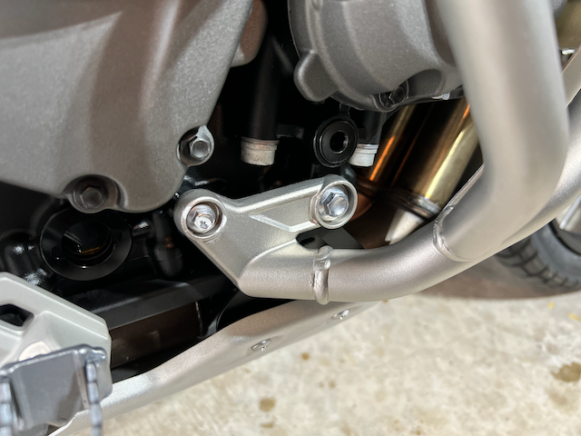

    Yeah, I'd definitely much rather be out there riding than fighting with insurance, and manufacturers and parts availability to get a bike fixed. Especially in this particular situation where if it happened once, I can pretty easily see it happening again, given how (and where) I tend to ride my adv bikes. I just don't have any confidence about the viability of that particular mount point on the 900. All of the other ones seem fine. That one, however... not so much.
    After ~750 miles, I have to say that the new Tiger 1200 Rally Pro is as close to perfect (for me) of any motorcycle that I've ever ridden. It's an utter joy.
    Oh, and the corresponding mount point is *much* better implemented on the 1200 :)
