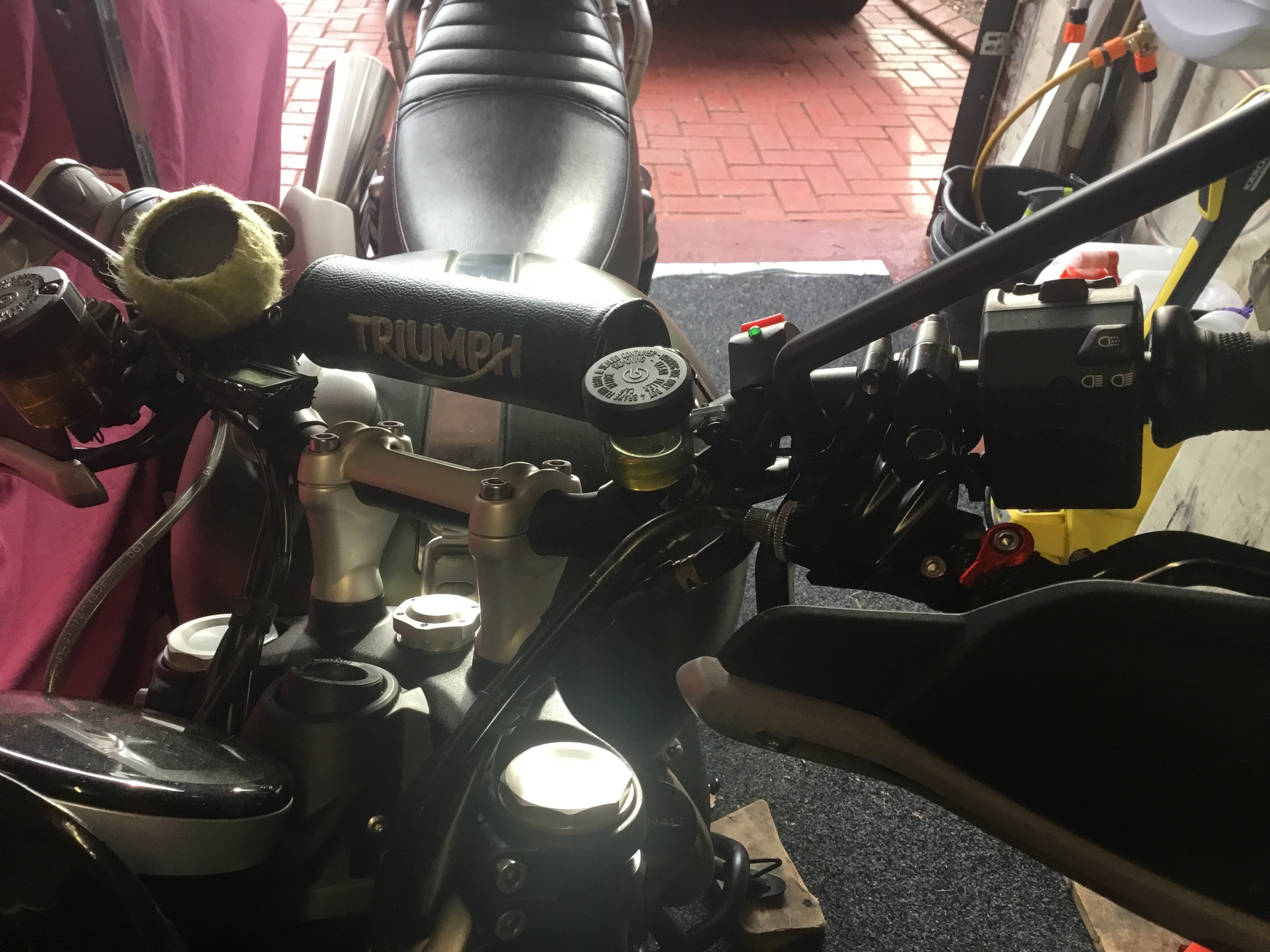

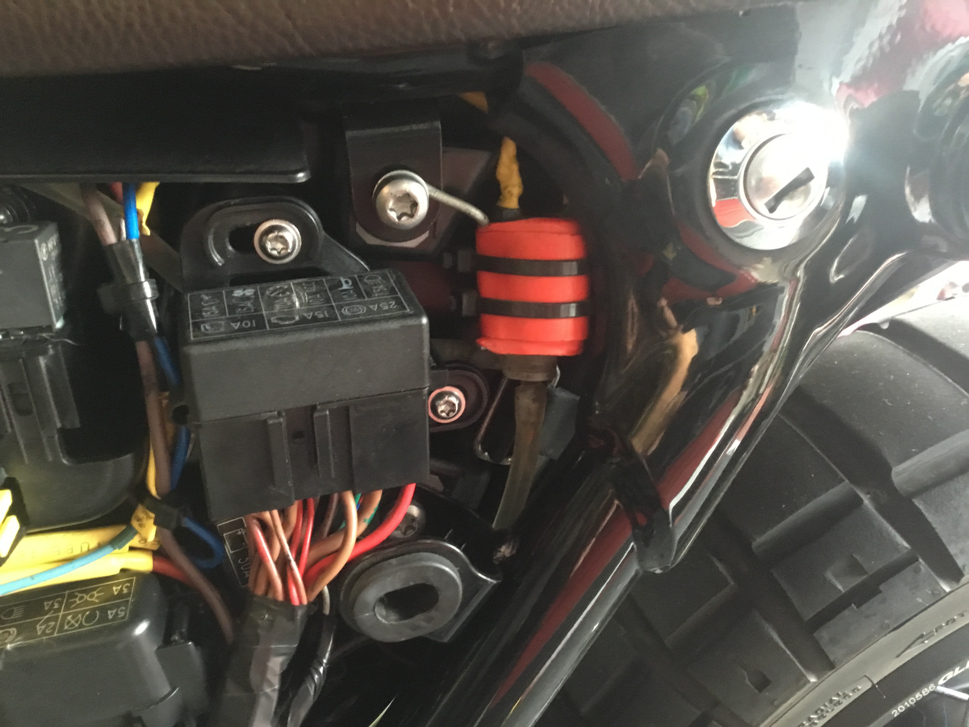

    I have a chain oiler fitted, not a Tutoro but I found the biggest problem was finding somewhere to fit the reservoir. I ended up with a handlebar mounted, hydraulic clutch type and routed the tube under the tank to a solenoid valve behind a side panel and then down to the rear sprocket.

  4. Pegscraper
    Pegscraper Elite Member
    Jun 12, 2020
    3,854
    Not being able to find an off the shelf offering suitable I cobbled one together from scratch. A reservoir, some tubing, a solenoid valve and a small aquarium tap to regulate flow. The whole thing probably came in under £20.
