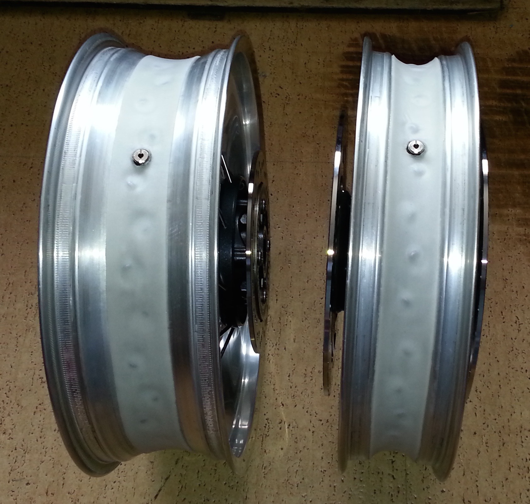

    One of the first mods I did to my Thruxton S was tubeless conversion using the well documented 3M tape method. The method is covered in detail on the Triumph Rat forum is you do a it of searching. I have about 4,000 km on my wheels now with no problems and the peace of mind that tubeless brings - plus I carry a repair kit under the seat which I could not do with tubed tyres.

    Good. I had a problem last year with a slow leak from the bead on the rear wheel. Took the tyre off and it seemed to be caused by the very rough finish of the rim. Gave the rim a a really good sand and polish and its been fine. Front tyre has been perfect - now have about 5000km on it.

    Do you mean like a tyre pando type stuff? No. it is unnecessary and makes a mess. It also centrifuges away from the wheel, as its designed to seal the inner surface of the tyre.
    I used Loctite on the spokes and nipples before applying the tape and then found out that it does not work on aluminium! I only used it as a bit of 'belt and braces' insurance.
    The wheel does need to be well cleaned. I used acetone to clean, then isopropyl to finish as it is recommended by 3M. The tape is easy to apply but like everything it can get a bit tricky first time.
    The end of the tape either needs to be butted with a patch over the join, or overlapped in the direction of rotation.

    Got the local motorcycle shop to take the tyres off as breaking the bead can be a problem. Re-fitted myself but the rear was a bit of a struggle due to the very shallow well, the width of the tyre and the rigidity of modern tyre carcasses.

    Yes. Give them a good wipe, use a suitable lube, leave the valve out and give them a blast with compressed air and they should pop on. The tyres are stiff enough that they tend to sit against the bead when first fitted.
