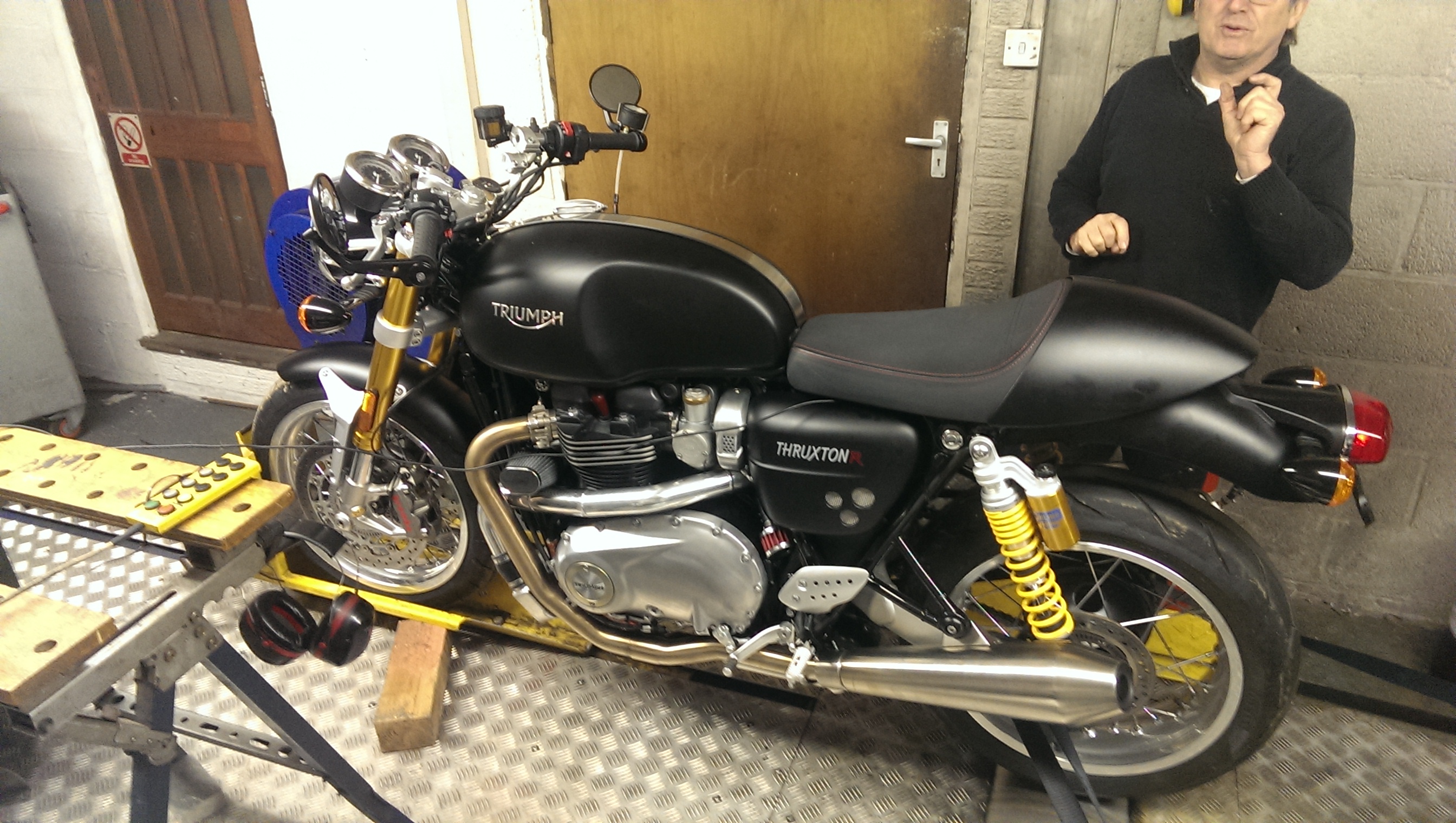

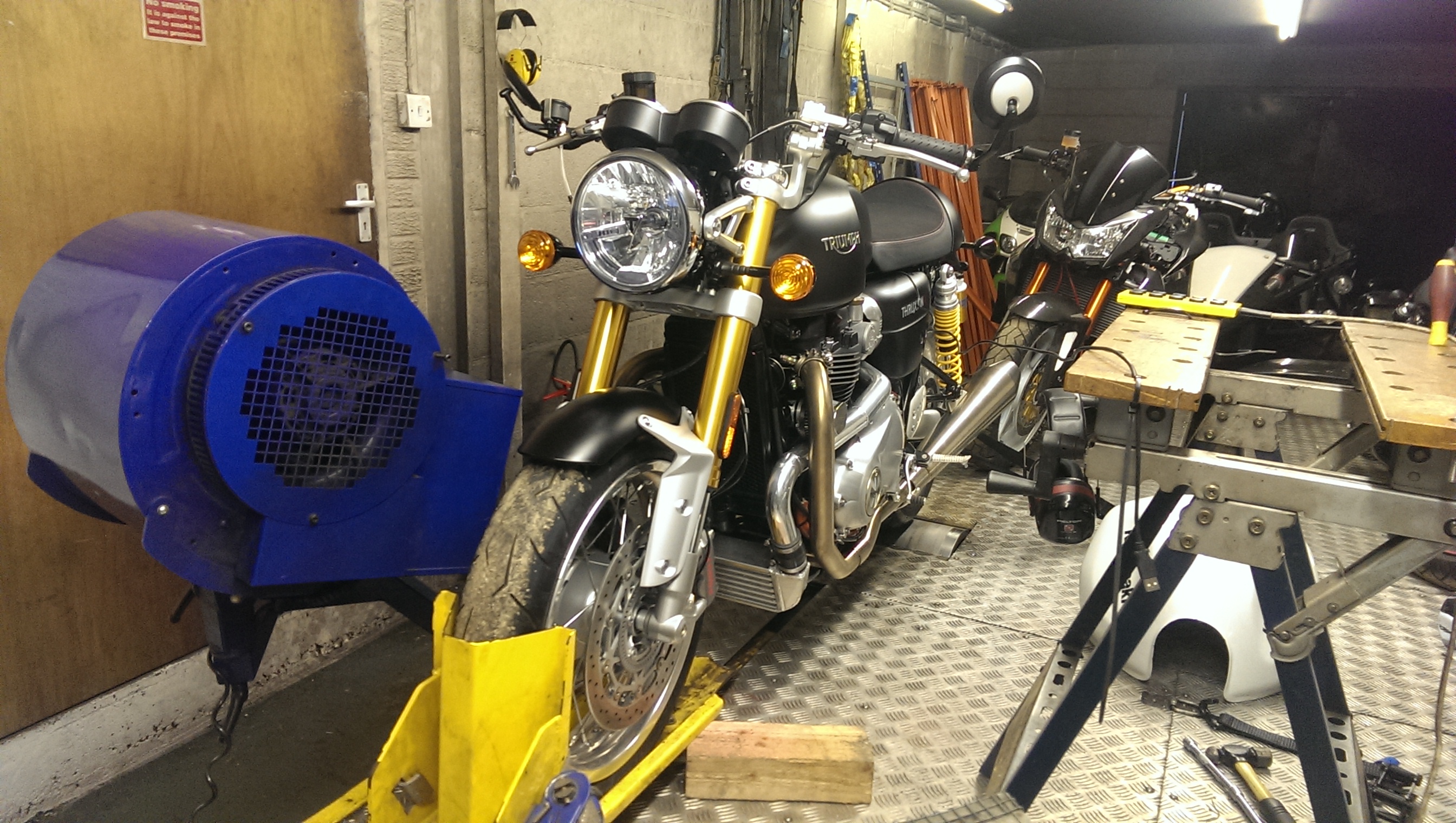

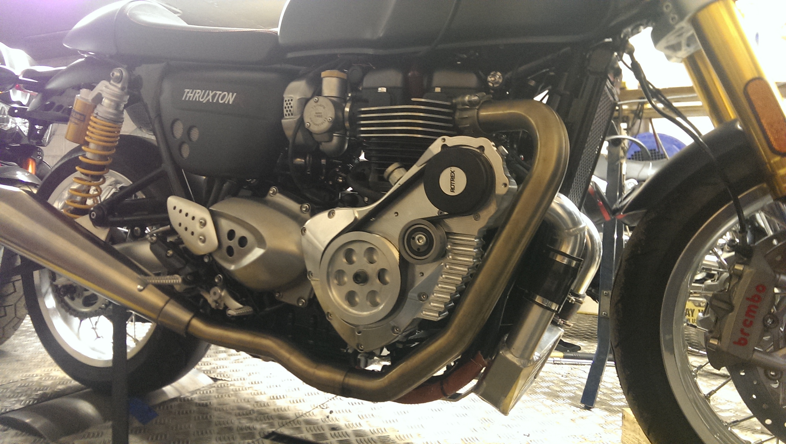

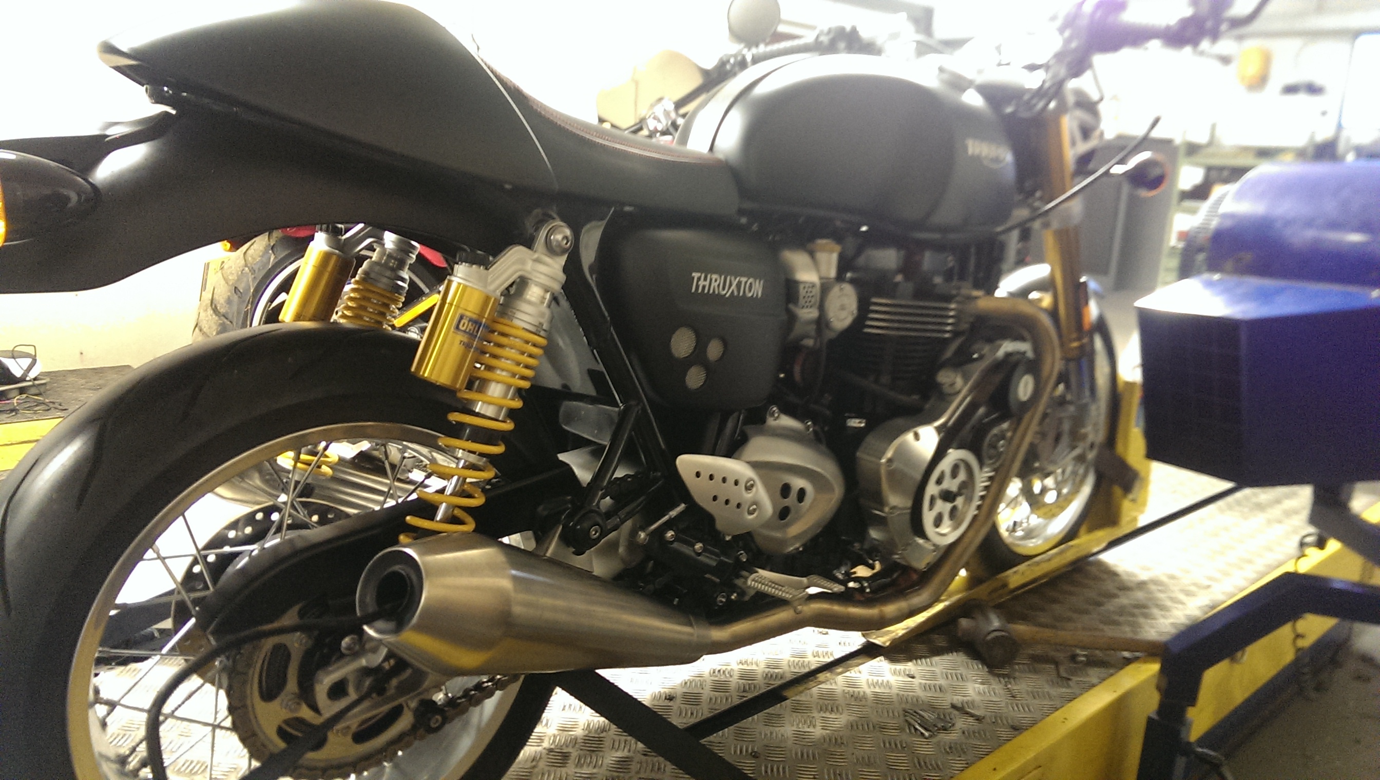

    OK another update.....TTS have been dragging their feet with this.
    Initially I let TTS have the bike so they could use it to have some header pipes made up by Scorpion Exhausts for the Supercharger kit they were doing which is a story in itself.
    While it was there they offered to fit the kit for free as they needed a bike to do a tune on for the Power Commander to send out with the kit, so I reluctantly agreed as a big part of this for me was fitting the supercharger myself. But having said that I would have had to take the bike and have it mapped so it seemed the best thing for both TTS and me to let them fit it and map the bike down there...
    On the two bikes they did for Triumph last year Triumph let them have access to the ECU to do the mapping but they would not give them the access to do it for the Supercharger kits so they have to use a PC-V.
    So last week took a drive down there unannounced to see what was going on, the bike was sitting on the dyno with the supercharger installed and had been partially dynoed but he had come across a problem with the air pressure sensor triggering a fault code due to the difference in manifold air pressure produced by supercharger. To be honest I was a little pissed off as I had expected any issues like this would have been ironed out on the two bikes they did for Triumph...but their ya go!
    While I was there he asked me if they could take the bike to the motorcycle show in London this weekend, I agreed to this as long as it was back with me at the end of next week...
    So as it stands I am expecting the bike delivered back to me by Thursday evening of next week (23rd Feb)
    Here are a couple of picures I took while I was there last week.....A couple of things have changed sinse then, the intercooler and pipework are black along with the outer supercharger belt cover
