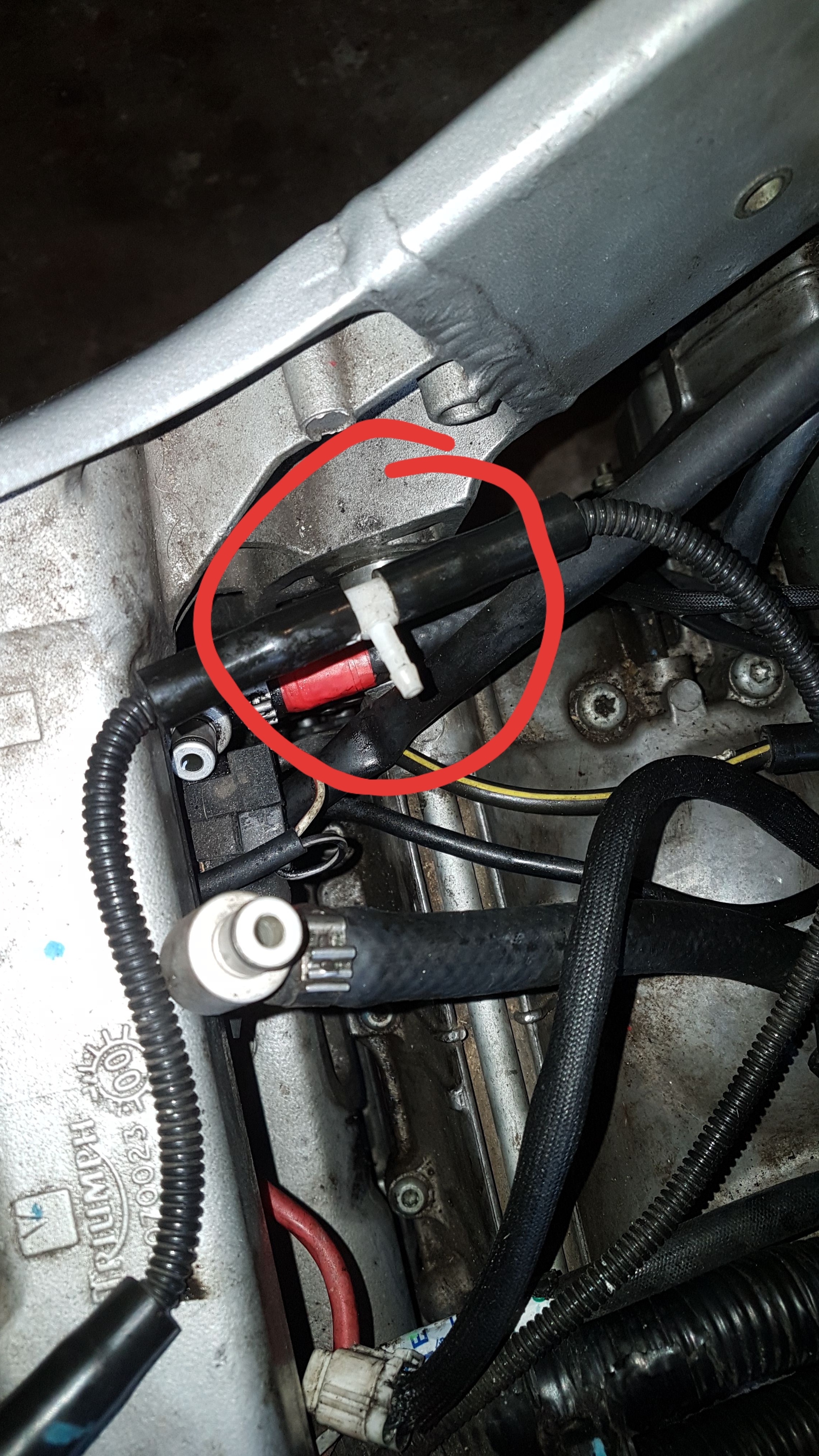

    Hi, recently swapped out my engine for a second hand one (original engine had no compression on cylinder one and was burning oil and water)
    The replacement engine will start but then stalls out and won't start for a while, thinking fuel but a bit lost, (even considered trying to swap the fuel cables around as they had no markings on them and wondered if they were on backwards, although I believe they're correct, right hand pipe to red connector)
    All cables are connected (I believe correctly) apart from one air pipe running to the airbox which has a 'T' coming off it I can't work out where it goes, (see pic)
    Any advice gratefully recieved

    Hi, Cheers for the repky, yes there is one of them, but this pipe runs from the airbox to the ecu at the back of the bike, but has a T joint about 6 inches from the airbox, I really can't see what it joins too?
  5. freck
    freck Elite Member
    May 4, 2017
    1,719
    Preston, Lancs, UK
    That’ll be the barometric pressure pipe to give the ECU a reading I think.
    On my 955 there’s no T in that pipe, it just goes straight between the ECU to an elbow which pushes into a grommet on the back of the airbox.
    I can’t see that it’ll make a difference if it is that.

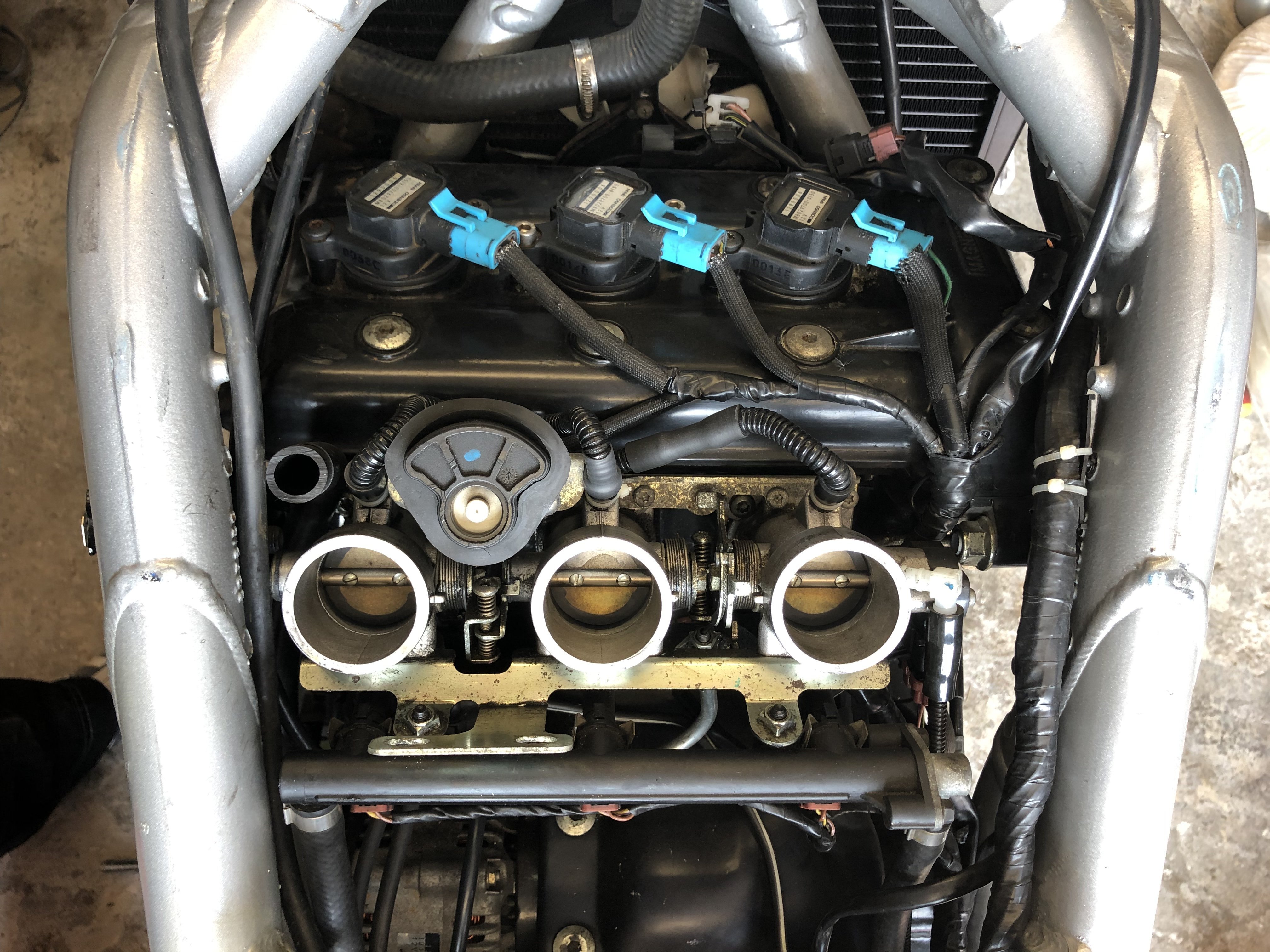

    Did you do a throttle body balance when you’d put it all together?

    No, just doing some reading it appears I should reset the TPS is this the same thing?
  7. freck
    freck Elite Member
    May 4, 2017
    1,719
    Preston, Lancs, UK
    No, you do the TPS reset after doing a TB balance, and then a fuel adaptation reset.
    You’ll need a set of vacuum gauges to do the balance.
  8. Max_taz
    Max_taz Member
    Jul 15, 2020
    39
    United kingdom
    Just read up on it, will sort it tomorrow, thanks for the assistance, this is my first efi engine and I didn't think I'd be using my balancer on it, cheers max

    Presuming this engine has MAP sensor if the tube is going to the air-box which is not the best position for MAP as its subject to fluctuations from three cylinders (best fitted to a common plenum ) so fueling will be a average of the three cylinders MAP probably explains the reputation for dodgy running.
    Fueling should be basically MAP vacuum vs TPS vs RPM so once you have the intakes balanced and TPS setting correct you should be good to go...idle control will be dependent on TPS being set correctly.
  11. Max_taz
    Max_taz Member
    Jul 15, 2020
    39
    United kingdom
    Thanks for all your help, balanced and reset tps and it's running like a dream
