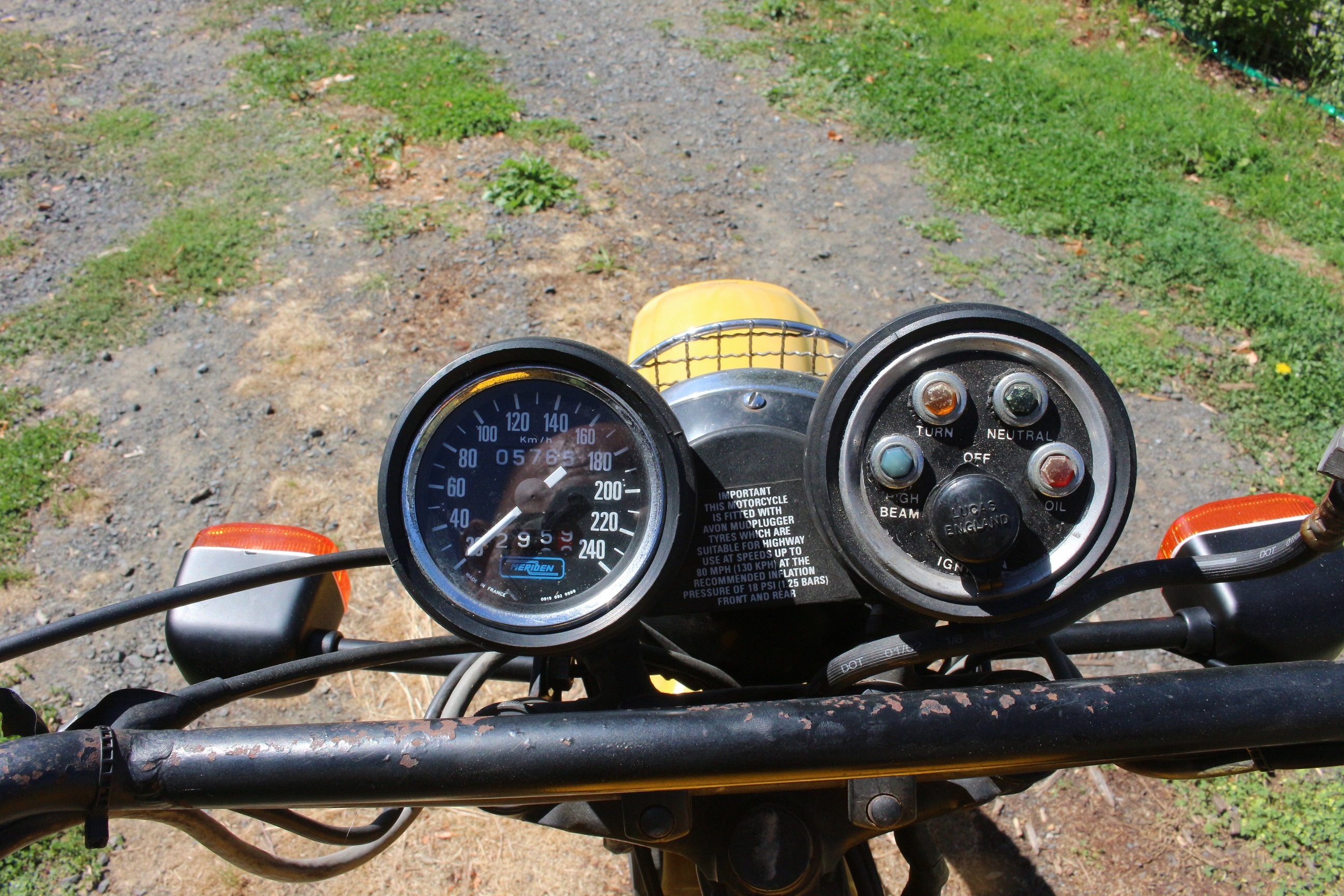

    Decided time to move it on.
  12. joe mc donald
    15,824
    Keve
    It sure is a lovely piece of machinery. I love it. If we were closer i would love to have it of of you. Bet its quite rare now a days.
    Joe
