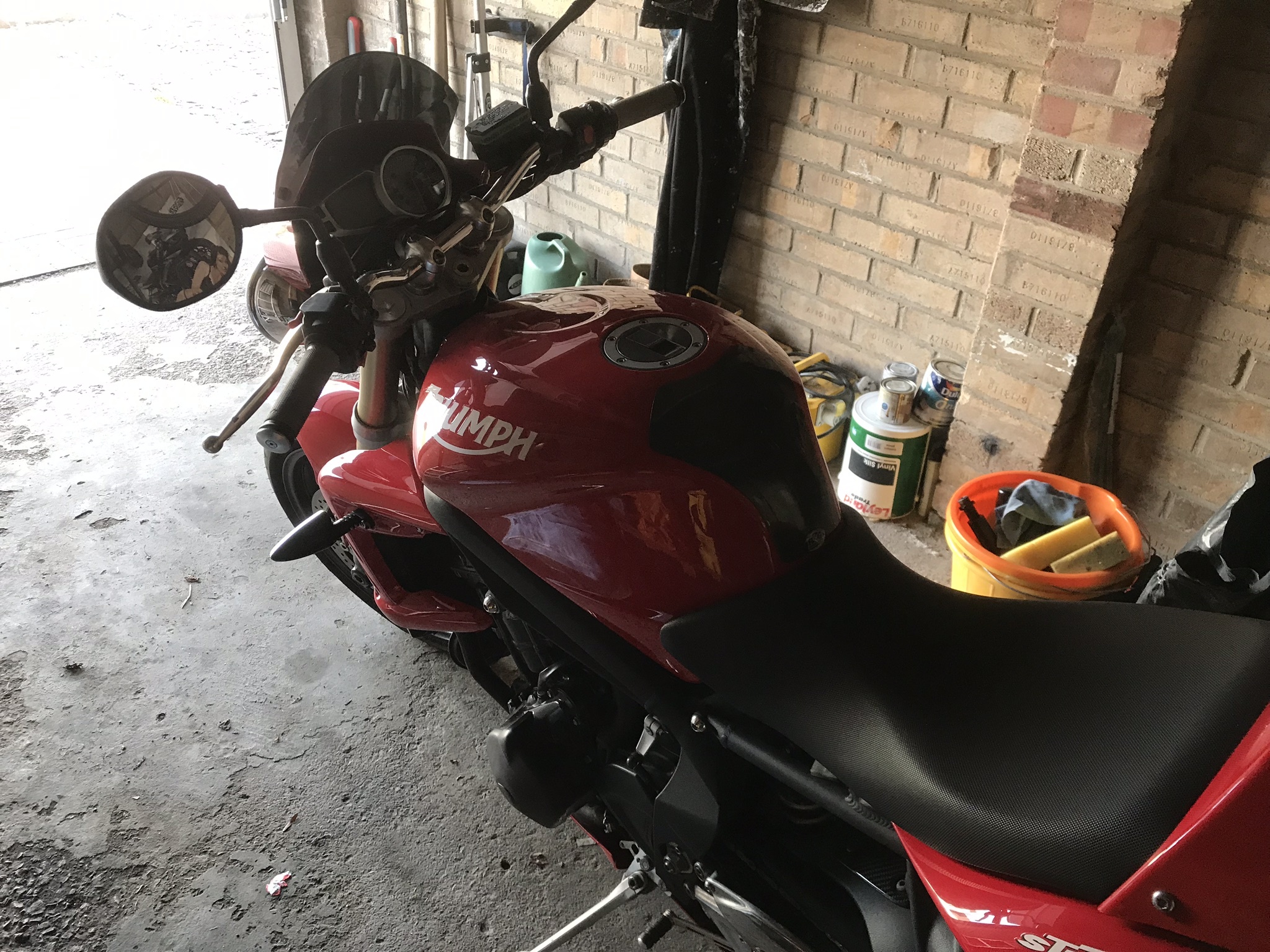

    Hi can anyone help, I have the old shape street triple and it is bad starting from cold. Has new fuel in tank, I have to open the throttle a little and press start button 6or7 times, it cuts out then starts then runs ok. Any suggestions?

  4. Dave Garrett
    Dave Garrett New Member
    Mar 11, 2019
    6
    North East
    Hi all, thanks for the replies. Here is the extra info
    Had the bike 4 year, it’s an 11 plate.
    It is a new problem, had super unleaded in over the winter but it was fine before that. I have attached a pic of the bike now.

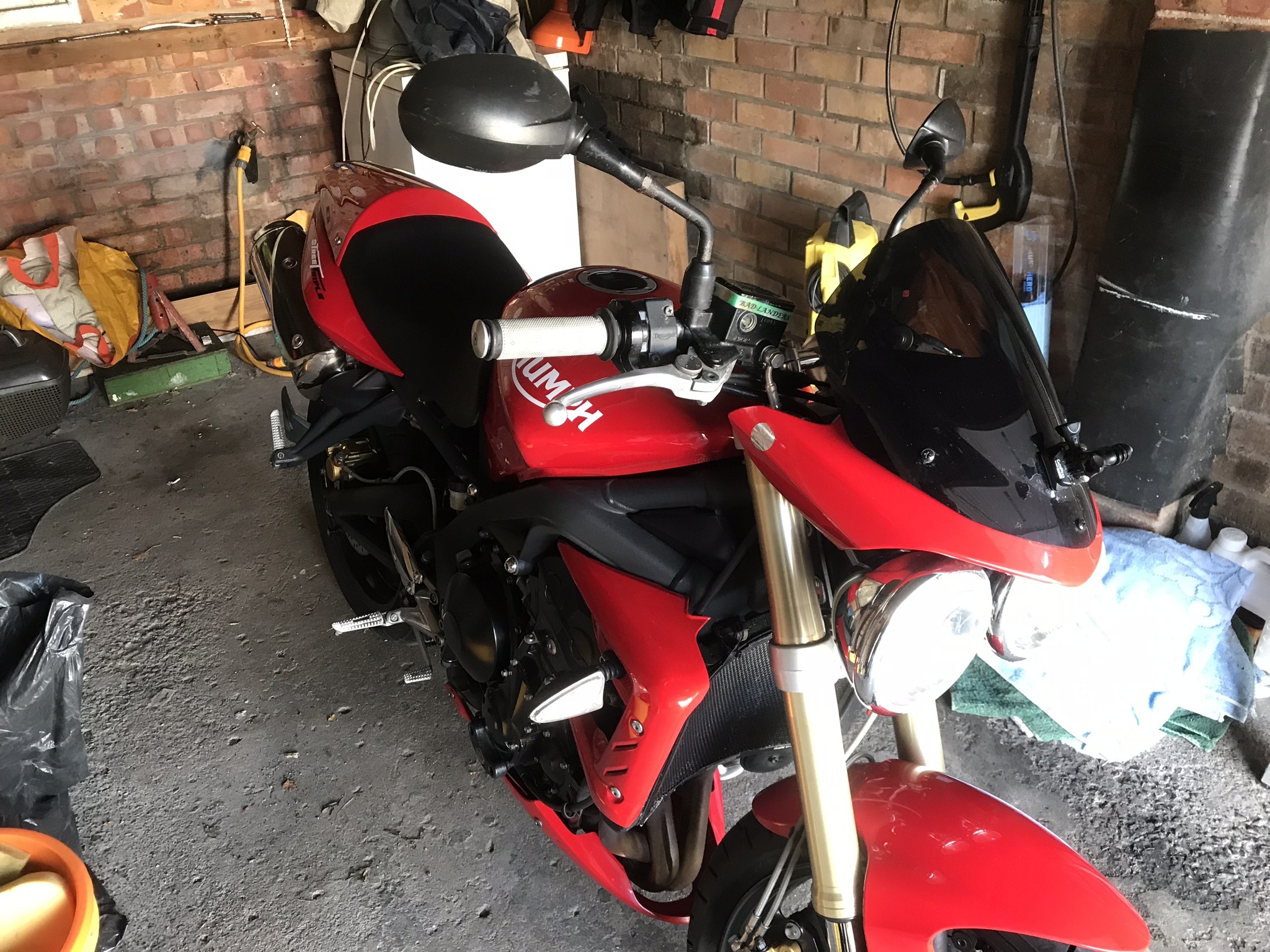

  7. Dave Garrett
    Mar 11, 2019
    6
    North East
