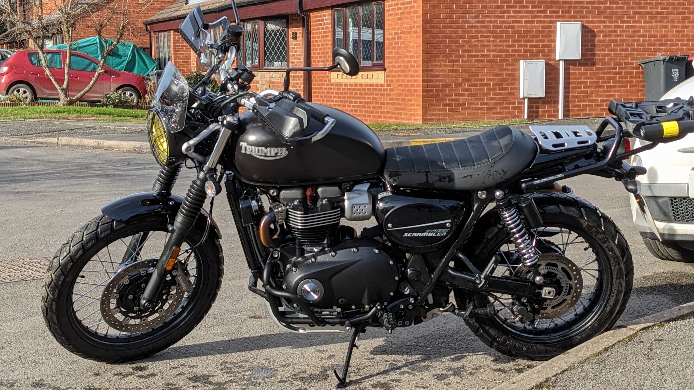

    Hi All
    I may have missed the specific sizes of the bolts in the digital Haynes manual, but I can't locate what size the bolts should be (even though I know that they are tightened to 5nm!)
    I'm attempting to swap my 12 litre fuel tank for a 14.5 litre fuel tank from a T120 (I read on one of the links that they are compatible). This may go a long way to reducing my range anxiety!
    I have a tank and I'm looking at getting a complete pump assembly (apart from the bolts). I think I've seen pictures of bolts with the lock tight paint on, but I can't be sure.
    I'd be very grateful if anyone could help me out.

    Thanks SprintDave. Much appreciated, I've tried that and I think it's M4x5mm s/s. Thanks again...

    Update: the chap who sold it to me, actually included the bolts when I've enquired about the size and... they're M5x14mm stainless steel, not M4

    Latest update: T120 tank fitted!
