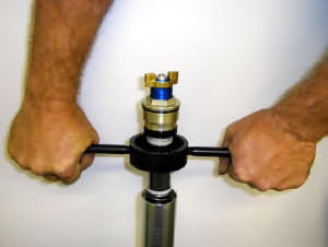

    I should be changing the oil in the forks soon, and I have a question.
    Cos I'm not changing the seal, only the oil, do I need to undo the lock nut, - this needs a special tool - ( to hold tube,10. down, to access the lock nut,{ which looks like it could be knocked up}) or can I just tip the oil out at that stage?

    When I did my 2010 Speed Triple oil, I took out the spring and filled it to the correct level before putting the springs in.
    I got the tools off eBay and Squaredeals
    Once you have done it it is quite easy, in fact I wasn't happy with the weight of oil I used so quickly took them both apart, drained the oil and got them both back on the bike inside an hour
    I am using an Abba Skylight which makes thinks much easier.
    I would suggest get the rights tools, it makes things so much easier
    By the way, when I refilled the oil in the legs I used a mechanical ruler to the top of the inside leg to get the right air gap

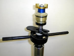

    The cap (part 3) is easy as long as you have the right sized spanner. Loosen the top pinch bolts and loosen them in situ
    Then with the legs off the bike you can undo them by hand, there shouldn't be any spring pressure that would cause the cap to fly off ( completely unwind the preload before starting)
    You would need the tool pushes the tube down as at the 4min mark you highlighted in the video, I used some thin rope and push this down with my foot so I can slide in the tool to hold the spring compressed.

    Here ya go duck, an assistant is needed to compress the spring using the tool and to either undo the lock nut or place the clip to hold the tool and spring down.

    Word to the wise, the lock nut (10mm size IIRC) needs to be an exact distance from the top of the thread
    This distance determines the rebound/compression valve adjustment, get it wrong and your adjustment ability will be effected. Too short and the adjuster will be fully engaged, too long and you won't be able to wind in the adjustment all the way
    On my 2010 Speed Triple the distance needs to be 10.5mm
    I'm referring to the nut that the slide in tool sits under and when loosened enables the top cap part to be unscrewed

    Have you had a look at the video posted above, at 4 minutes in they are shown using a similar, but more expensive tool to get at the lock nut.
