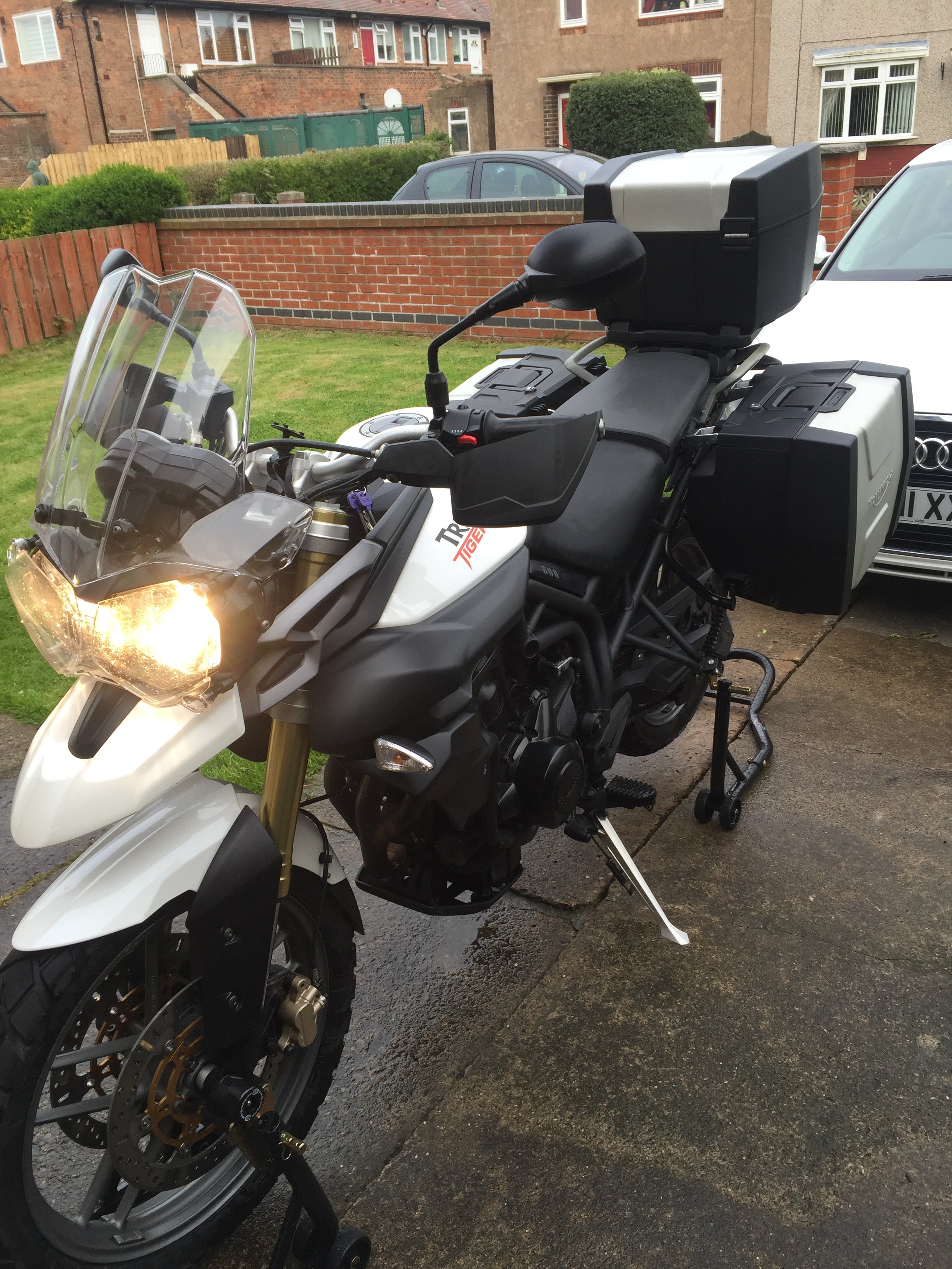

    Finally got my triumph side panniers fitted after having to drill and re tap the thread for the mount fixing kit. Very pleased with the end result.

    Looks the part!

    Made the bike look like a big adventure bike now. Can't wait to get some trips organised. Of to the lakes on Saturday should be good.

    Always have preload on top weight setting as I'm always travelling with a pillion when out as my partner goes everywhere I go on the bike preety much.
    And the plastic screws under the frame on the bike where not budging. Had to snap the flat plastic caps of. Drill the plastic thread that remains in the holes and then put a tap through them. They where full of crap for some new bolts for the fixing kit as the ones it came with had seen better days.
    Took around 3 hours from start to finish.
