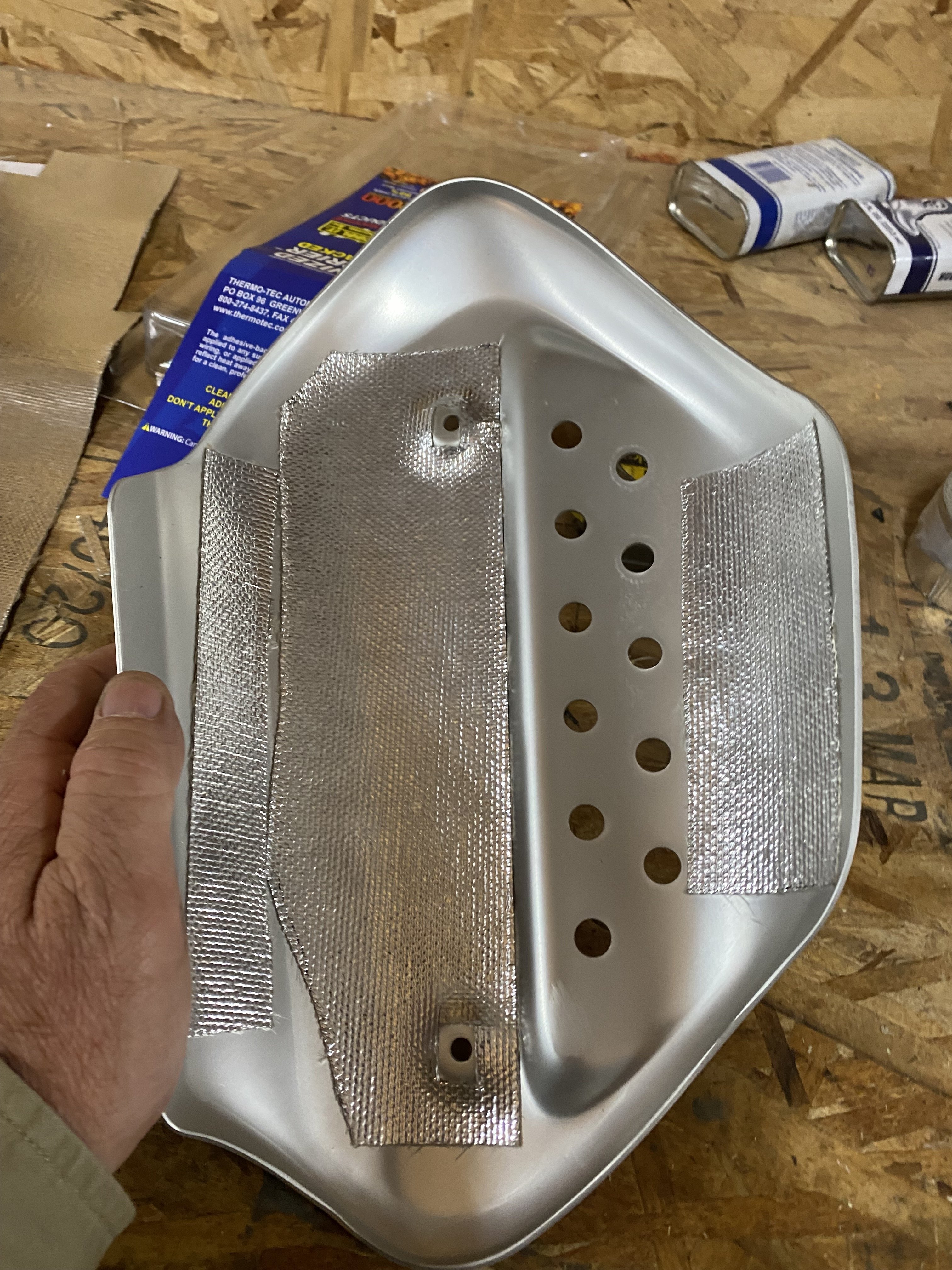

    Obviously, the single biggest complaint on this otherwise amazing motorcycle has been the heat issue on your right leg near the exhaust and catalytic converter.
    My experience is the heat issue is really only unmanageable when it is hot and you are going slow or stuck in traffic, but let me be clear - it is really bad under those circumstances.

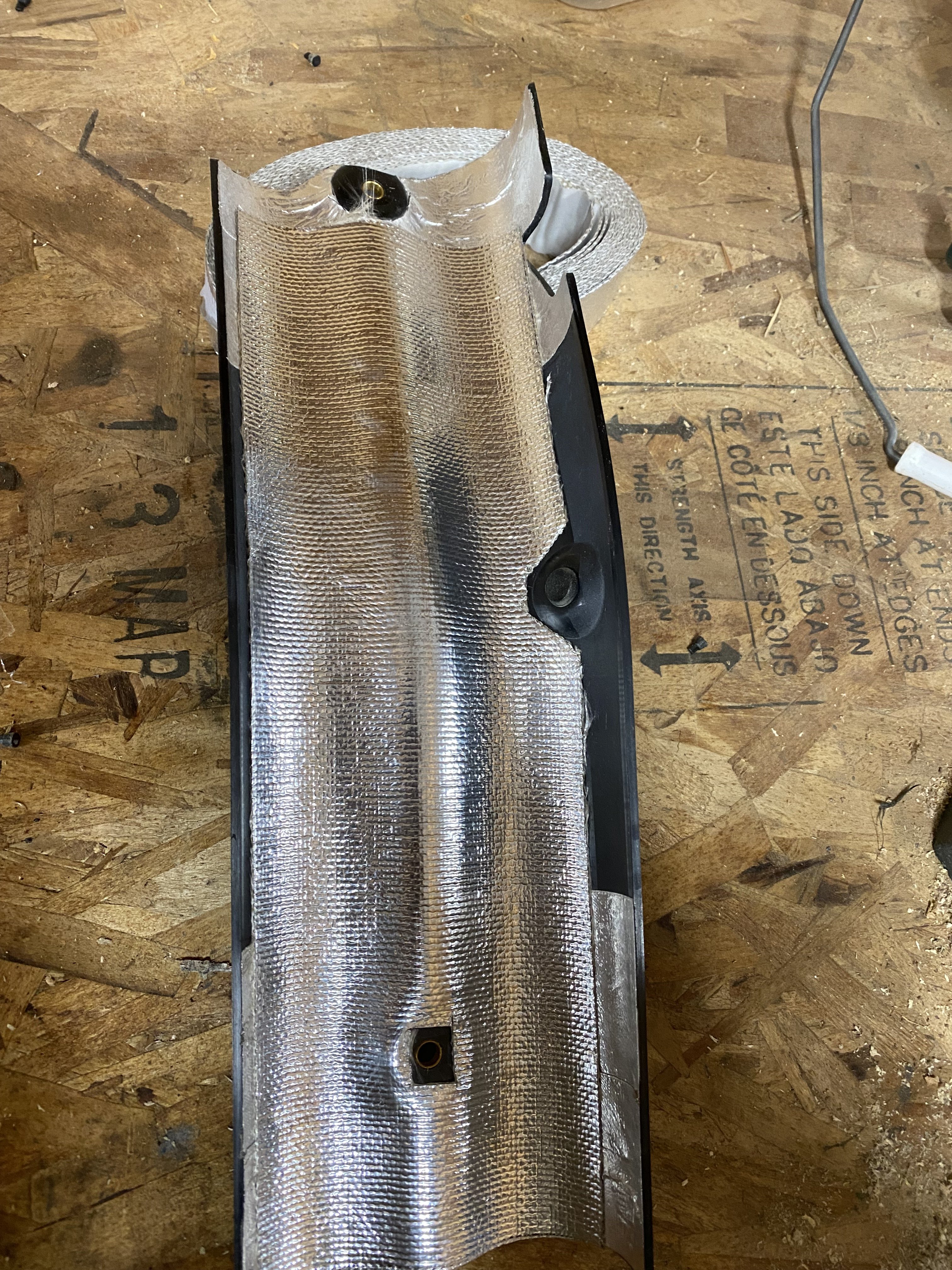

    It is my intent this next spring to de-cat the bike with a four seasons pipe, but I did add some reflective exhaust tape on the inside of all three heat shield. I have heard mixed results on this process but I will update this post when I get on the road and try it out.
    Comments ?

    Hope it works for you! I cut the cat out of mine when I had it in an attempt to reduce the heat. I didn't feel any noticeable difference though :confused:

    Good info, let me be clear no matter if Triumph acknowledges the problem or not it is a serious problem.
    I rarely ride my bike in town in traffic so it does not really effect me, but the two times I did this summer it was a serious problem. Sorry the bike did not work out for you - I really have enjoyed mine in spite of the heat issue.
