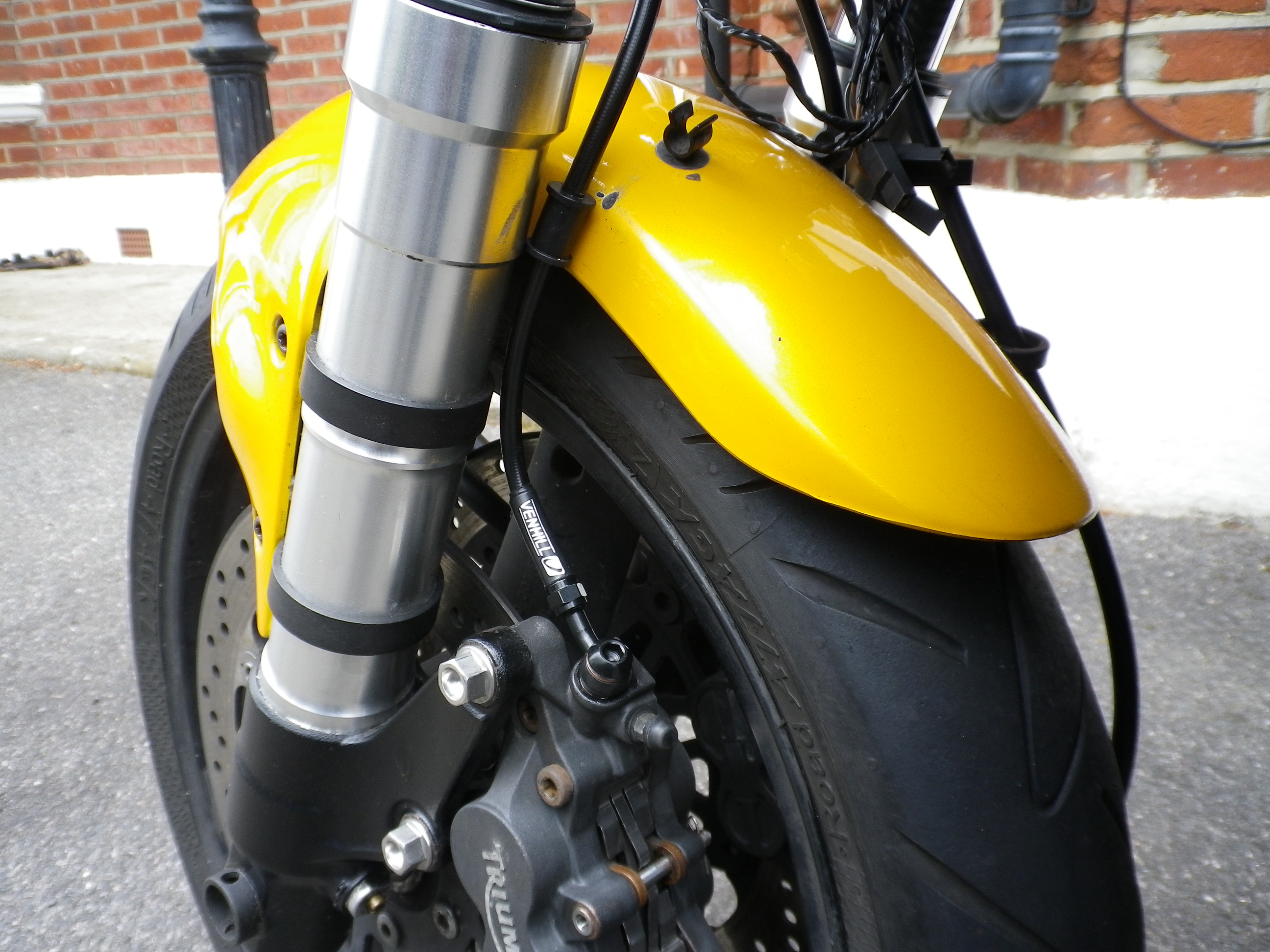

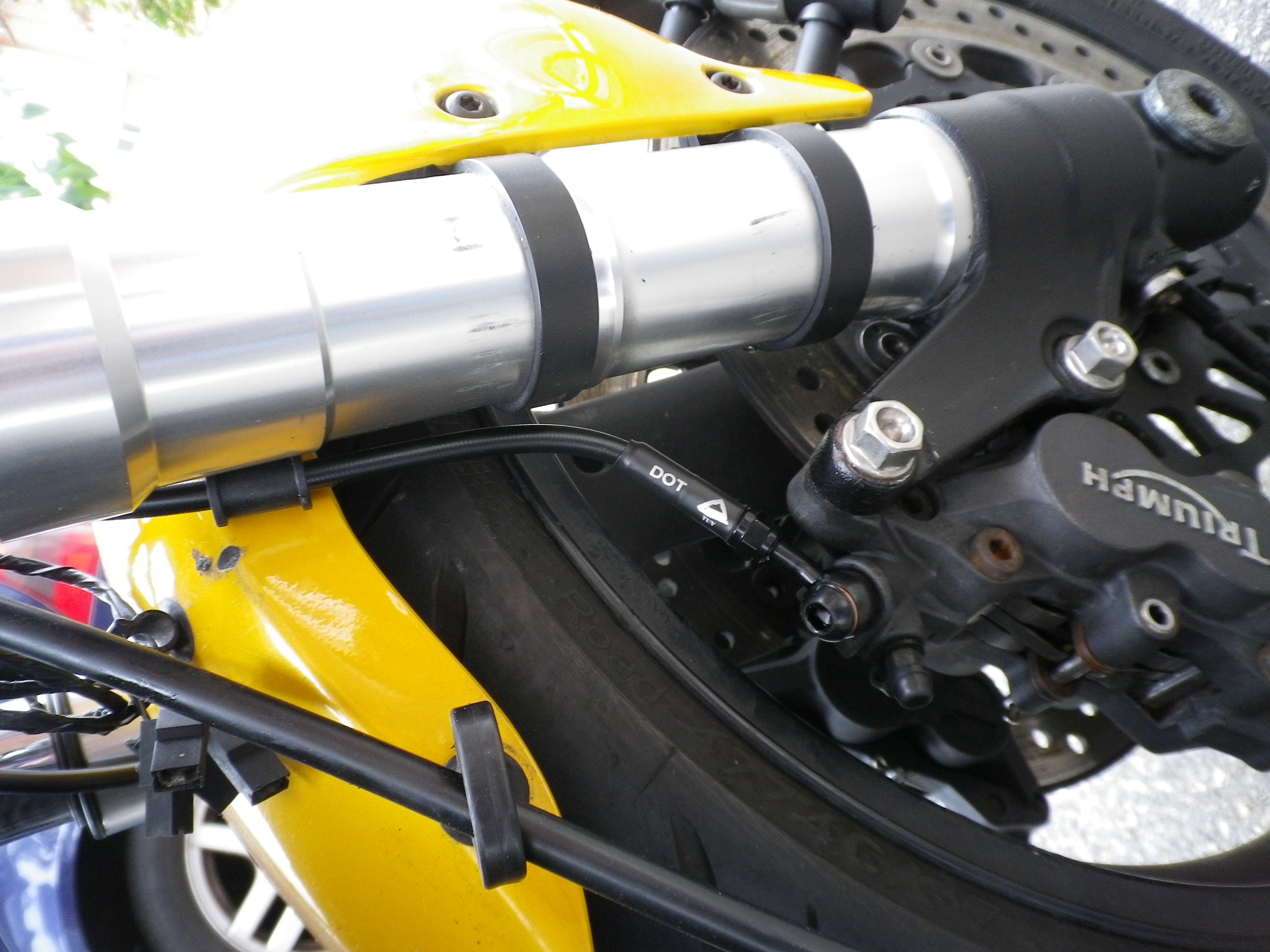

    Hi Trying to fit Venhill front brake lines with the race set up to my 955. The problem I have is the brake line lowers seem to being forced between the fork leg and mudguard.The stiff part close to banjo bolt seems too long. In past with other bikes there`s always been a bit of distance between brakelines and fork leg/ mudguard.
    I have position rubber grommet to keep it away slightly but theres a fare IMGP4831.JPG bit of pressure there
    Just wondering if anyone has a picture of their race set up iI IMGP4830.JPG IMGP4831.JPG I can compare mine to.
    Cheers

    Good update on this both UP THE SHOP bike shop are sending two different degrees of bend to sort out closeness to forks etc and then return ones i don`t use and Venhill themselves e-mailed me aswell and they are also going to send some different banjo ends to try. Best customer service I`ve seen in a long time. Fingers crossed between the two it gets sorted.

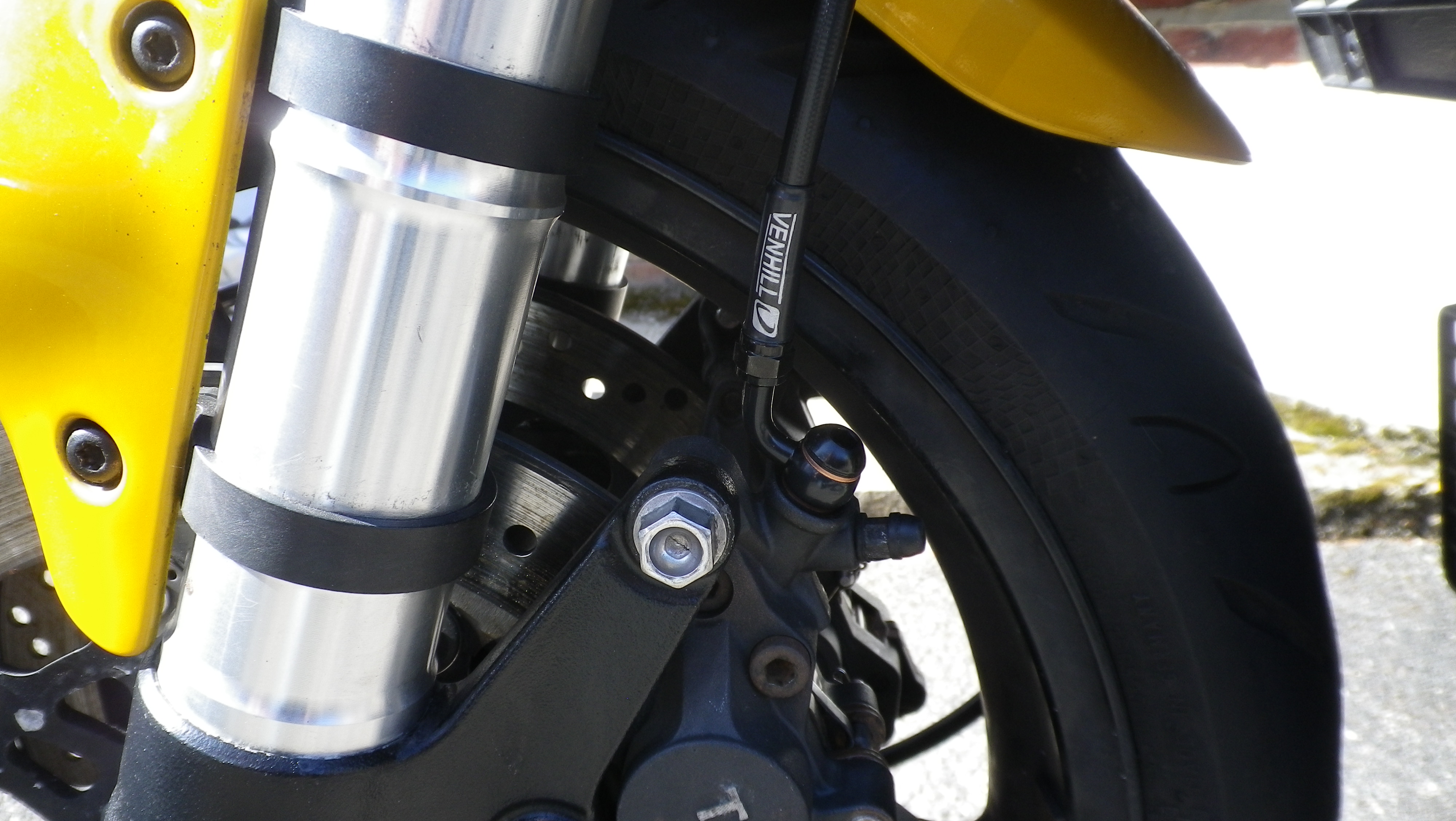

    New banjos fitted and routing is much better. credit to Up The Shop for customer service and getting parts to me quickly.
    Few more bits todo,which shouldarrive next week IMGP4841.JPG and the old girls a goer
