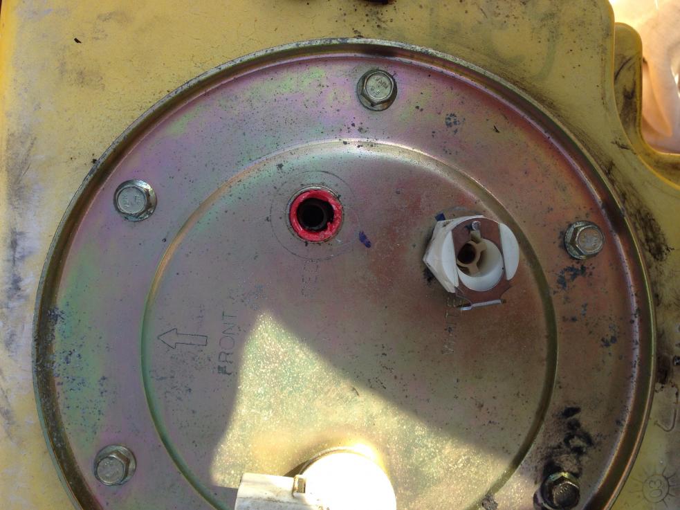

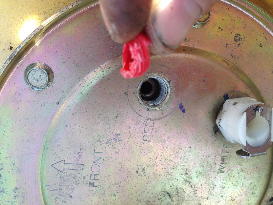

    Hi there,
    There is a common problem with the Daytona 600 in which the fuel hose connectors which attach to the metal plate on the bottom of the fuel pump break. This is because they are cheap plastic which goes brittle and lets face it, shouldnt be there in the first place.
    So I have been doing a spark plug change (my first time) and upon lifting the tank the connector broke and fuel went everywhere. So I took the tank to my local bike mechanic who said to buy a fuel pump from ebay (second hand from a breakers) for £65 and just use that as they couldnt fix the plastic bit which goes into the plate/pump.
    I also called triumph so said for £18 for the 1 connector and then £60 labour they can scrape out the plastic which is basically threaded and glued into a metal thread on the plate itself. And then bond the new connector in place. So for £68 ish they could do that.
    The thing is I dont want an old connector, or a new plastic one, I would like a metal one. Does anyone know where I can get this part from or has anyone got an suggestions to help me out please.
    Also I was told that there is a fuel filter for the daytona 600 which from triumph is really expensive but a compatible one can be bought from europarts for far cheaper, can anyone suggest a good cheapish fuel filter for me?
    Here are some pictures to show you, its the red connectors has broken away from the metal plate:
  2. slick-rick
    slick-rick Guest
    Please note the red connector has now fully snapped off and all you see is the hole and the plastic threaded part still glued in the hole there.
    Thanks for your help.

    @Paulie and @PeterH thank you both for your advice. I checked it over with Triumph in the UK and the recall doesnt apply here unfortunately. I wasn't confident to do this job myself, although I got most of the plastic out I was worried about damaging the thread. I took the tank over to triumph and they charged me £58 (I bartered them down haha) to remove the plastic, whack in a new connector and add a fuel filter which I purchased separately. Although not ideal because the connectors are still plastic its solved the problem for a couple more years hopefully.
    Thanks again for your advice!

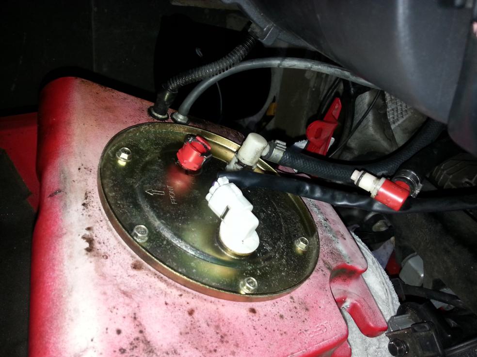

    Found this thread very helpful I had an issue with the fuel cap drain being blocked so lifted the tank removed and unblocked the nipple just putting the tank back down and SNAP the red clip went, I ordered a new one from triumph £33.50 posted ouch!!!! But then found this thread with the metal ones so going to order those I think? Here's a few pics of the part before and after I removed it it wasn't the easiest think to remove but got there in the end!!

    Hi
    I've just done the exact same thing to my Daytona 600 - did you use any special techniques to remove it?
    Chris

    Follow the link in Paulie's post or use a heated screwdriver, then depending if your UK or States follow the links to order metal fittings, resist the urge to replace with plastic items....

    I just used some very small screwdrivers and a thin blade trying to avoid the threads best I could the metal replacement went in fine though heres an eBay link to the one I bought but you can get them a bit cheaper but I went for the better looking quality one which when arrived was very sturdy and well made! Hope this helps!!

    All fixed now - scraped out plastic connectors, put in new metal ones, replaced the O rings on the fuel line plugs, and have nice new shiny connectors. Took some time, but definitely worth it.
