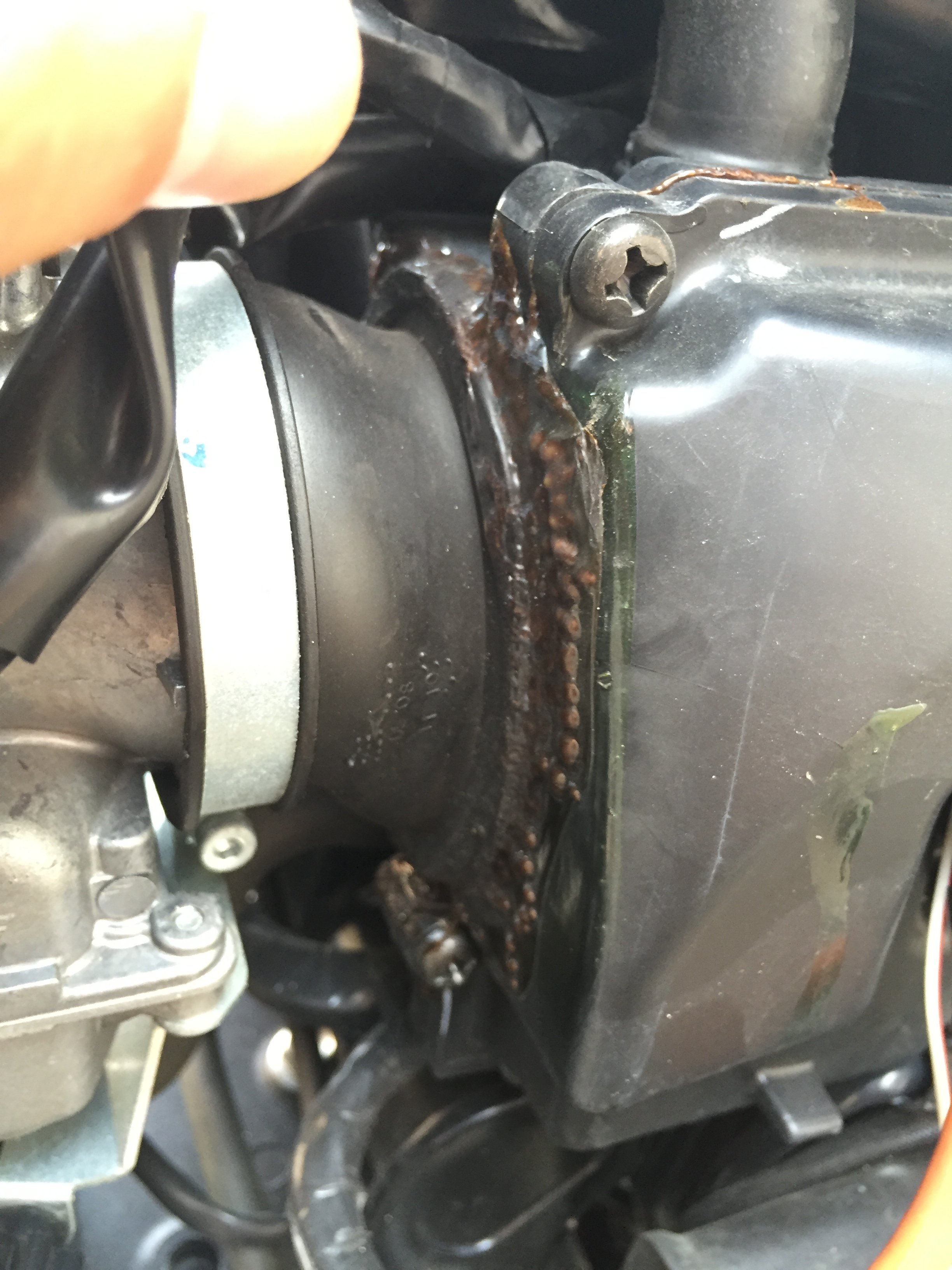

Hello: I have a 2011 Bonneville SE that started running poorly all of a sudden. I was on my way home when it started running rough, missing and idling poorly. It starts fine and runs ok for a few seconds and then starts to miss. It gets even worse when you give it some gas. I can start the motor and it will run for a minute of so, and then it start to miss, sputter miss more frequently then die. I can restart the bike immediately and it will go through the same progression just a little faster. Do you have any idea of what to check and how to fix the issue myself? I bought my Bonneville 2 weeks ago it has only 2000km on it and I don't know if it can be the issue but today was a really hot day. Thanks Luca Bruxelles

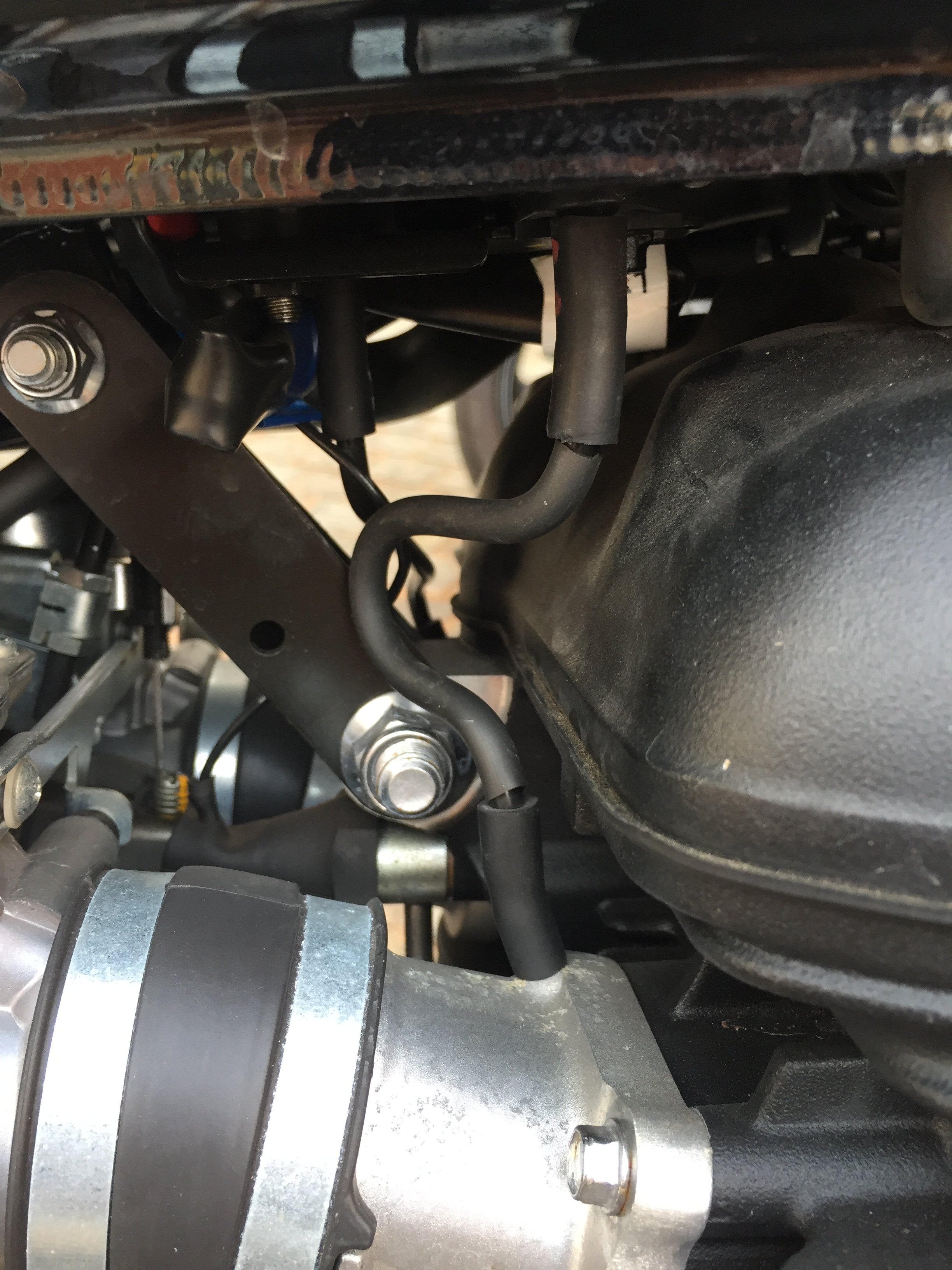

Hello Luca and welcome to the Triumph Asylum. As your bike is a 2011 it will be an EFi bike. With the EFI they have sensors called "MAP or Manifold Absolute Pressure" sensors. These work to measure the amount of negative pressure in the throttle body and are VITAL for the smooth running of your bike. There is a rubber/plastic pipe that goes between the throttle body of each faux carbureter and the actual MAP sensor above it. It is not at all unknown for this pipe/throttle connection to become compromised and allow part of the vacuum to escape. Examine these pipes and their connection points very carefully. With the engine running, spray some WD-40 in the area of the pipe/TB joint and listen to the engine. If the engine note changes you have a leak of vacuum. Now you have to find out where?????

Hi Luca in your first picture you show the MAP vacuum pipes. The leaks almost always occur where the short soft rubber piece meets the brass spigot on the TB (throttle body). Yours looks like it needs a bit of attention between the soft rubber bit and the harder plastic curved pipe.
I pushed them in as harder I could and checked everything you said. I have also performed the wd 40 trick but nothing change. I checked all the pipes and air box but I could find no leaks. The bike starts normally but the light is on. I will keep up with my research Thanks again for all the help

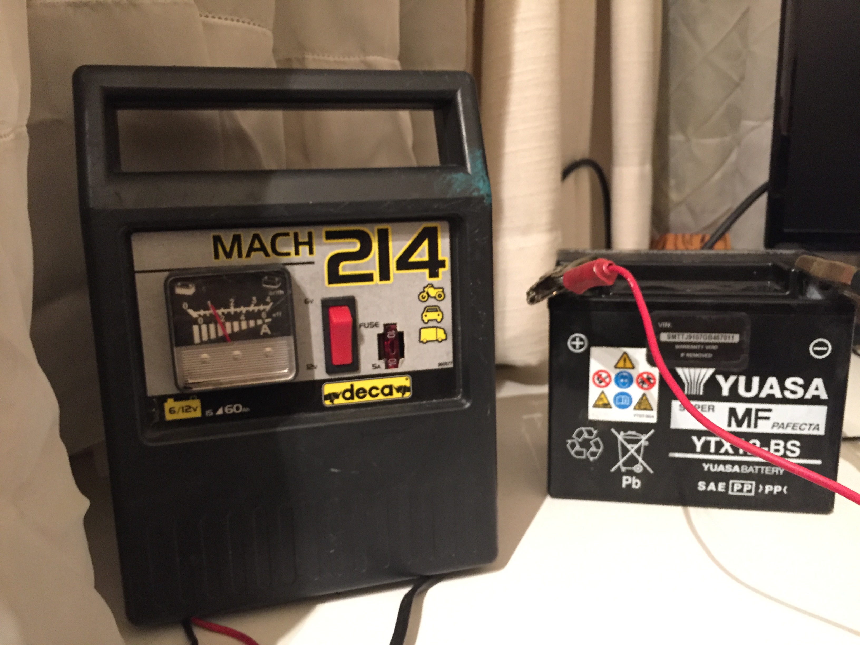

So just to keep you update, today i have just tried to start the bike and now the battery seemed to be dead although when I plugged it (as per pic) was not totally down. Anyhow I have also bought the ombd ll diagnosis machine which should be arrive on Tuesday to solve the mistery. To be continued....
