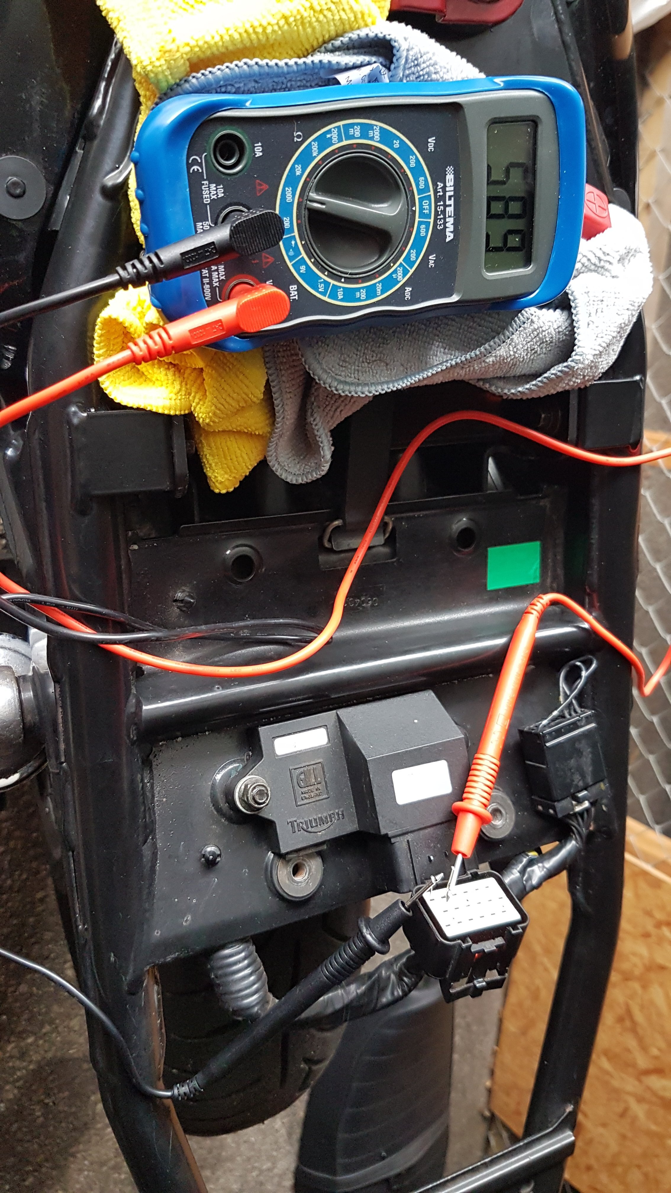

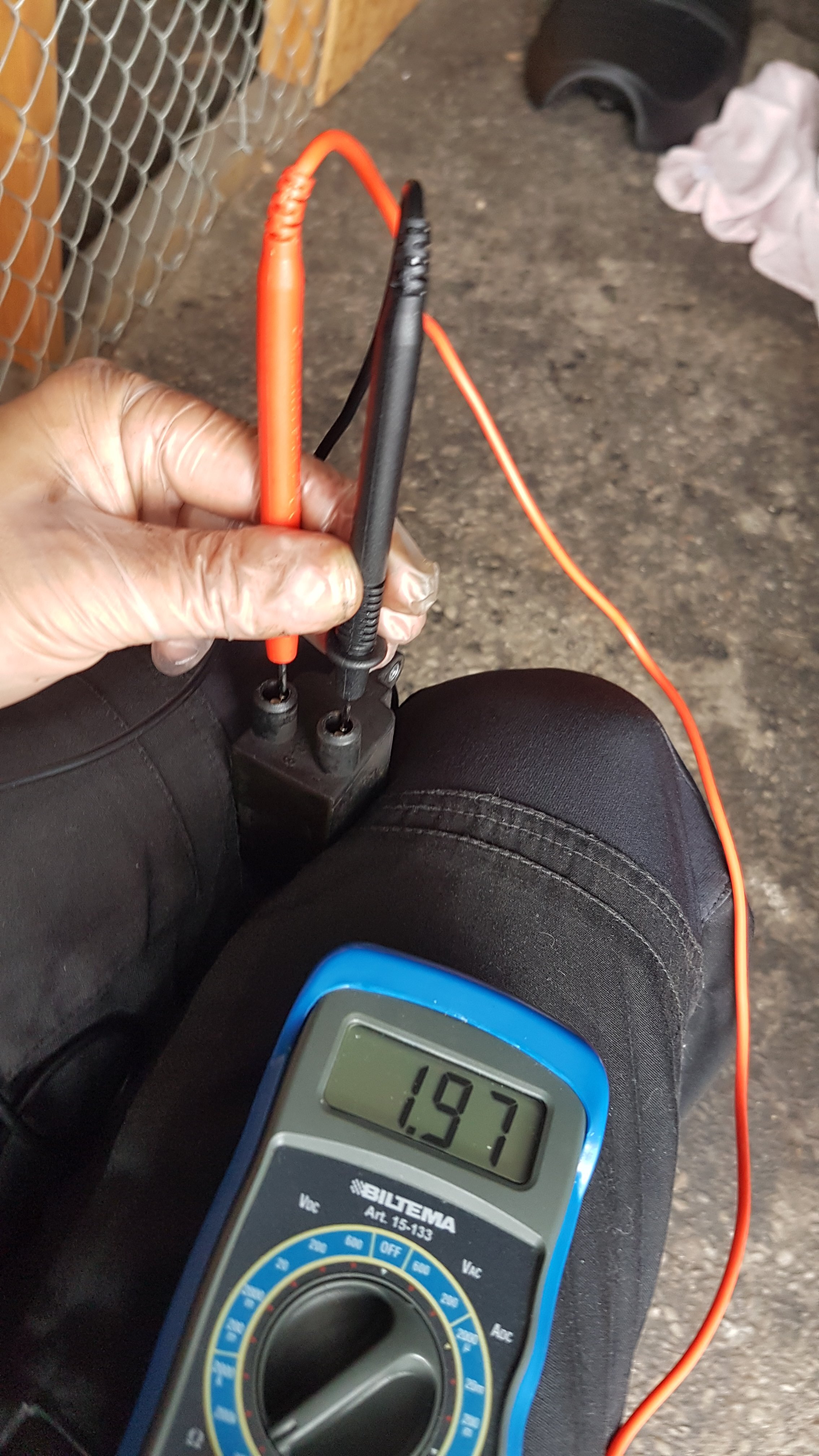

    I am on the right track you think and its not electrical?
