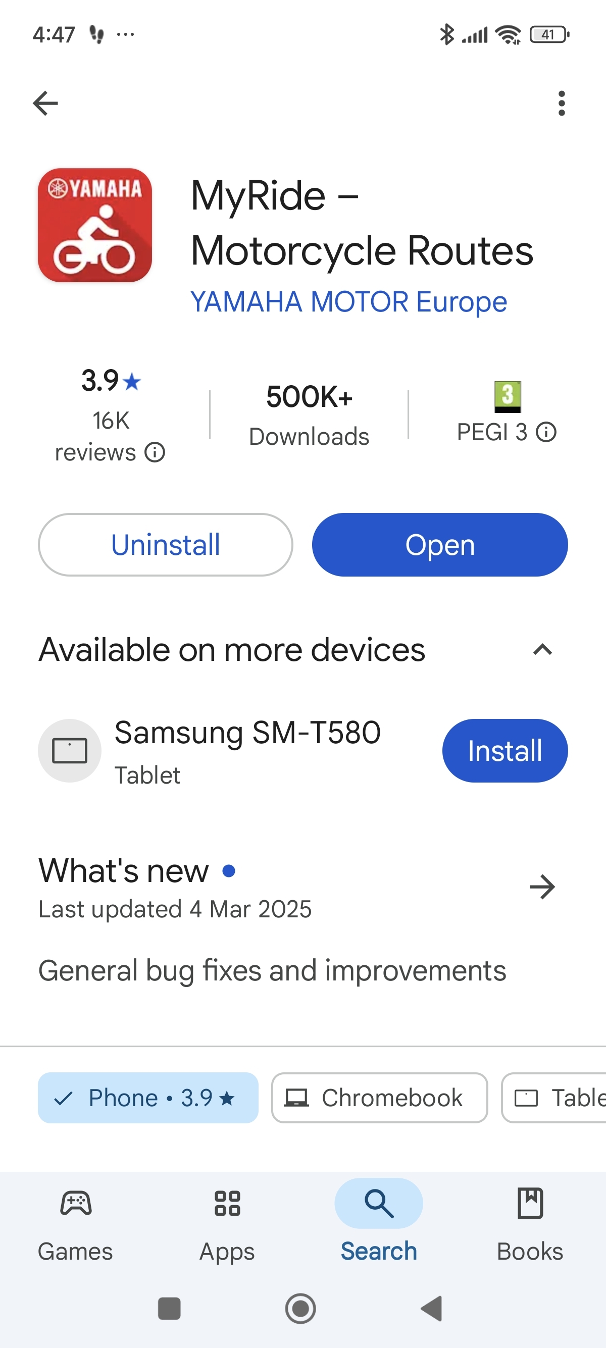

    When you say you're using the Yamaha app, do you get all of that info from your phone when you're not riding a Yamaha and linked to the bike?
  7. Paul Barton
    Paul Barton New Member
    Aug 31, 2024
    12
    UK the Welsh bit
    Screenshot_2025-03-30-17-15-21-938_com.yamaha.myride.jpg With the Yamaha app ( I think it's a rebrand of old pirelli app ) you add some info but any bike it's not linked to the bike. Just open the app and start ride. Put phone in your pocket or wherever and just ride. When you finish open the app select finished and it asks to name the ride and save.

  11. EllipticalAlex
    EllipticalAlex New Member
    Oct 6, 2024
    2
    Northamptonshire
    That looks good and some interesting stats too. Thanks I'll give it a go.

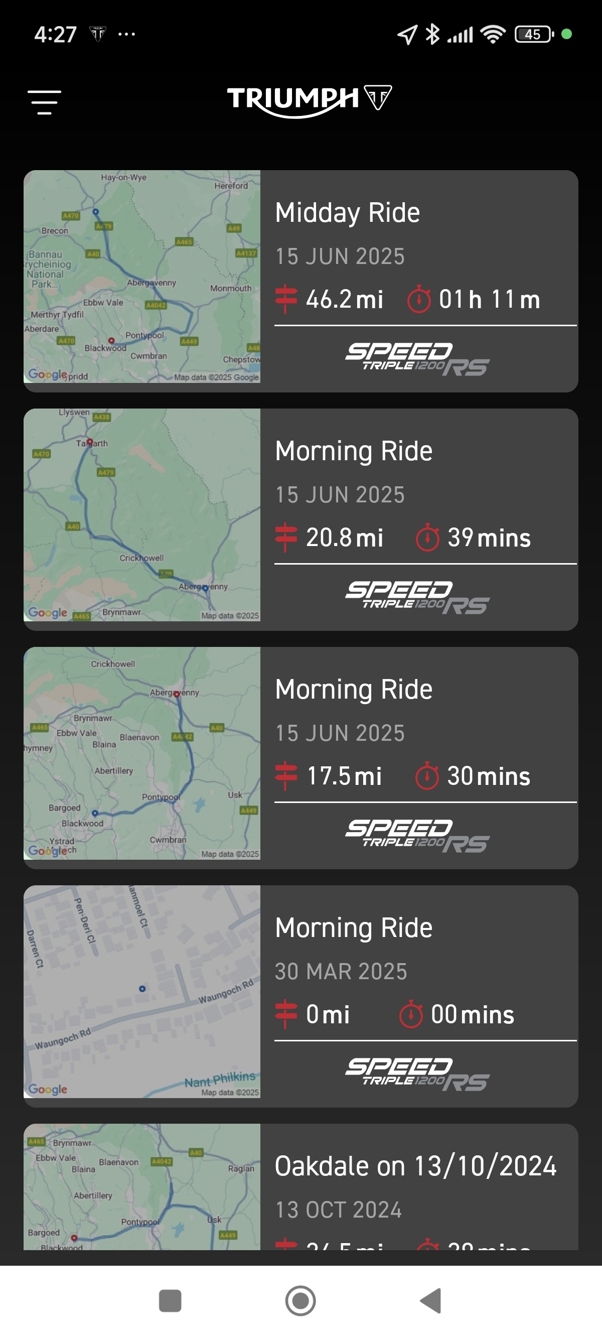

  12. Paul Barton
    Aug 31, 2024
    12
    UK the Welsh bit
    #13 Paul Barton, Jun 16, 2025
    Screenshot_2025-06-15-16-27-52-571_uk.co.triumphmotorcycles.mytriumph.jpg Ok got this to work.
    Ignition on and Bluetooth your phone.
    Open current ride.
    Free ride.
    Go ride.
    Once done. Turn of the engine but not the ignition. Leave the dash on.
    Open app save ride, name ride etc.
    Once the route shows in your phone turn ignition off
