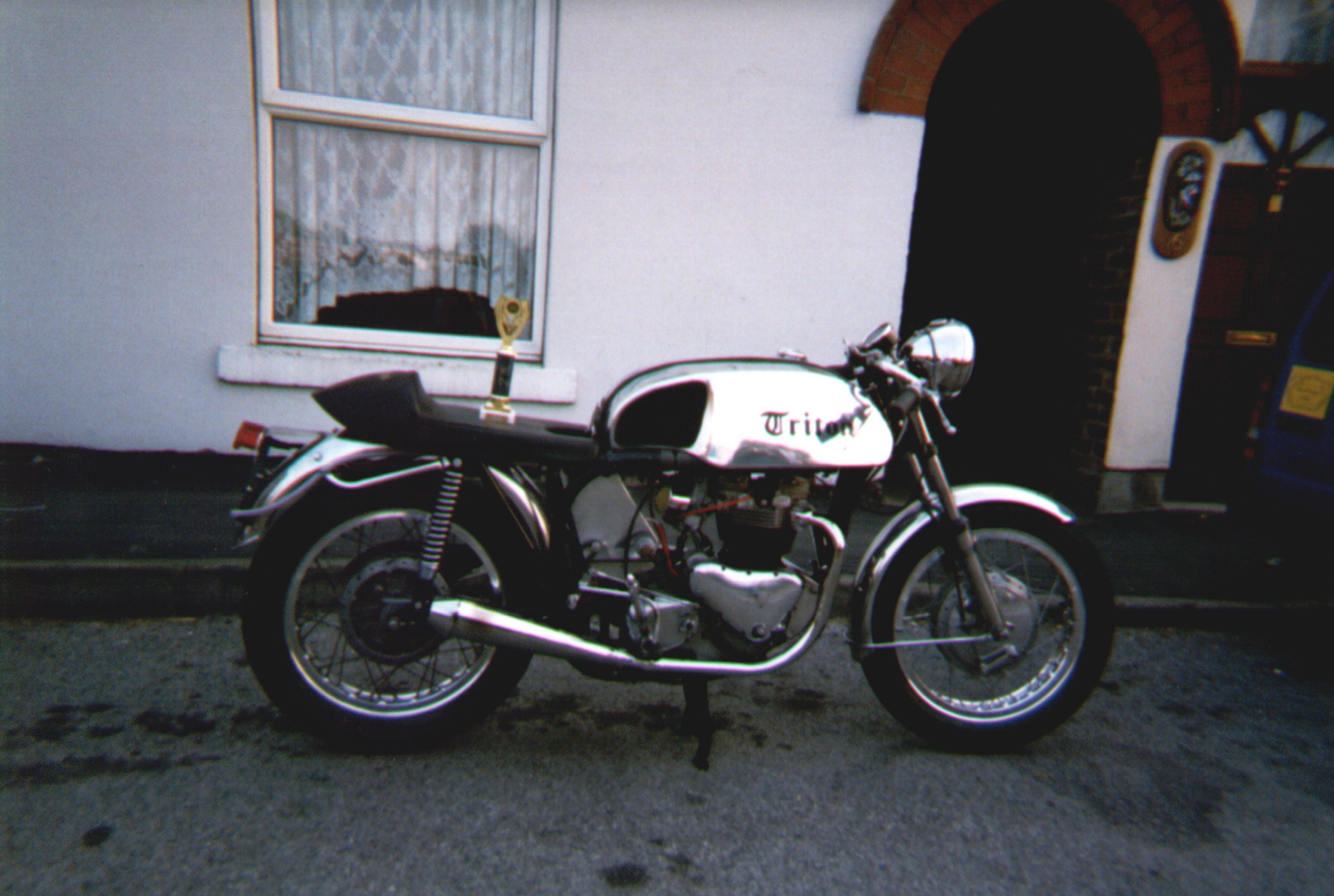

    My Triton (I got a right telling off from wife when I sold it!!)
    Pre Unit engine, featherbed frame, alloy rims etc etc, not quite as nice maybe as the other one, but I rode mine, a lot! Cup on seat 1st Prize at a Satan Slaves Show some years ago. Chap from Ride magazine judged mine the best on the day.
    You can see the difference in engines between Pre Unit and Unit, mine was a 1959 Tiger 110 engine tuned and modified to Bonnie spec if I remember right.
