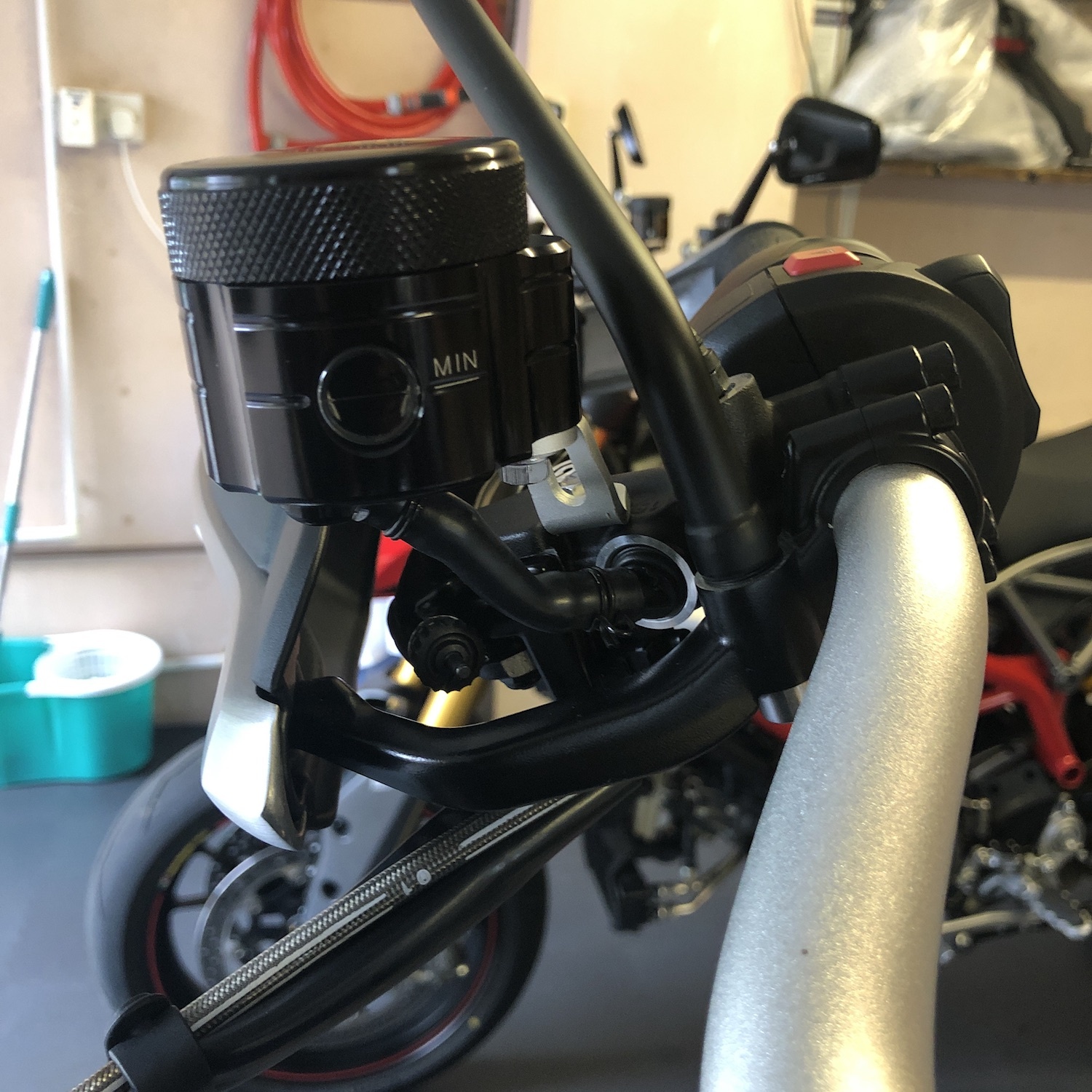

    In other news, I bought a CNC front brake reservoir from Total Triumph on eBay (click here) - half price at £40...although after a best offer attempt, we ended up at £39.90, saving an extra 10 pence :expressionless:.
    It's not listed as fitting the Scrambler 1200, but it fits on the standard bracket and will just need the hose cutting down to length so there's no kink. The latest kit (A9628057 which is now obsolete with no apparent replacement) includes a replacement bracket, but I just can't work out why. I'll post a photo once I've got it on the bike :)

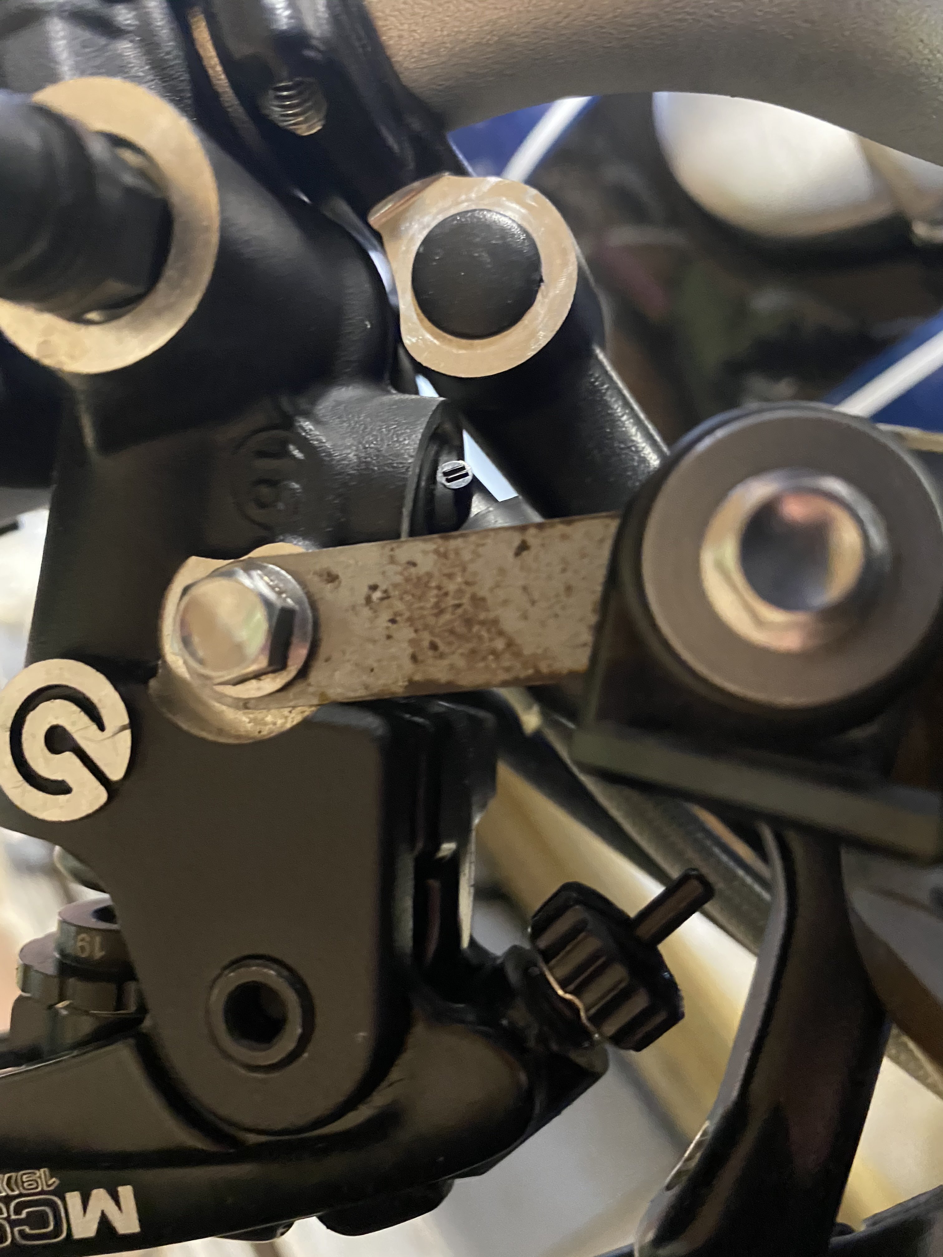

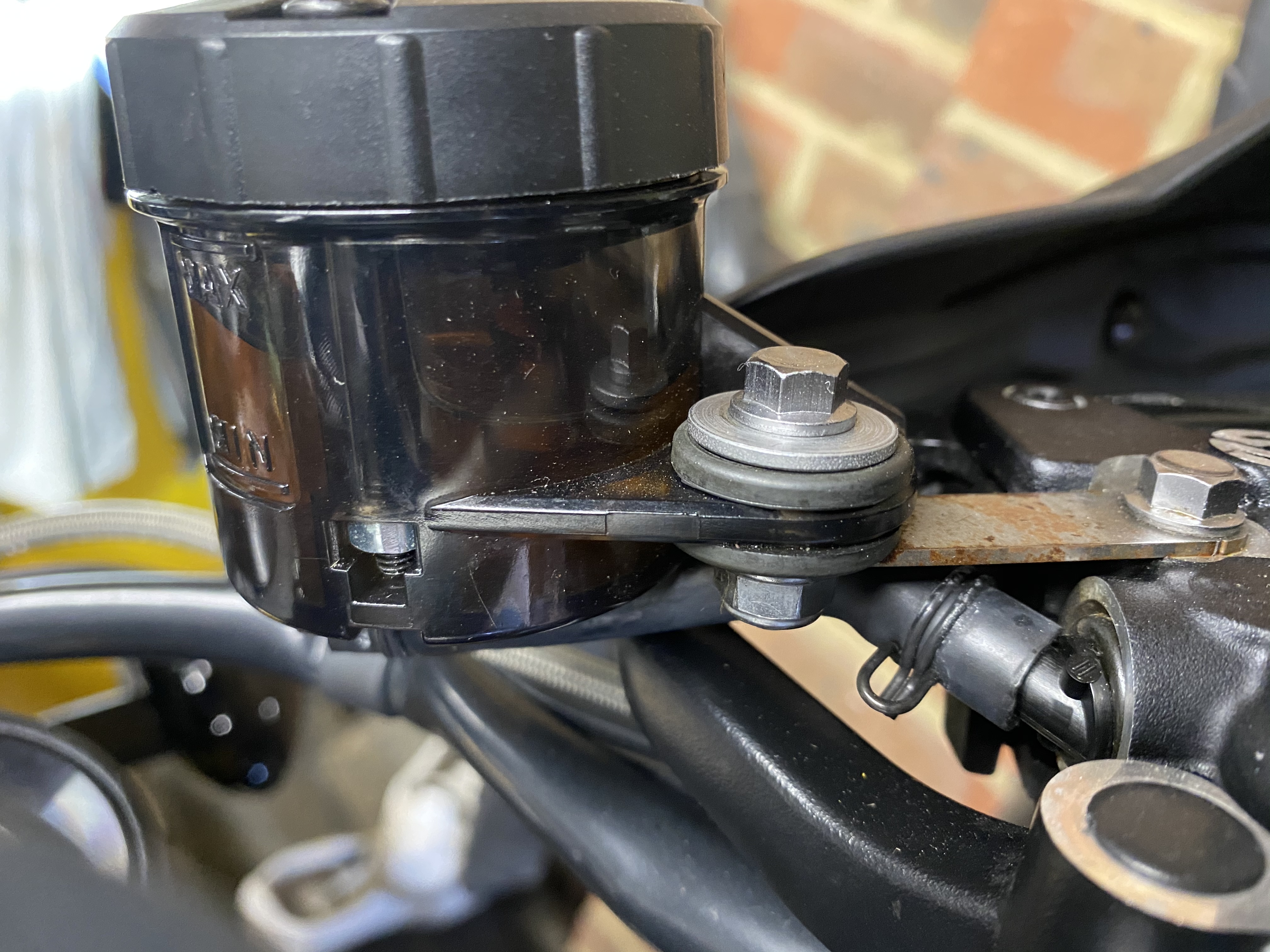

    my existing bracket has corrosion on it. i have seen seen different brackets on other bikes, maybe they have been upgraded on newer models?
    i will post a pic

    That's not an original bracket - I'm guessing that you're not the first owner?

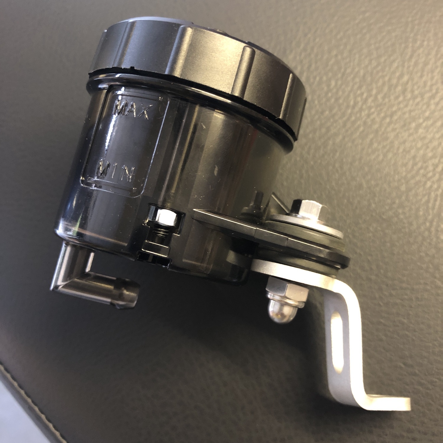

    I had a spare unused original bracket and reservoir off a 1200 XE - it looks like this:
    ...and here's the new reservoir on the original bracket, which needed bending to keep the hose (which I cut to 60mm) from kinking where it joins the master cylinder. The latest kit comes with a replacement bracket - but bending the original (remembering I have a spare I can put back) saved me £40 ;)

    No, i bought it used. I did think it looked liked it came out old tool box.
    i wonder what the reason is? is mine a original reservoir?

    just spoke to Craig at total Triumph and he said it is a shipping bracket to fit into a crate and should never left the show room like it. also said it will be affecting the braking as its below the cylinder

    Shipping bracket !? I was going to mention the height...that's very sloppy :pensive:

    just spoke to West Yorkshire Triumph and they are saying it’s not a crate part and the handle bar parts are already fitted. Says that some come with alloy bracket and some come with crap bit like mine.
    He’s raised a warranty claim for corrosion so not sure what it will be replaced with
    Update- After i emailed a photo of the official alloy part from the triumph parts catoluge, Yorkshire Triumph called back today and admitted it was in fact a crate part and are sending a new one out.
