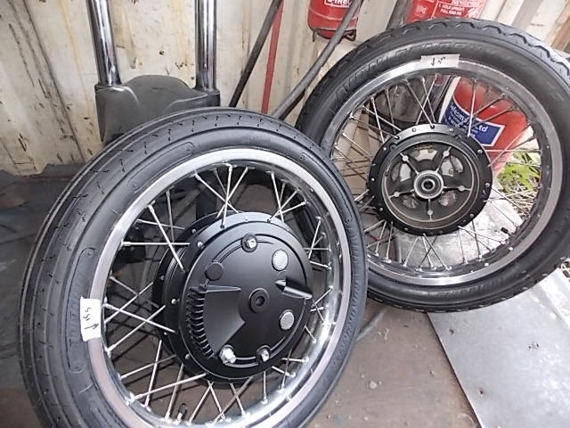

    Wheel progress today (said in Jonathan Ross voice) as I picked up a Tiger front this morning, the hub is narrower than Trident and the spindle smaller diameter but the Trident bearings, speedo drive and seals all fit meaning all that was needed to fit it was a couple of 9mm spacers either side machined and a new bearing spacer made up.
    Trident discs though are a smaller pcd so will be fitting Tiger discs when I get hold of them and I'm guessing the Trident calipers will have to be moved about 4mm in for everything to line up....fairly convinced there won't be any clearance issues though....
    Oh, and tyre in pic is just a rolling around workshop one....eventually to be replaced....even I draw the line at riding something fitted with a 25 year old speedmaster!!!
