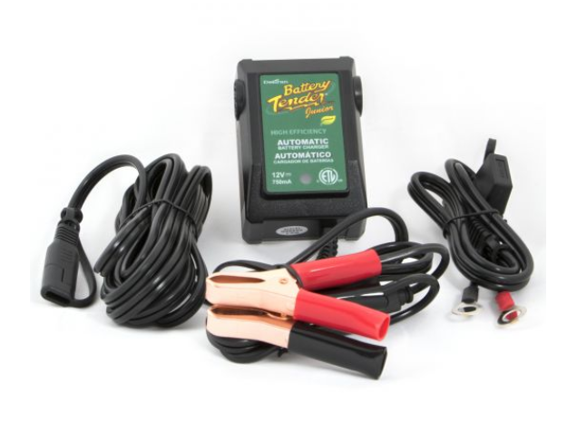

    Welcome from smoky Calif. I use a Battery Tender Jr. Used it for years. My batteries have always lasted for many years with no issues.
