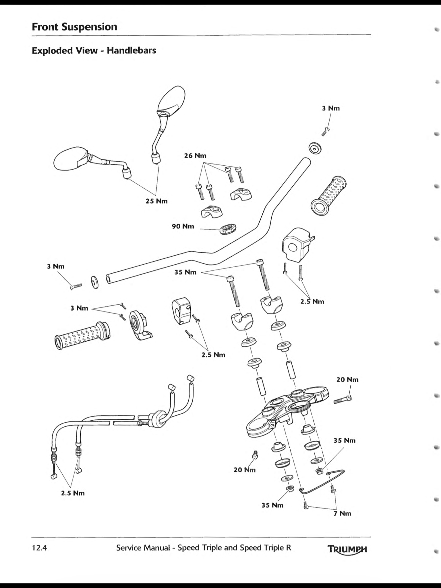

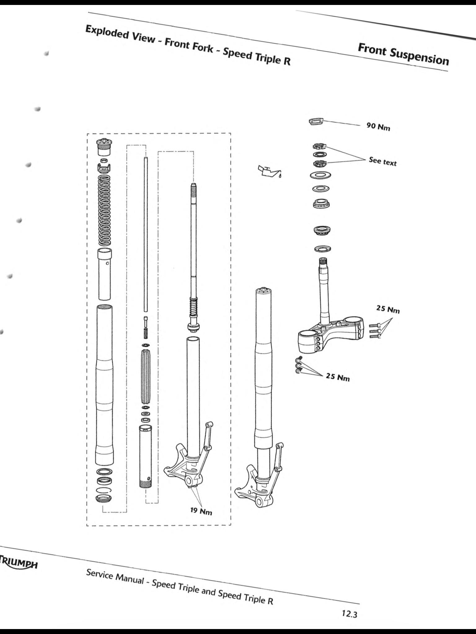

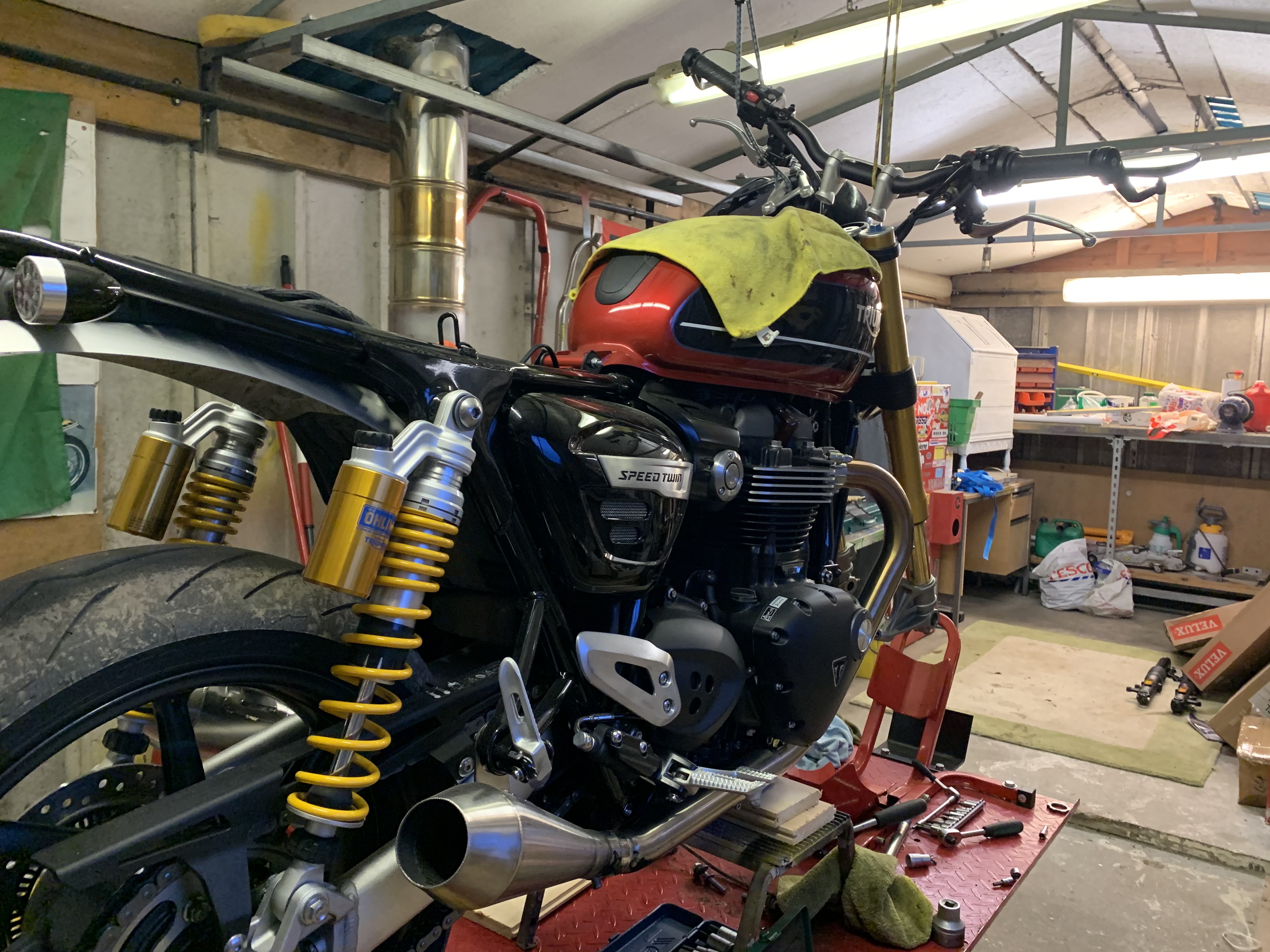

    I have got a 2016 Triple R front end Ohlin's, is there anywhere or can any advise the torque setting for the lower and top yoke, as i am putting them on my 2019 Speed Twin

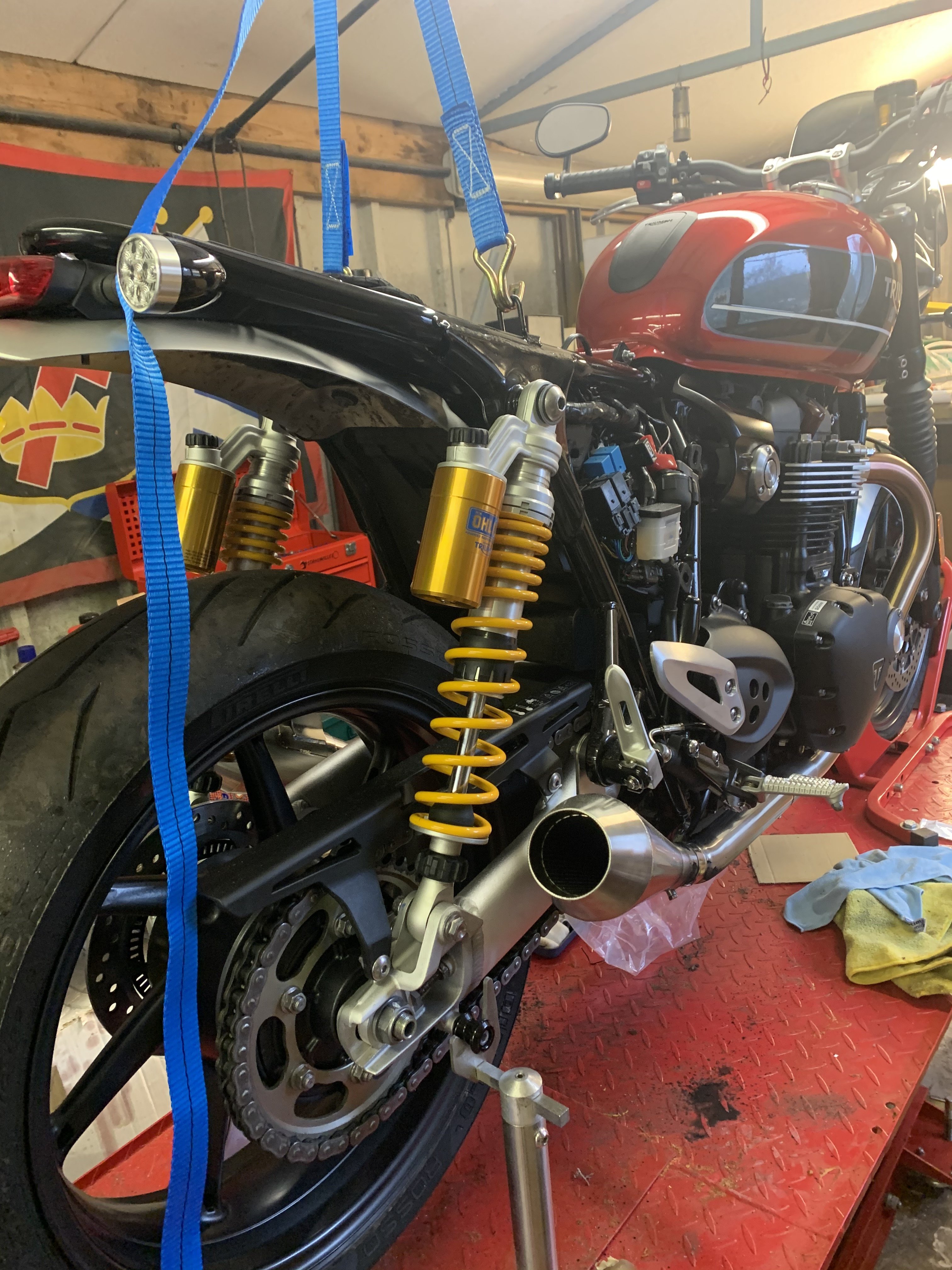

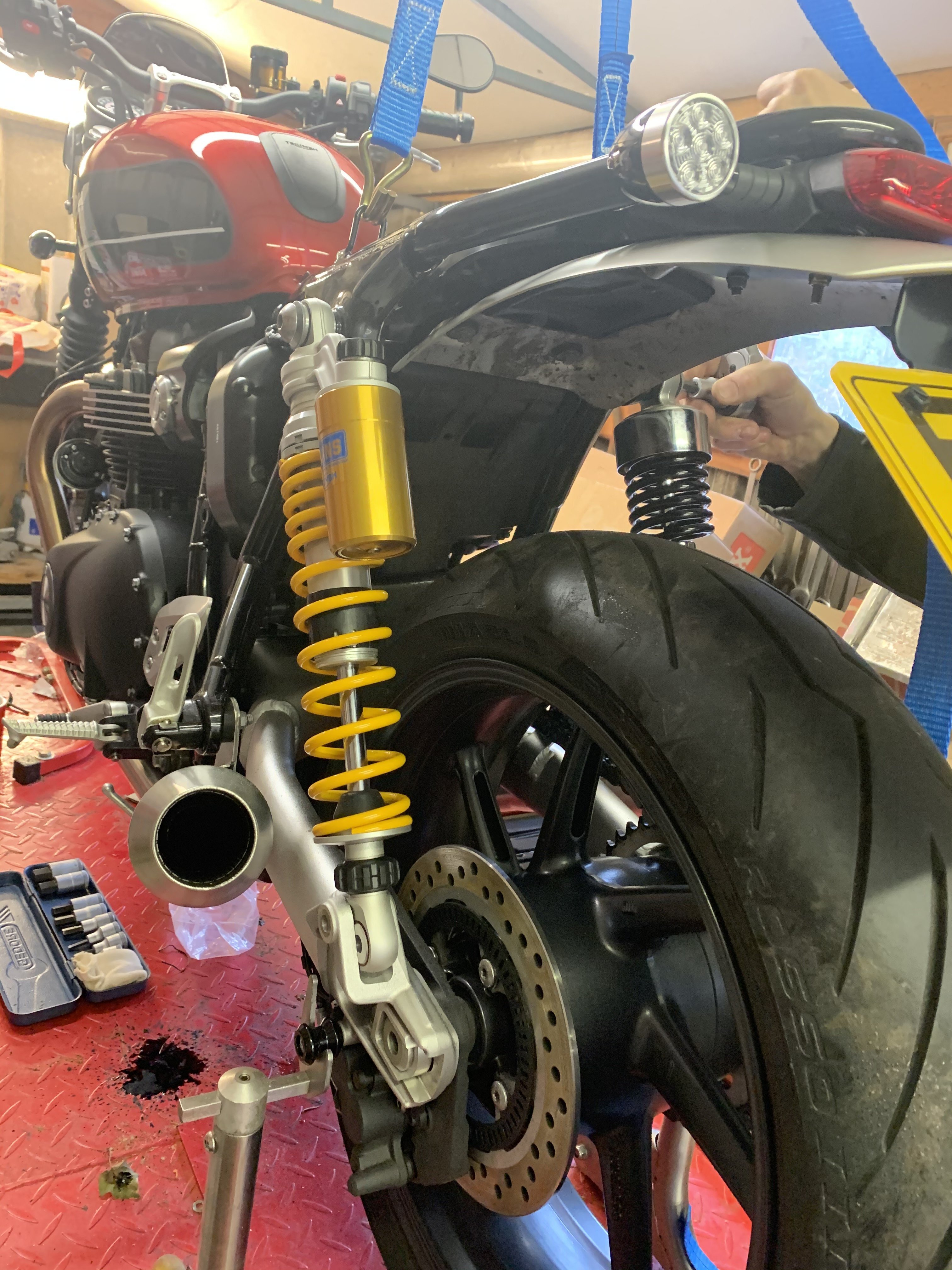

    To go with these bad boys i have fitted to the rear

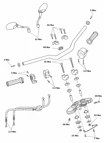

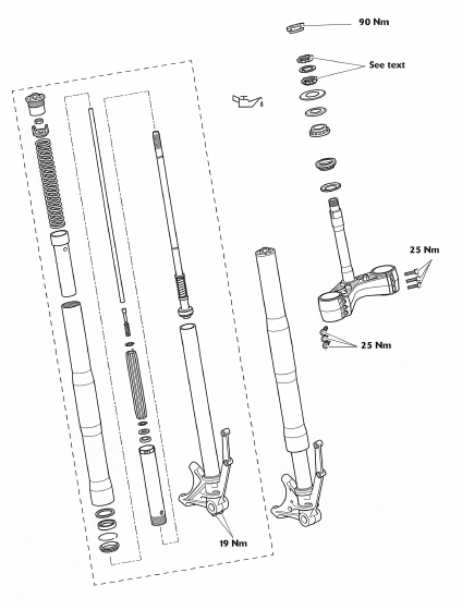

    This is for my Speed 94R (which is a 2016), hope it helps. Good luck with the project.
  5. Col_C
    Col_C I can't re...Member
    Aug 5, 2015
    1,435
    Be especially careful with the lower axle clamp screws (19Nm), there have been reports of lower casting cracking if overtightened on Ohlin forks (mainly on Ducati forum). Beware of unqualified tyre fitters.

    thank you for the diagrams showing the torque values, i have come across a bit of an issue with the speed twin ignition barrel, i may have to go my local dealer to have what look like 2 x security fittings and re fitted into the Triple "R" Ohlin's top yoke.

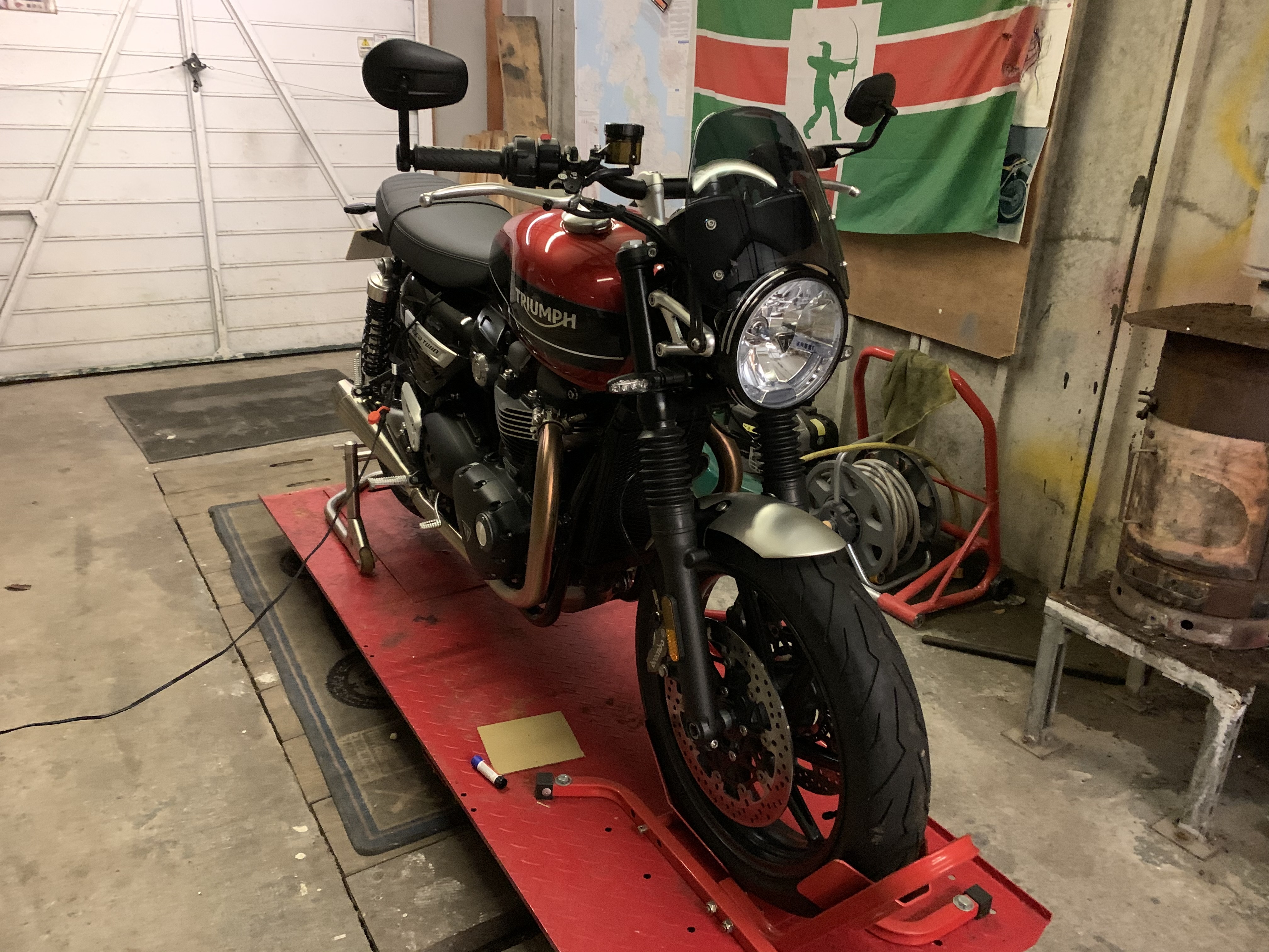

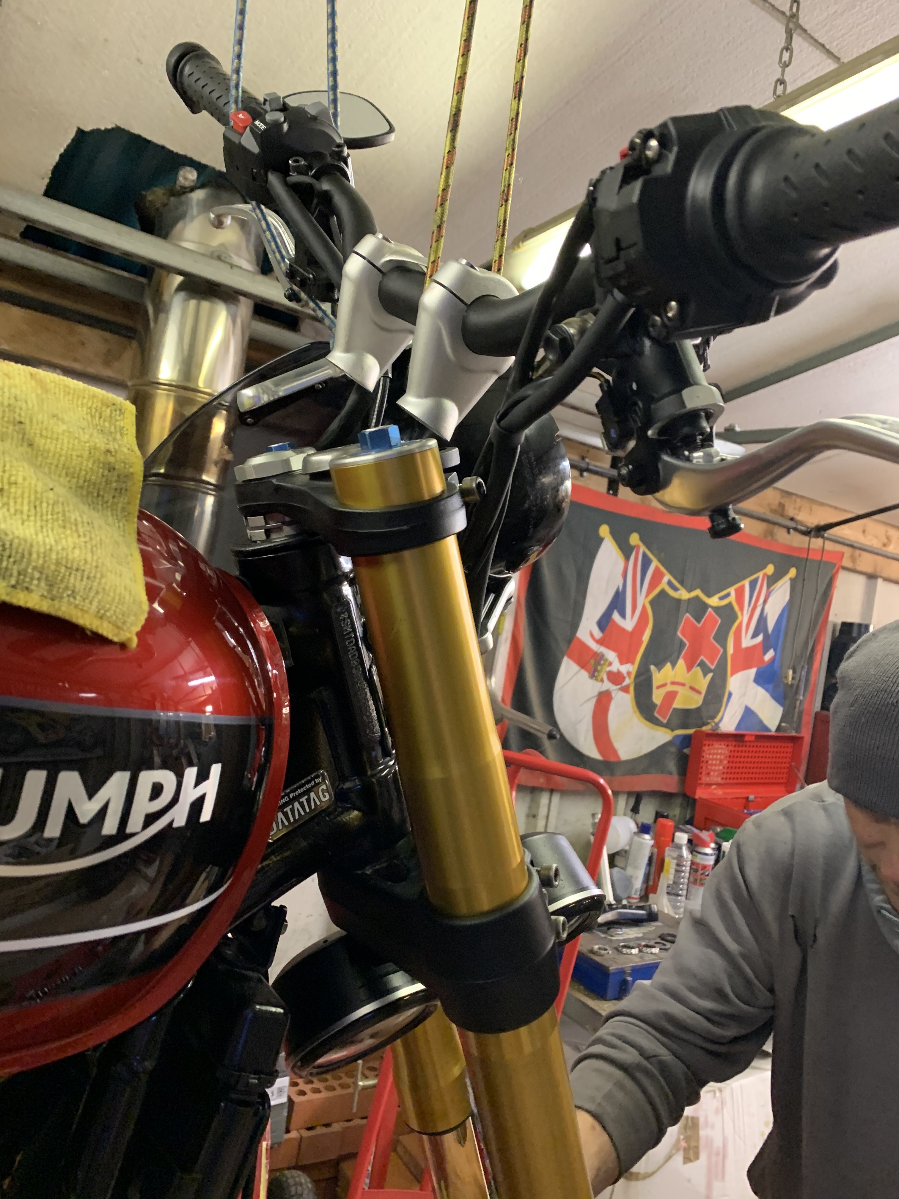

    After a busy afternoon, we have rough fitted the front end set up of a Ohlin's shod 94R Triple "R" , all that was required was a 2mm shim for the top of the stem, the abs connection is the same that was my main concern, i have attached a few photos more next weekend hopefully showing the final set up

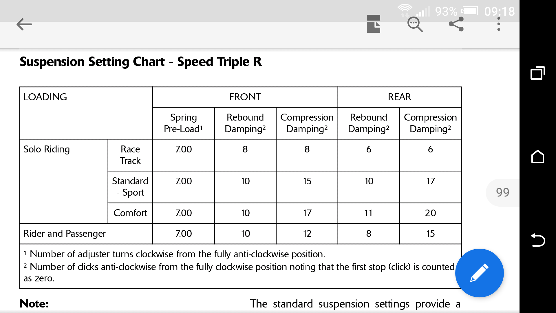

    thank you for the torque specs, would anyone have the standard settings for the Ohlin's front forks for the 2016 (94R) Triple R

    I'd say start with the comfort settings. :)

    Thanks Col, comfort setting are be going to be set, and go from there.
