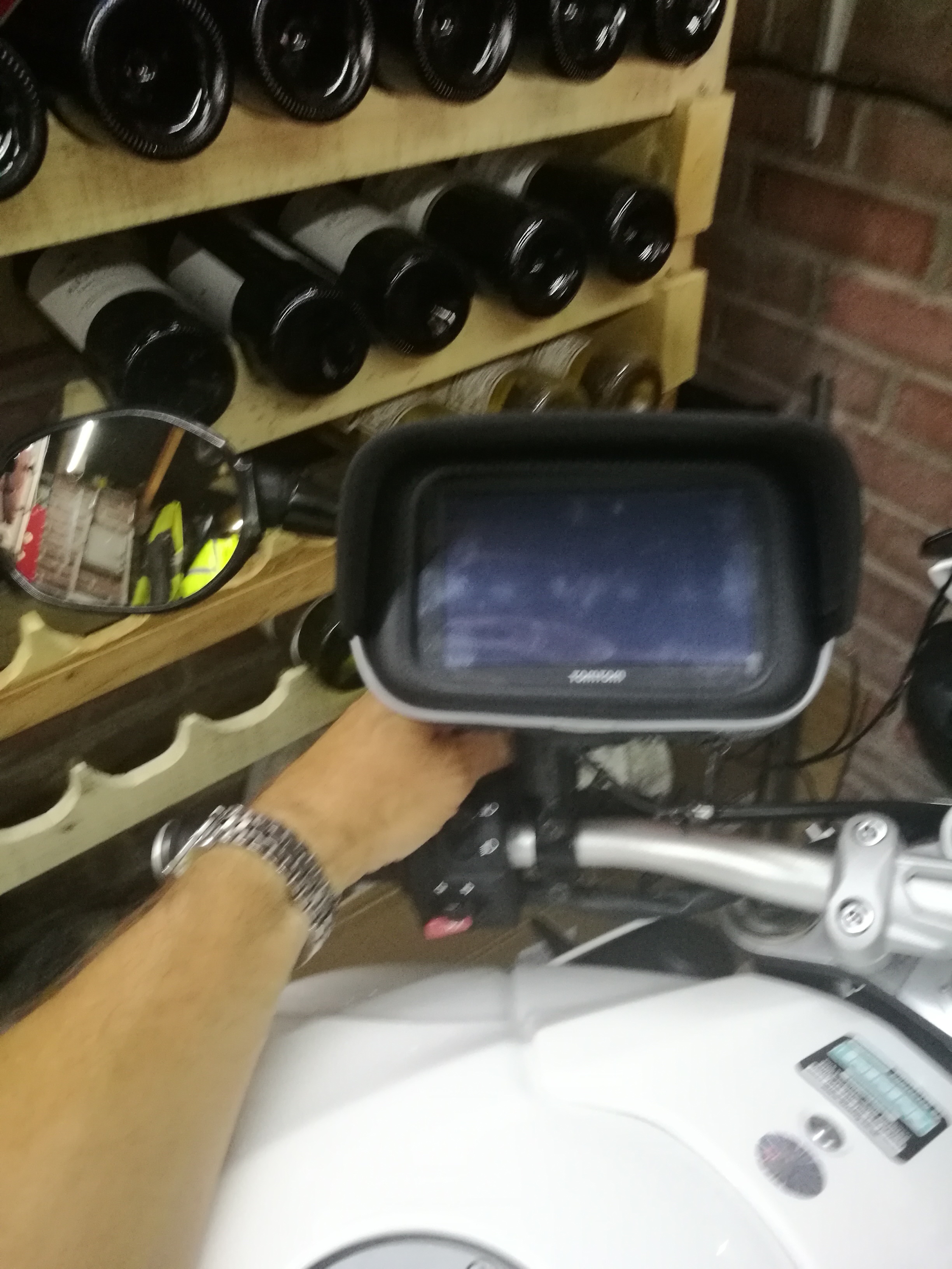

    I think the set up in regards to handlebars is quite similar to a VFR and I mounted my Tom Tom on the left fork top yolk removing the original bolt and using a longer one in its place. Make sure everything is clear as you turn from lock to lock and the instruments should still be visible.

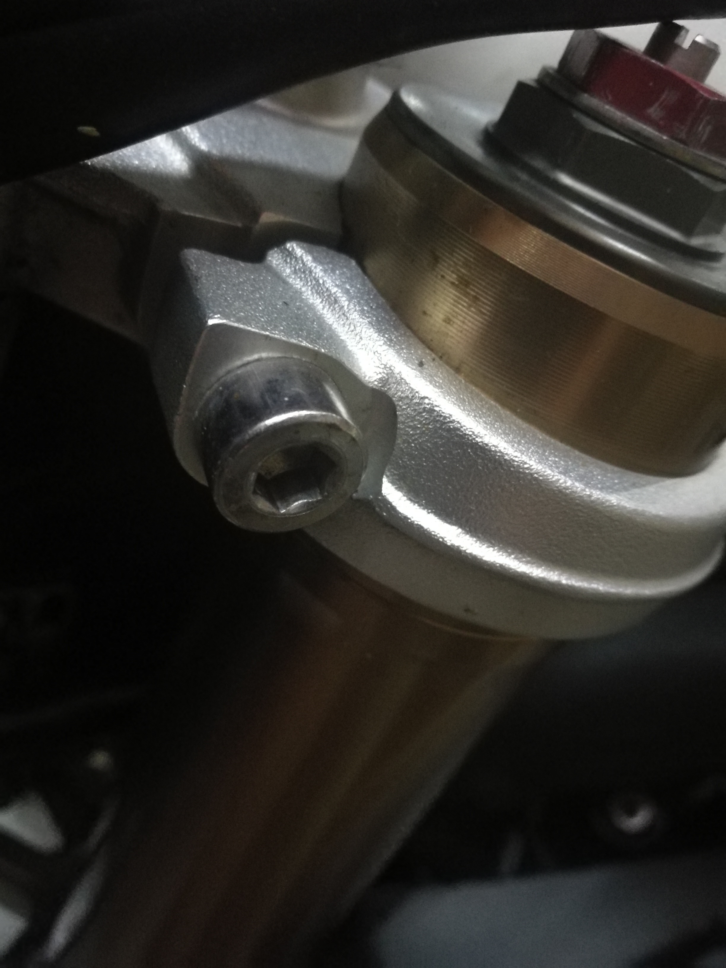

    I was meaning the yolk clamp bolt not the adjuster, do you want me to post a pic of the one I mean?

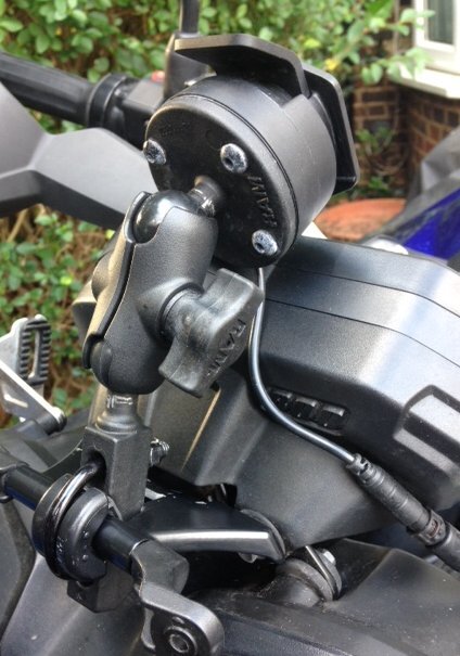

    This is how I mounted mine on the speed triple using the clutch lever bolt
    Alternatively this is the bolt on the top yolk I was referring to
    It depends on what type of ram mount you have but these are a couple of options.

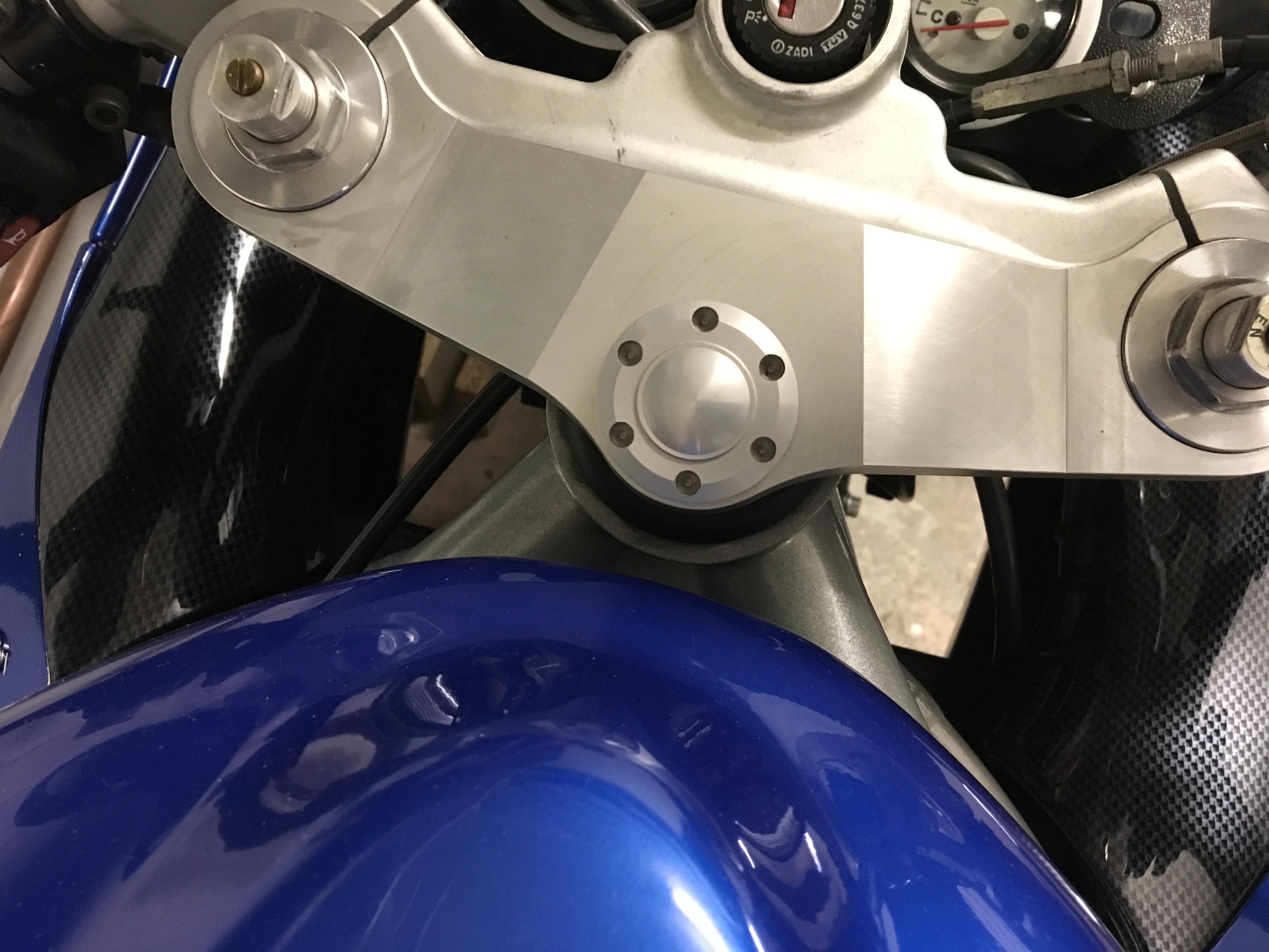

    There’s a guy who does mounts for the top yoke nut. Basically just drill and tap it then screw in a Ram ball. http://www.telferizer.com/
    I bought a spare nut to do it myself but have never got around to it. :rolleyes:

    What year is yours? I think up to 2001 they were all the same, like mine below.

    Mine is the 2001/02 DSSA model - your nut looks the same, 42mm diameter. Will have a look at that website
