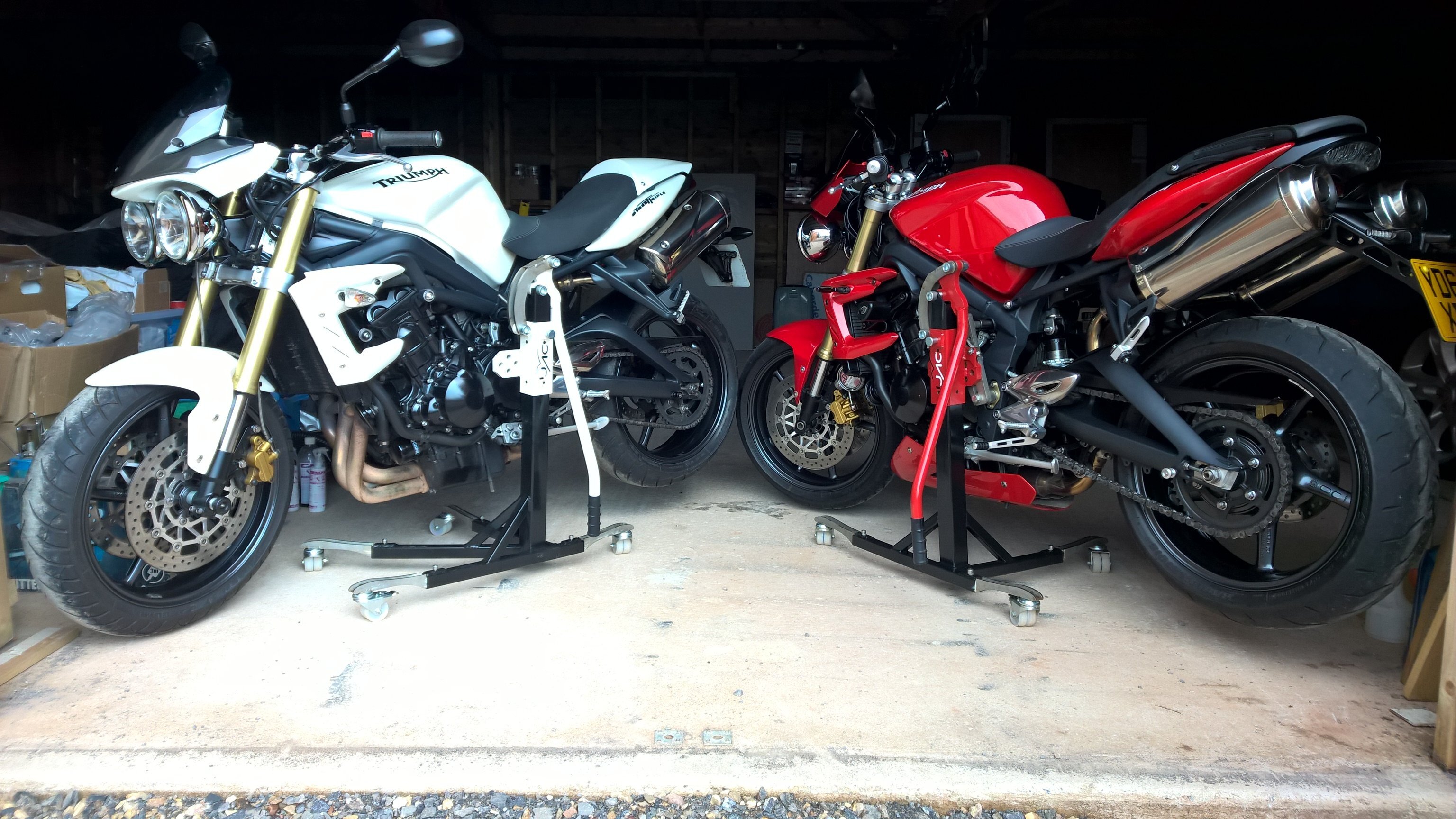

I should also mention that my better half passed her in 2020 and spent a year on my Triple as her first bike. She absolutely loved it.
