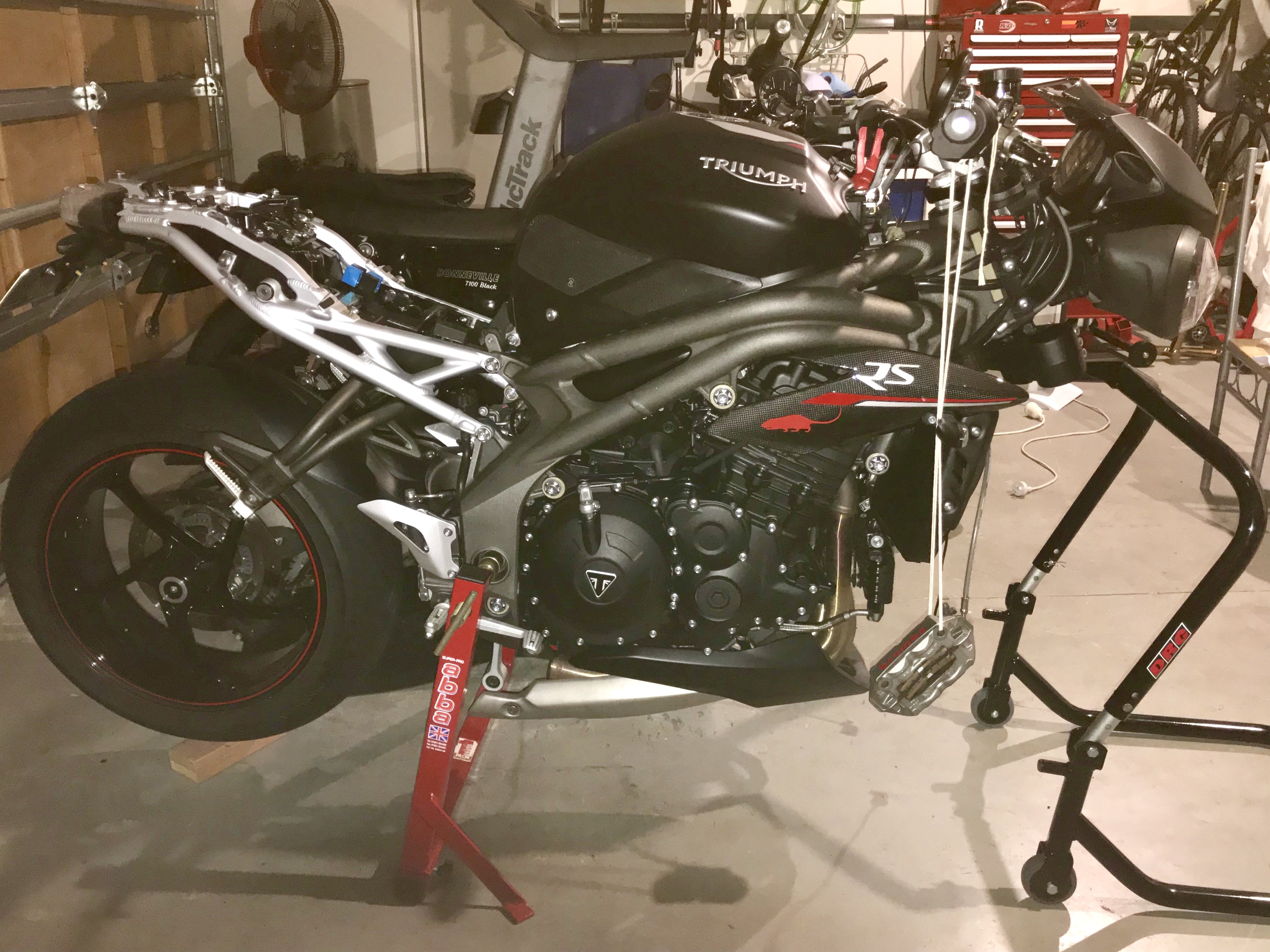

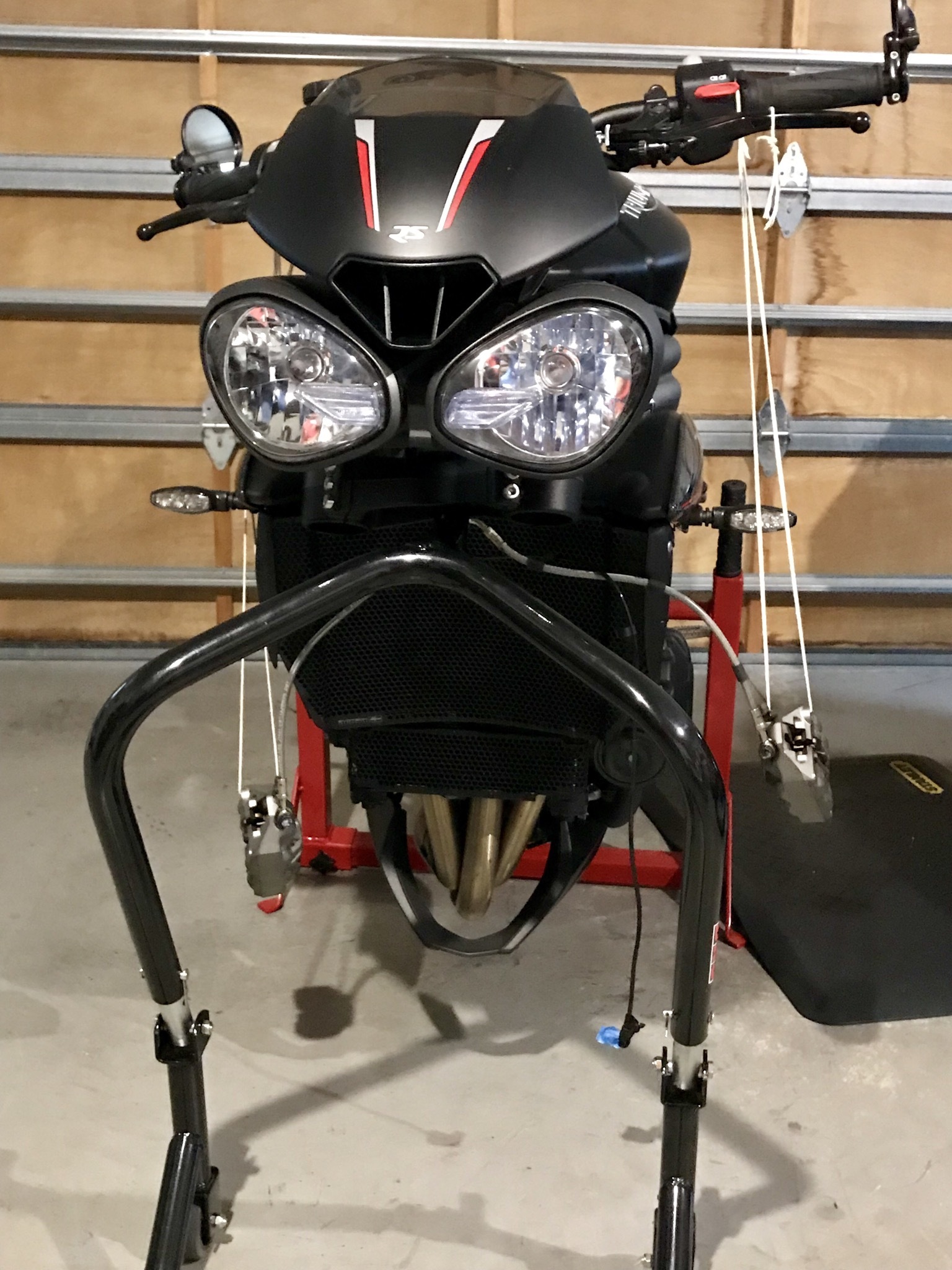

    I’m only 71kg or 155lbs so the Speedie feels like a bit of a brute over the bumpy roads we have in NZ, even on so called comfort settings I’m regularly out of the seat. Finally getting round to doing something about it, so today I dropped the forks and shock out for respring and revalve: will report back when the work is done

  7. Simon P
    Simon P Well-Known Member
    Dec 19, 2018
    35
