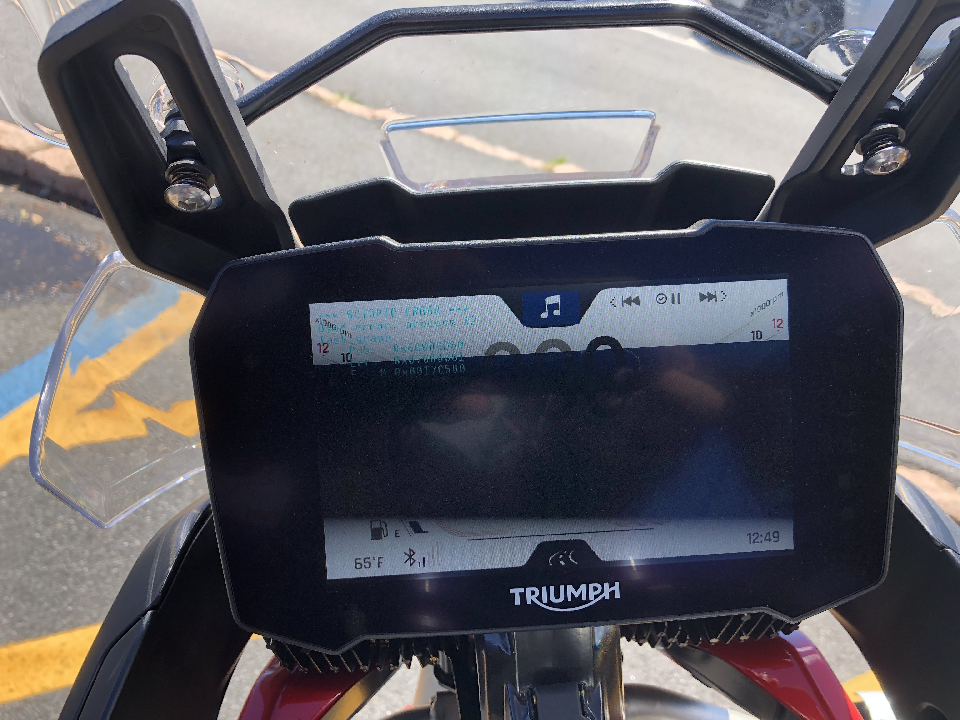

    I got a 900 Tiger GT Pro love the looks and bike so far but did have a scare just this past week while drive around Bar Harbor Maine.
    So just had the first service done at 500 mile which included a software update.
    Two days after the update while riding on vacation the dashboard/Screen went crazy after a short stop and restart. Screen started scrolling Hexadecimal numbers error codes. I stopped and turn the bike off. But the screen stayed on and in fact the bike would not restart.So I disconnected battery and thus power.
    Wait about 30 sec reconnected power and screen return to normal except for the check engine light and wrench appears. The bike ran fine and the screen operated correctly. The check engine light went out but the service wrench is still present. Will be calling dealer to see what is up and will let you know

  11. Jim Connor
    Jim Connor New Member
    Aug 31, 2020
    Massachusetts
    here is pic of the screen
    • WTF WTF x 1
  12. Jim Connor
    Aug 31, 2020
    Massachusetts
    the black area was actually flashing data and showed all screens data overlay
    • WTF WTF x 2

    Hello mate! I had exactly same problem from indicators.... my dealer fixed it with a firmware update for the main computer.

    I have not had an issue since and screen working fine but finally going to dealer today to get wrench reset and too see what they have to say concerning this
