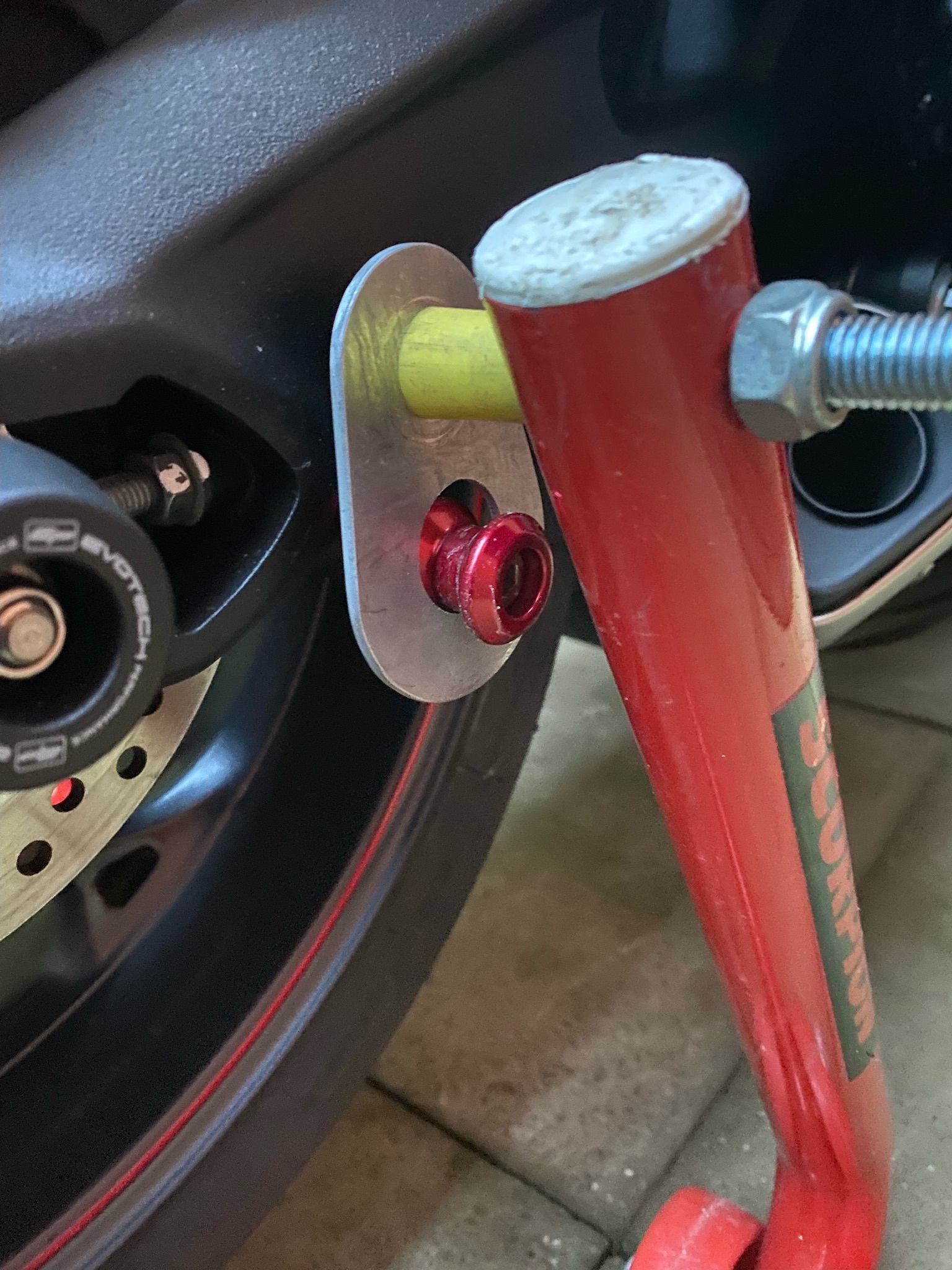

    You say you already have paddock stands. If the rear ones are the type that cradle under the swing arm on both sides you can probably adapt them.
    I have one of the above type stands for use on my Ducati. A bit of a pain to fit, too far forward and they rub on the cans and too far back and they clash with the sprocket nuts.
    Anyway having bought myself a new Street Triple R to which I fitted the rear bobbins I set about modifying the stands to use on the new machine.
    The original swing arm cradles are on the end of a M12 bolt that goes through the stand upright. These were replaced with a plain zinc plated M12 bolt of suitable length onto which I fitted an 3mm ally plate with two holes. One for the M12 and one just large enough for the bobbin to go through.
    The heads of the bolts were uncomfortably close to the swing arms so I ground the heads down to about a third of original thickness and made a cap using my hot glue gun. This I did by holding the ally plate horizontally smearing the surface lightly with grease, cutting a 12mm length of 22mm copper pipe, grease the inside and making sure there are no internal burs on the cuts. Slide the bolt into the ally plate and put the copper ring around the bolt head and filled it flush with hot glue.
    To keep the ally plates and bolts from sliding back through the stand upright I circumcised my garden hosepipe to provide some flexible spacers. In hindsight I could have put the two holes closer together to give more lift but haven’t found it wanting, yet.
    So I have now bought another pair of bobbins and am working on fitting them to the Duke, in a non destructive way.
    Further words fail me so see photos and hopefully all will become clear.
